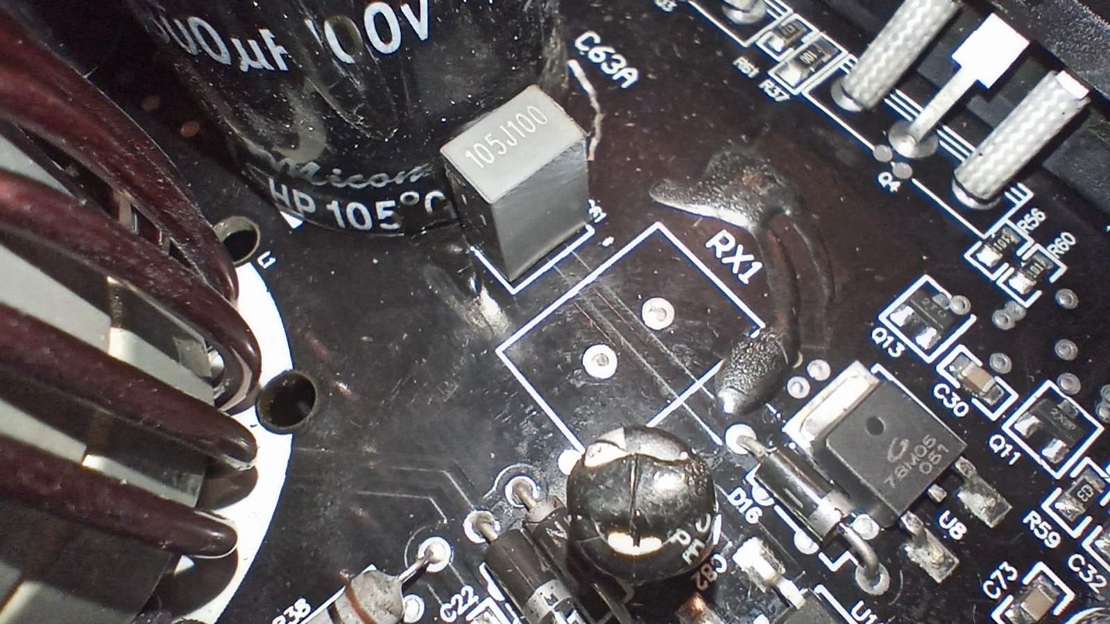

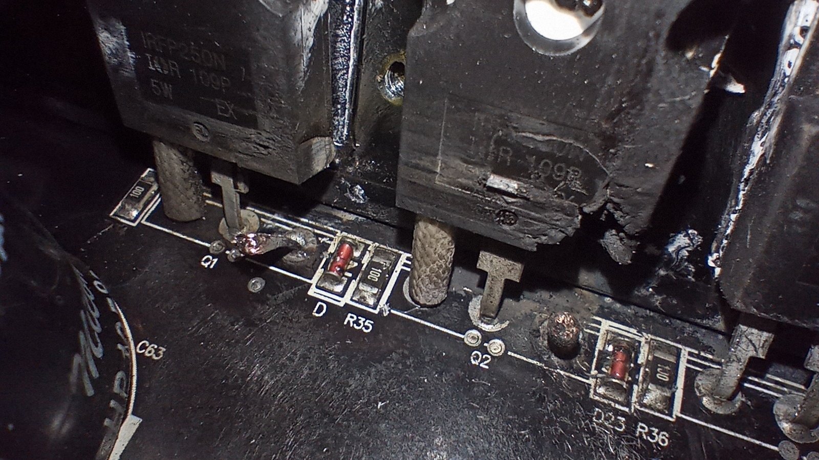

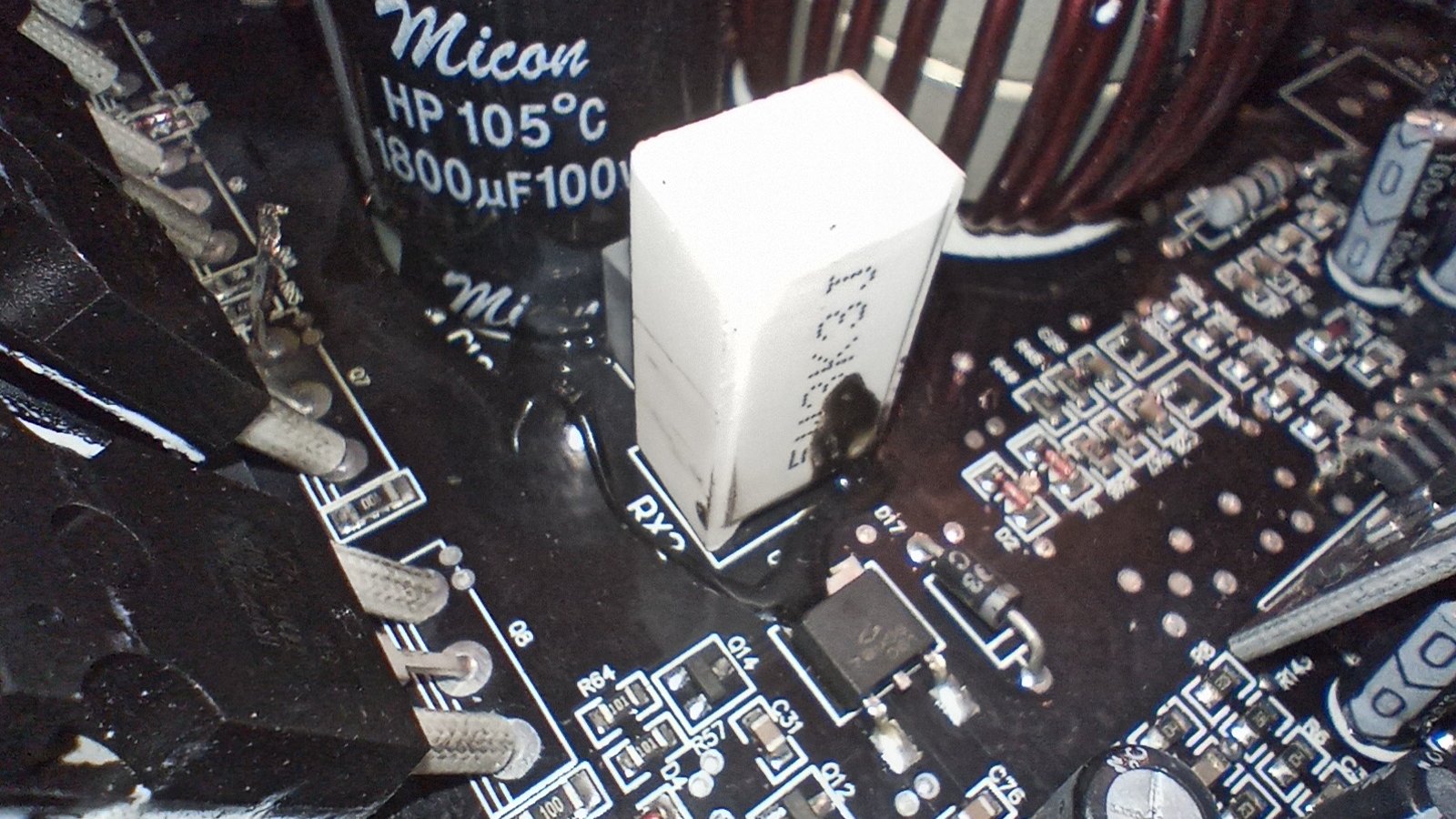

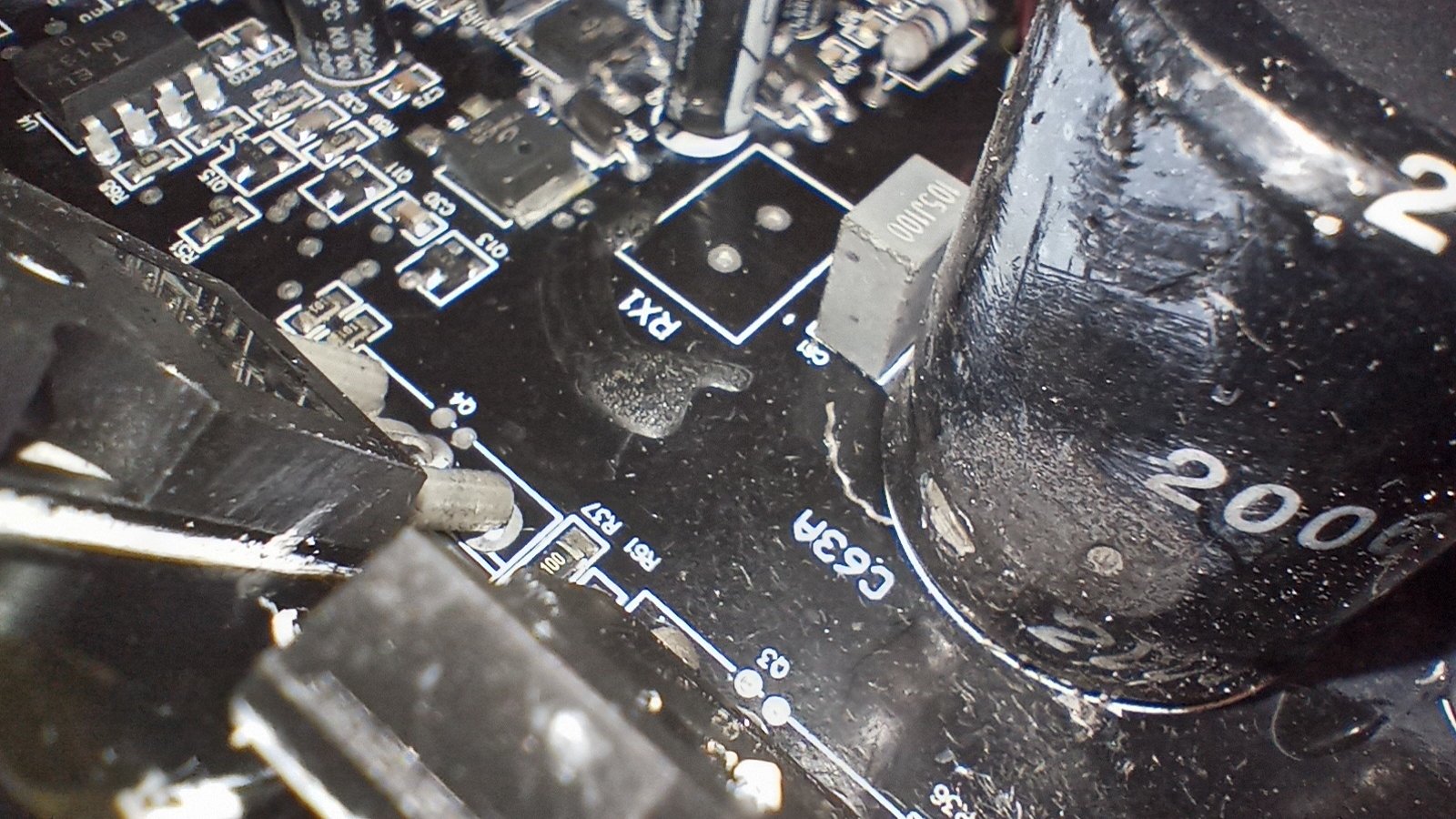

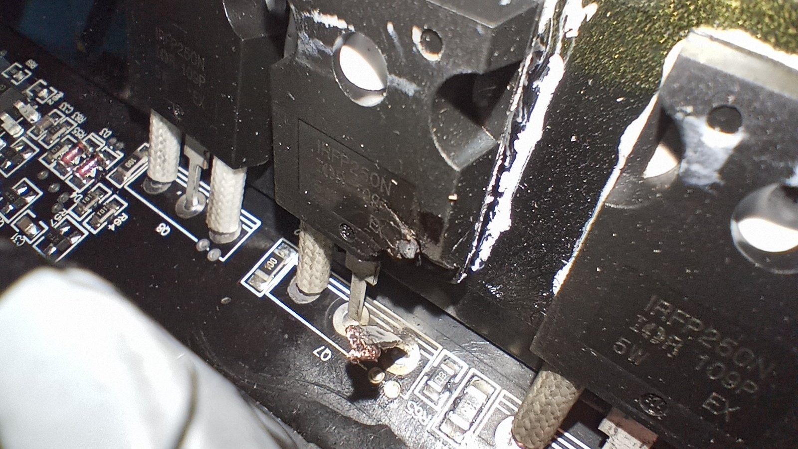

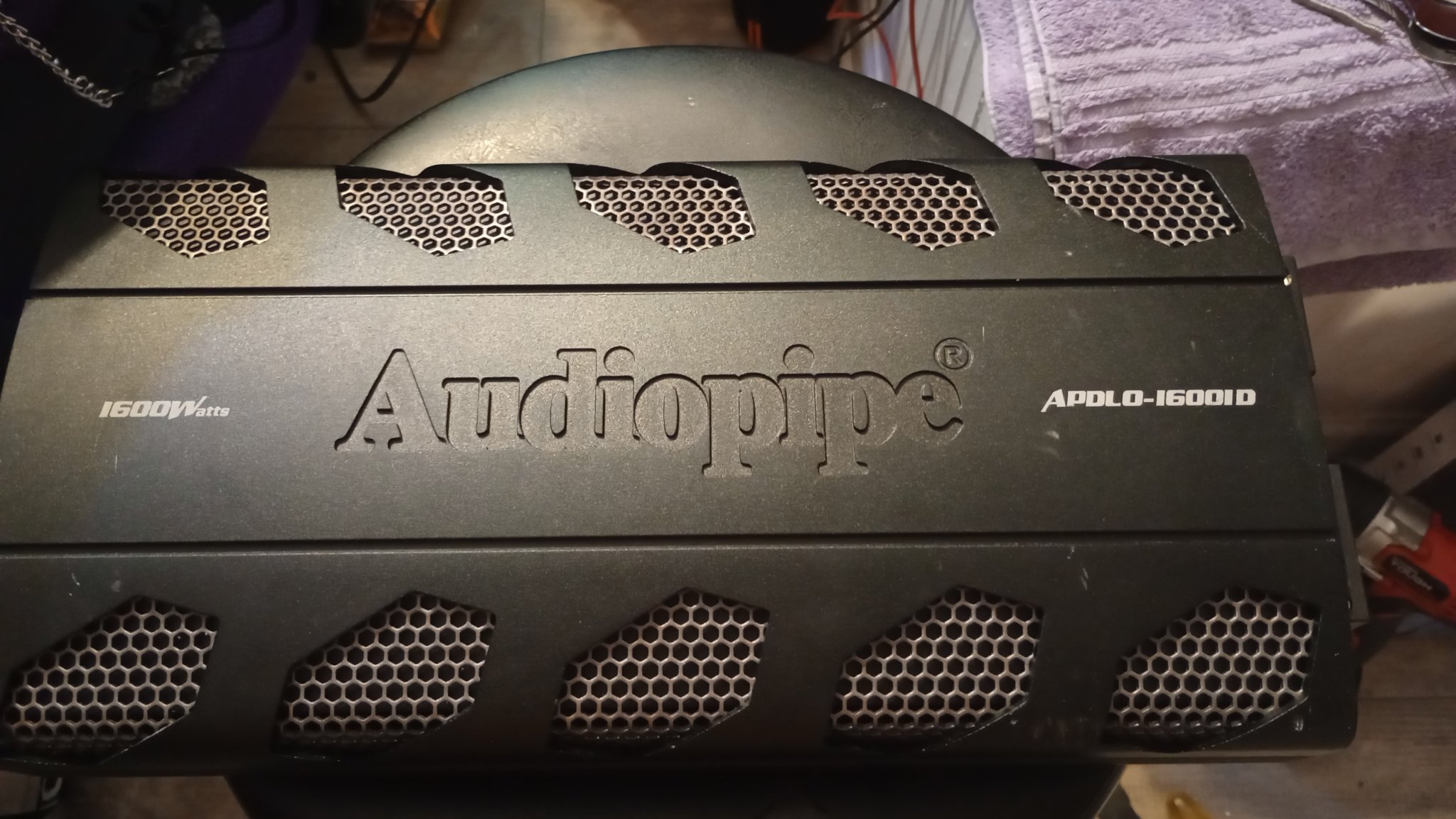

For starters I have an Audiopipe APDLO-16001D which is a dealer line series amp that can only be bought at brick and mortar stores of which there are only 3 of on the east Coast two in Florida and one in Connecticut. I live in NC right in the middle of them. I got lucky and bought it new in box from a guy local to me for $80 (so cheap I felt bad and tried to offer him $100 😂) as of right now replacing it is out of the question (with any amp at the moment for cost reasons) because of cost and distance, I am handy with electrical circuits and soldering so I would like to attempt to repair it myself with either new parts or parts salvageable from other amplifiers/electronics. So burnt up 3 of what Im pretty sure are mossfets, and one of the capacitors, that I can visibly see atleast. I called Audiopipe tech support and found out that it was likely from connecting the subwoofer with the amp already powered up. Something I had never had an issue with before or heard of. But I guess there's always something to learn. Also a few weeks back I could hear something loose inside the amp when I was moving it to its new location when I removed the cover it was a white ceramic box that was supposed to be attached to a post on the board labeled RX1 it had the same one opposite side of the board labeled RX2 still attached and the amp had been and was still playing fine with it disconnected so I removed it, put the cover back on and continued playing the amp with no problems until yesterday when I made the mistake that ended the amp. He told me I could email tech support for a schematic (not knowing what I'm looking at is 90% of the problem at hand, parts availability and money is the other 10%). So a schematic(if anyone happens to have one as Audiopipe has not yet replied) and parts list, potential electronics to find usable parts in and a second set of eyes that know what they are looking at and any other parts that may have damage that can't be seen along with any suggestions as far as what setting as far as volts/ohms/amps etc. and where/what to test with my multimeter for further diagnosis, would be super helpful. Attached are photos of what damage is visible along with an old Memphis 16-ST1000D that I could get some resistors and other common parts from if possible/needed.
TIA

I don't think I've ever seen a TO-247 device blow a lead like that. That took some current. I have seen them explode, but never a blown lead. Nice work! 😉
Anyway. Q1 and Q2 are due for replacement ... just in case it isn't obvious. 🙂 If RX1 is the same as RX2 then RX1 is a vertical 3.3 kΩ resistor. Probably a 5 W type. You can check the dimensions and compare with the data sheet of the replacement resistor. I wouldn't worry about the black snot that runs up RX2. It's probably some glue that got smeared around when the nearby electrolytic capacitor was glued down.
It looks like the MOSFETs are by International Rectifiers. You can still see the part number on the blown devices: IRFP250N. Double-check as some may have a different polarity, hence, different part number. It looks like the IRFP250N been replaced by the IRFP250NPBF. I bet the added PBF stands for lead-free, so the device is the same it just has lead-free solder on the pins. They're about $3 on Mouser: P/N: 942-IRFP250NPBF.
I think the real question is how much else fried in the process and how much molten metal got sprayed in places where you don't want it. I guess you'll find out.
If you have a way of getting the schematic I suggest doing so. It'll definitely help. I also suggest wearing eye protection when you first power it up after repair.
Tom
I agree. the PBF is just lead free and will work in place of the non-pdf.
I don't know how many parallel outputs there are but all in parallel with failed FETs need to be replaced.
The RX resistors are likely bleeder resistors and don't affect the operation of the amp. They just bleed off the rail caps when the amp is switched off.
The black rubbery substance is a fixative that's used to prevent what happened to the missing RX resistor. It wasn't applied very well. It can remain but the black soot has to be removed.
Attached is a similar diagram.
The damage is likely to go back to the optocouplers.
You will have to scrape away any burned material and you need to clean the board with acetone. to confirm that you have it 100% clean.
