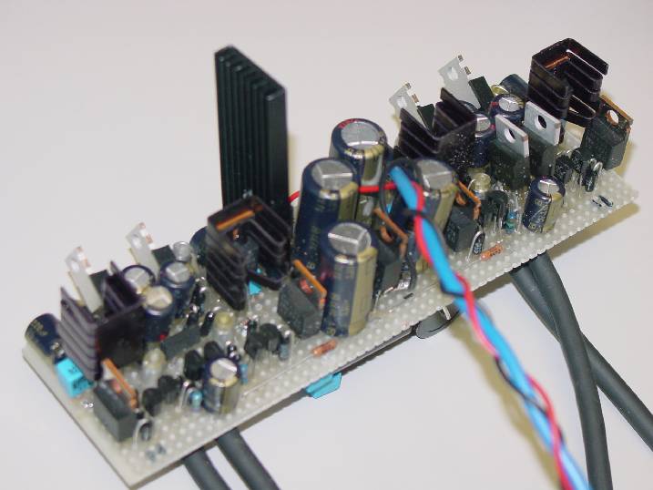

The motivation is the promise of a sound performance result you have dreamed of! I have tested passive and OPA I/U-conversion before, but nothing compares to this D1 modified circuit. Passiv was somehow soft, OPA with feedback nasty and artificial in sound. D1 original also somewhat soft, but with CCS it is gone. Maybe the same story like the evolution from P1.0 to P.17.
Since my nice board is sourced no longer by a TDA1547 but by 4 x PCM1704 with super slow roll off filter I know what is possible... The achieved neutality of music reproduction is undiscribable.
Oh, what would this musik world would be w/o the one and only? His circuits make higest end musik reproduction reasonable!
Regards
Klaus

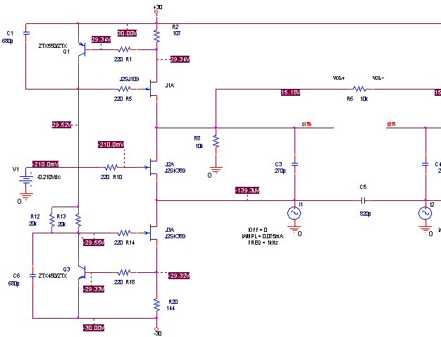

Hi guys,

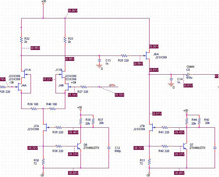

Finally i have time to spend in the simulation of a differential out stage for my cd 10...
referring to the original idea of Mr Pass's D1 stage and the modify apported by klaus i need to sum two of this stage because my cd have two double dac tda1547 that work in differential configuration... so this is what i have simulated...
please tell to me what do you think can be improved...
i think first to apply two CCs instead of the two 2k resistors...
thank you in advance
the out stage was posted on page 3 😉...
I don't know how it sounds because i am modifying the original project made by klaus for using the d1 stage by mr. Pass on a tda1547 in the switched cap pins bypassing the embedded opamp... i am simulating the circuit to made the printed circuit an mount it to test the sound, after this i could maybe improve the sound modifying the bias currents or caps or i don't know.. 🙂
Klaus and others tells that this stage sounds very well (excellent sound..)... but my problem is that i have to use for a differential stage with 2 tda1547 (one for channel).
So i have to sum the signal with a discrete op amp stage and a buffer...
I want to replace the entire power supply/out stage board of my cd10 with a new +/-15 v +/-30v (for this stage) totally renewed with a 4 jung discrete/op amp regulators... and i want to place all this circuit on a 15x15cm board...
I've made some modifies on the differential stage... i read on an old data sheet of national that using two double fet configured as in the schematic in the image could improve the CMRR...
Anyone have tested this configuration? better or worse than a single fet?

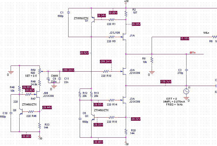

some improving (or this is what i think) on the stabilization of the voltage on the fet gates of the klaus stage...
Please post suggestions about this schematics... also laughs are accepted... 🙂
Bye and thanks for this fantastic board...

for the CCS, we can remove the ZTX? like the png
This is what i read...
Klaus said:
I tested the simple CCS with just one 2SK170. Due to strong variations of the unmatched FETs I had to set the R to the right value to get the required current. Also somehow the sound was worse, not so powerfull. Maybe the CCS combination of the bipolar transistor with its high gain and the bigger IRF610 gives the "stronger" CCS, working more ideal? I don´t know, but I do not care about some transis more or less...
I like the P1.7 CCS because the basis-emitter refernce voltage of the bipolare transi is a very good reference, no matching required.
Regards
Klaus
This is what Klaus tells about the configuration of simple ccs with fet+resistor or the other with the ztx... i followed the tests of klaus... but if you want you can modify the mounting of the pcb and bridging with a wire or with the gate resistors the components that you want to cancel... this is not a problem... you could test all the configurations without problems with a complete pcb... more difficult is adding components on a simple pcb instead to remove some parts... this is what i think when i project a board, when there isn't problem of space...
we can keep a differential pair in the IV?
maybe it's possible but i have to mantain the zeros points for the common of the dac outs, for me it is not good to place a single ccs in the differential stage for having the d1like stage and the differential op amp in the same chain... the modifiying of the currents move the voltages of the sources of the two main fet in the d1 stage... so for a my idea (that can be wrong) this can't be a good stage... (sorry but my explication in english can be very hard to know... 😉 )
So i thinked to use a separate stage to sum the two signals...
But this can be wrong....
