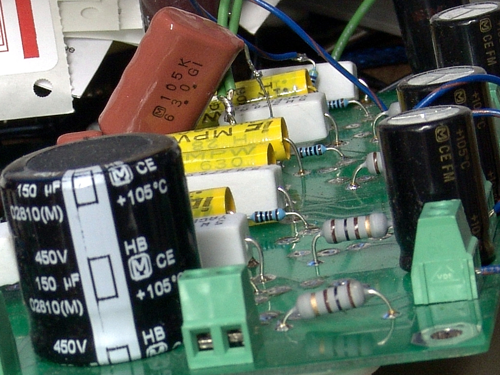

I googled again for pictures of the HA caps. I can't find the exact one I have but most pics there came from digikey. I also suspect the M logo. It seems a little blurr to me. But I read other threads about fake transistors and the fake ones have better print so go figure. There are some pics from digikey also shows blurry M logo too.
As for as the date code is concerned, it is only four digits on my batch but from the internet, the date code seems to be six digits. But again, I can't find the exact picture. Also, from the batch of caps I bought, there are some with 9448 as date code.
Do I have real caps ? or fake ones ?
I am holding a genuine Panasonic from D-K in my hand....
There are several hundred in this room. The picture here shows 5 genuine Panasonic caps, all purchased from Digikey.
I have seen real Panasonics with a 4, 5 or 6 digit date code. The old ones have 4 digits. I have about 50 of the 450 volt 150 uF caps from 2010, they have 5 digits. Some of the very recent caps have 6 digits. The gold label CEFM's have a red date stamp on the side, its not part of the printing. All were purchased from Digikey.
I have a few hundred 47 uF 250 V "Panasonic" TSNH's that I bought from All Electronics for 20 cents each. They do look different from all the rest, much thinner line width, and razor sharp printing. They also have the red date stamp. I bought a few abused them heavilly in the power supplies of guitar amps, none failed, and all worked good, so I bought more. Are they Real? I dont know, or really care. They work.
The quality of print on mine looks very very close to the big one on the left of your picture.
I can't tell. His caps look very similar to the ones that I have. They are sized about right for their value. I am going to guess that they are real, since a faker would probably use a more current date code. Most fakes are made in China. Chinese imports were not so common in 1988.
The few fakes that I have seen are usually obvious, not by looks, but by performance.
The fakes are usually the cheapest crap the con artist could find with a new shrink wrap over it. The value of the fake usually doesn't match the label, and in the tube world the voltage rating is almost always wrong. Higher voltage caps cost more than lower voltage rated caps, so high voltage fakes usually have low voltage guts and a non matching wrapper. Any time I get some suspect caps, I connect them to a power supply, set it to about 10% OVER the rating, place a coffee mug over the cap, and flip the switch. The fakes often reveal themselves with a bang. I'll test about 10 and none better draw any current.
That might not be the case here. The time constant test mentioned above could give a good approximation of the value. So could a decent capacitance meter. If the value is correct, they are probably real.
The Panasonics are 24 years old and will need reforming with a series resistor of 100 ohm to 1 k for 24 hours without a load. if they are still any good and then how long would they last? They also seem smalll for a cap of that age and capacity. I don't think you are doing your amp a favour using caps that old. Buy some decent new ones- Panasonic or Nichicon ( Great Supply if you can) - Morecroft - try a few Silmics in parrallel.
