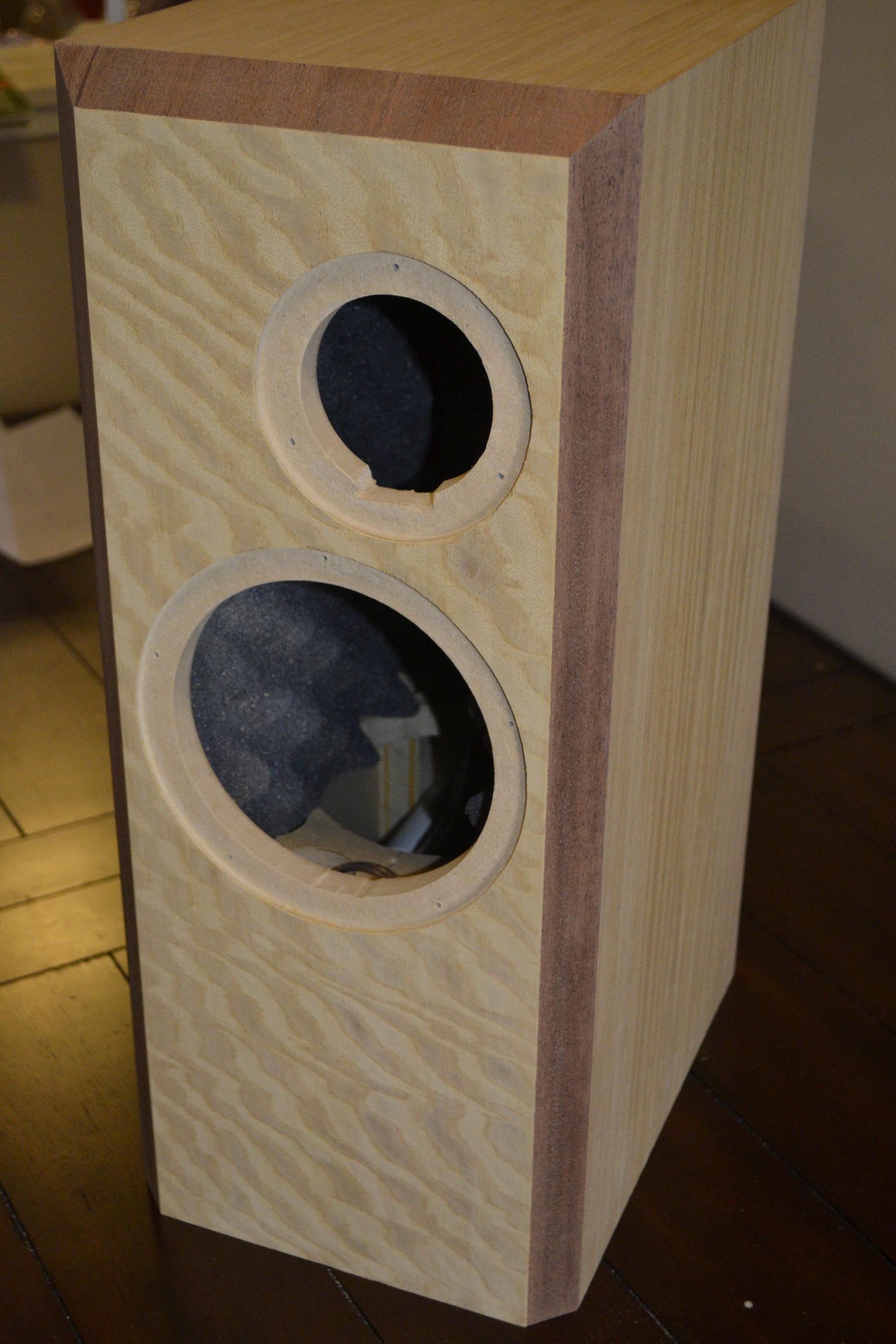

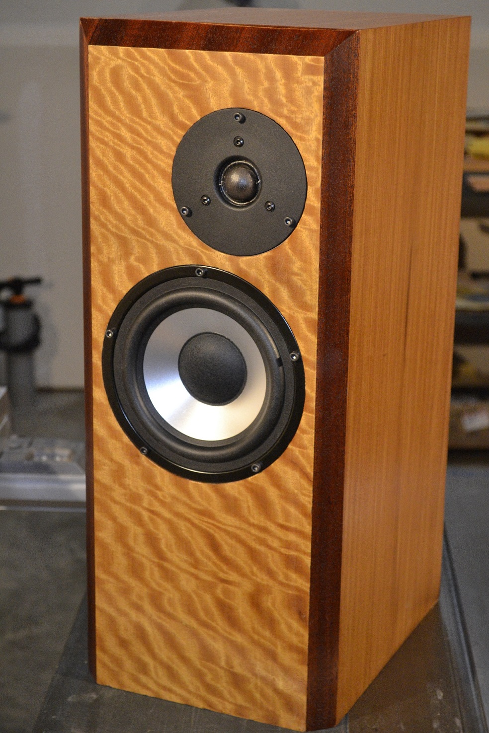

In case this may help anyone with a future project this is something I came up with. I was concerned about cutting all of the holes through the veneer (pre cut in box) as to how hard it would be and how ragged it would be if I cut it with a knife but I came up with a method that worked really well. I started by cutting out the veneer up to a half inch maybe less with a dremel cutting bit. Then I added a small washer to the bottom of the larger sanding drum, this let me cut the veneer back to almost the edge of the opening. A little 80 grit and it lines up perfectly, nice round circles, smooth as butter. I did the same on the flared port, just a little more sandpaper.
Just FYI, I had absolutely NO problems with my last veneering project.
I went over the driver areas a little extra just in case, cut the driver holes through the veneer and even in highly figured veneer there was no problems with even the slightest splitting.
I used a carbide spiral upcut bit, a compression or downcut spiral would be even better since they wouldn't be pulling up on the veneer.
