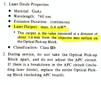

Laser diodes do not go in and out of functioning. If the LD itself is failing, it is a slow (or fast) decline to low emission and then complete failure. Without a LPM (laser power meter) you are flying blind so to speak in term of determining the actual output in relation to spec.
I have never seen a Sony CDP-100. The CDP-101 of course is their first commercial unit.
The CDP-100 was a Sherwood rebadge of the Sony CDP-11s AFAIK. It uses a KSS-100A. Rated output (measured) is 0.4mW
0,4mW, 400uW are a usual data cited in cd service manual, but in practice are very very excesive power.
Ignore the famous 0.4W cited in service manuals.
If you check laser power meter in cd laser pickups use to be between 100 and 175uW. Some early Philips below 100uW.
KSS-150A uses to be between 115 and 150uW.
If the laser pickup is aged, at can be a 175 or a bit more.
