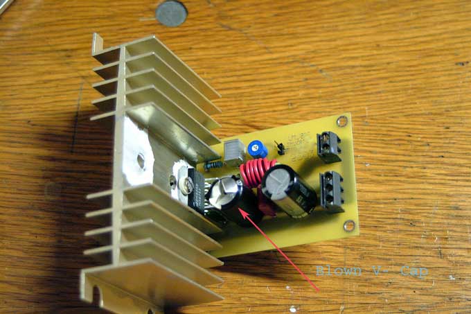

here's a dead one -- too much sine wave testing -- this puppy was happy putting out almost 50W at 0.011% THD, then went poof. Note the blown V- capacitor (1000u/63V).
are you very sure the cap's not in backwards? a 63V cap should 'survive' to about 80V for a short burst, however if it's polarity was reversed, death could take up to a minute or so as the electrolyte heats up eventually boiling (then again, death could be instant too)
