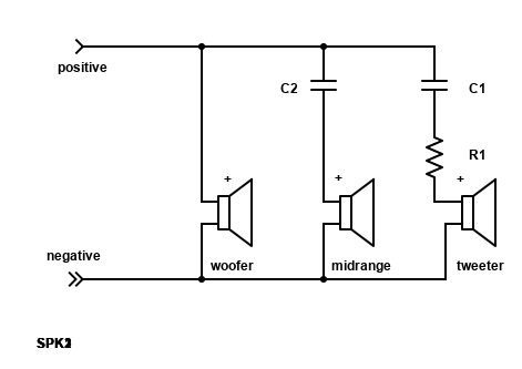

I am planning on making a speaker with all 8 ohm drivers, tweeters, 5 1/2" mid, 8" woofer. I'm thinking of just wiring them all in parallel and using a high pass capacitor to step the signal from low to high. Will this work? Is there something I need to consider when doing this kind of design? I absolutely don't want to get into modelling x-overs or building a fancy 3 way x-over, I realllly want to keep it stupidly simple and just tweak the roll off points and be done.
I'm thinking of just wiring them all in parallel and using a high pass capacitor to step the signal from low to high. Will this work? I absolutely don't want to get into modelling x-overs or building a fancy 3 way x-over...
Hi and welcome to the forum!
The minimum requirement is to make sure that both the midrange and tweeter are protected from the bass frequencies present in the music.
The simplest way of doing this is to wire a bipolar (non-polar) capacitor in series with the midrange driver and a smaller value one in series with the tweeter (see attachment). You may need to include an attenuating resistor for the tweeter.
This arrangement will work, but of course will be far from optimum!
The capacitor values will depend on the required crossover points of the midrange and tweeter drivers.

If you are contemplating the uncomplicated arrangement that I attached, then the two crossover points should be at least 2 octaves above the resonant frequencies of the midrange and tweeter drivers respectively.
The resonant frequency (Fres in Hz) of each driver should be stated in the driver specifications, so look them up in order that nominal capacitor values can be suggested.
P.S. I will stress again - the results will not be optimum.

The issue I have with actual x-overs is being locked into specific values for parts due to the fact that the theoretical never align with the real world.
This is nonsense, especially if you are designing the crossovers yourself. While the component values may be fixed at discrete values (e.g. E12 range), you can mix 'n match to your heart's content. Anyway, your proposed approach is way, way more inaccurate than your bemoaned "theoretical" approach. Simply put, the problem you describe is not a major one and is easily dealt with. Evidence for this is the multitude of successful commercial and DIY project.
It will work, why not.
But chances that it will work well are slim to zero.
