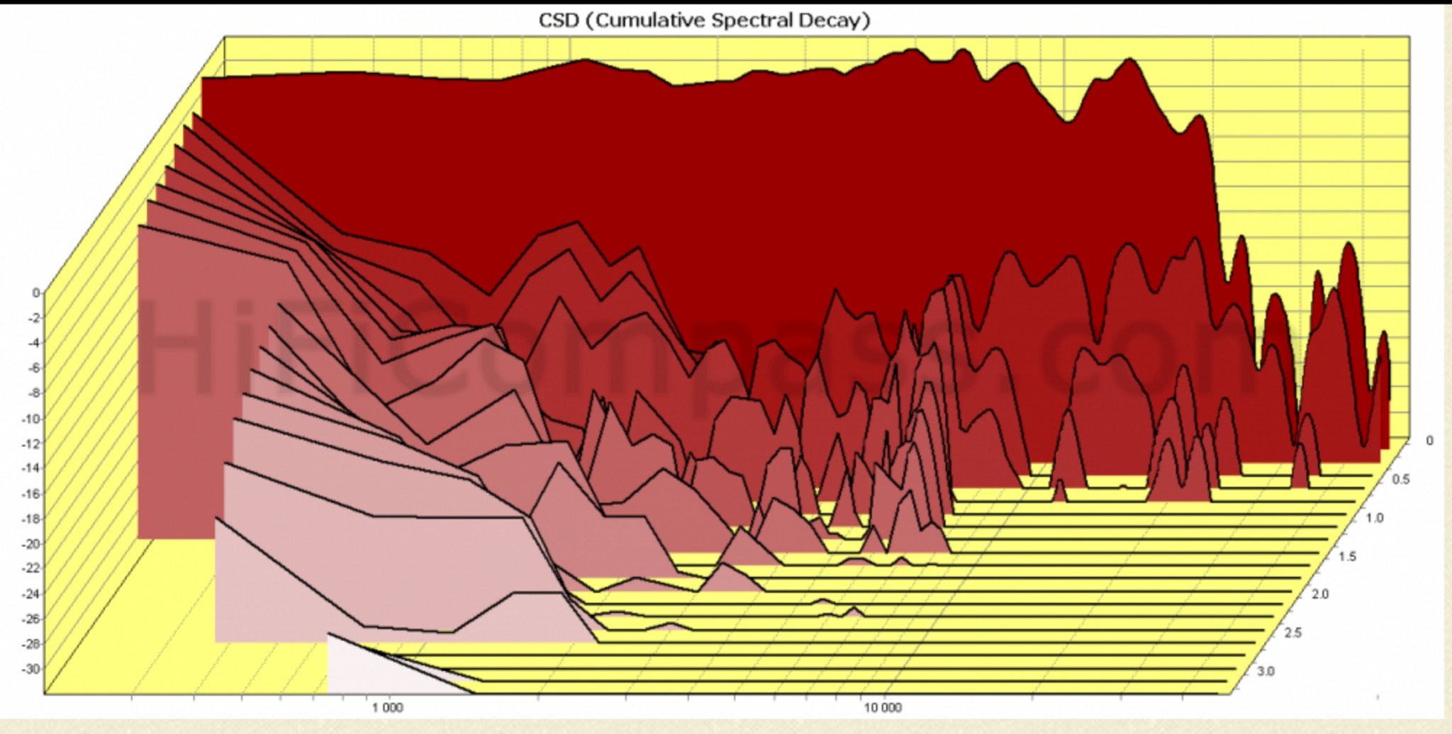

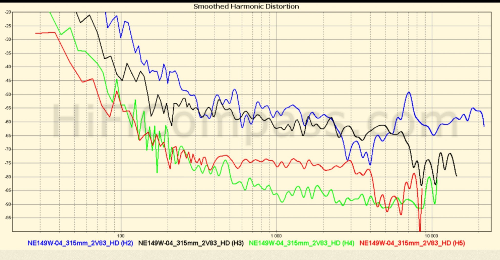

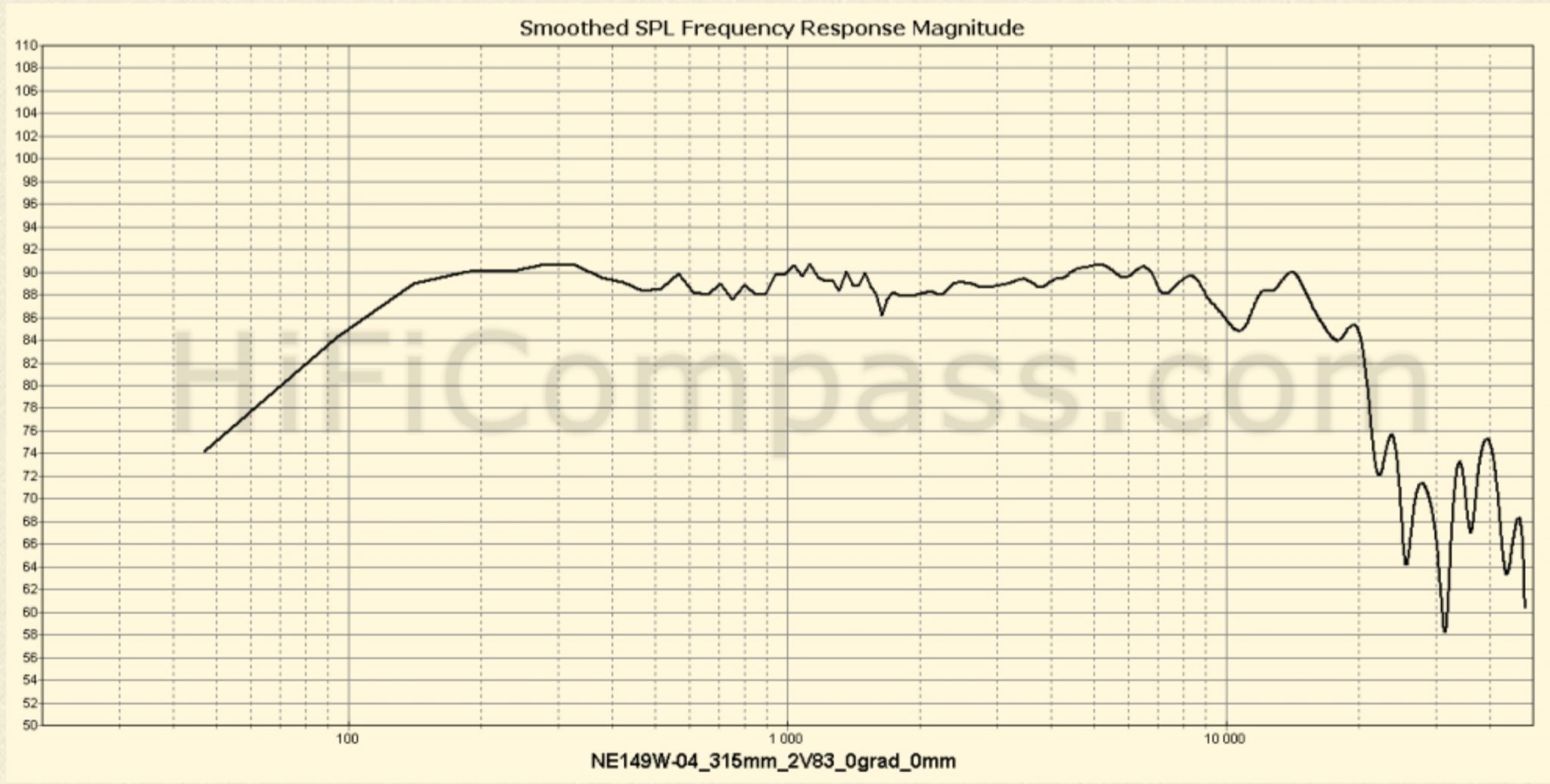

In the pro audio world, there are some drivers that can run open up top like the Eminence Beta 8a and B&C 8PE21. The exception with these is needing some BSC type EQ to compensate for the huge motor that brings a rising reponse with it. This holds true for many boutique fullrange drivers as well.
The Peerless NE149W can run wide open. It sounds very refined and dynamic with decent LF weight for its size.
