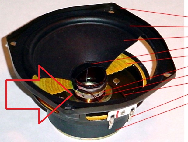

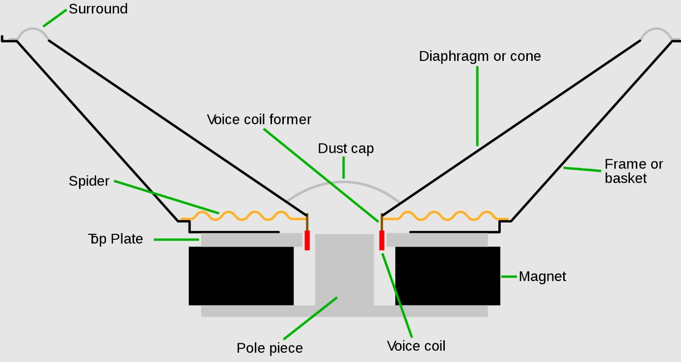

Have you examined the driver and moved all of the parts?
Loose dustcap
Loose surround (frame or cone)
Loose spider
Loose neck/triple-joint of cone/former/spider
I have a feeling there is a material failure somewhere if you can't find anything loose like debris.
