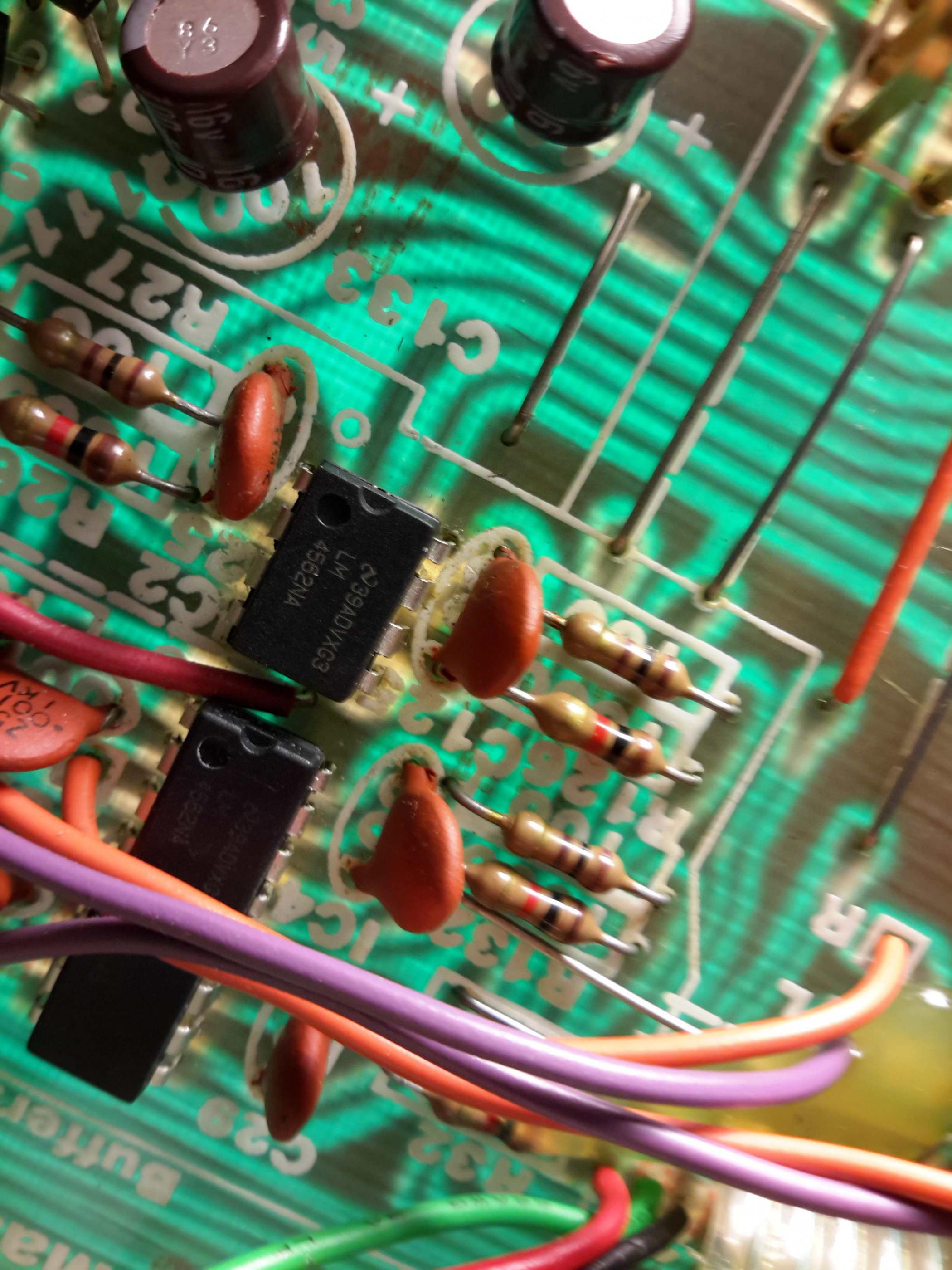

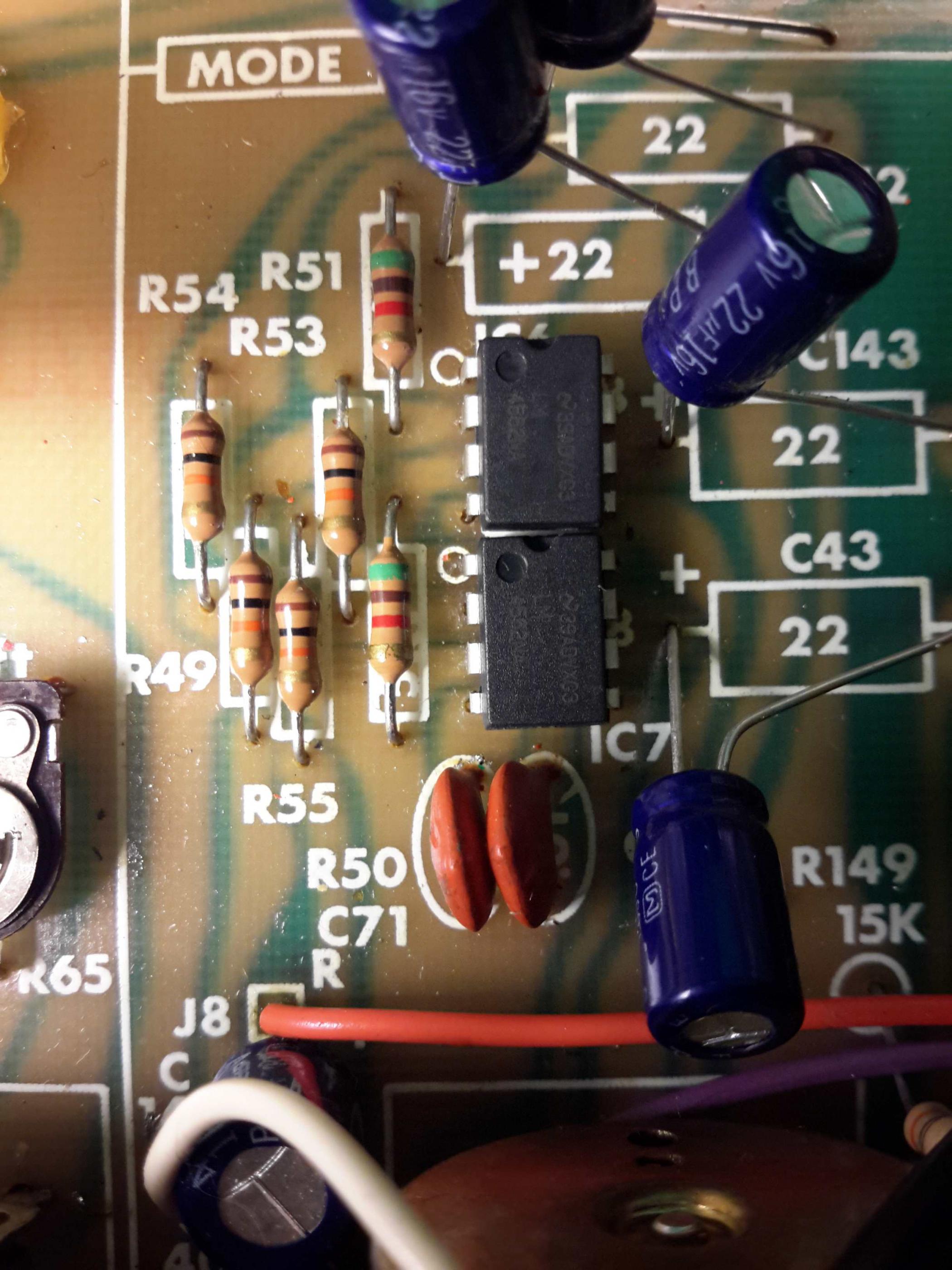

Hi all. I've finally got it all in place, thanks for your help!
I'd like to say the mids sound more airy and the bass is...different. I can't say that for sure. But I can say definitely that I had fun making the changes, learned a lot, and that's a large part of the diy experience for me.
Unfortunately I forgot to take some nice pix of all the changes. I do have some though.
Thanks for the update (and pics 🙂). Pleased to hear it has all worked out OK, and I think on extended listening you will notice a difference.
