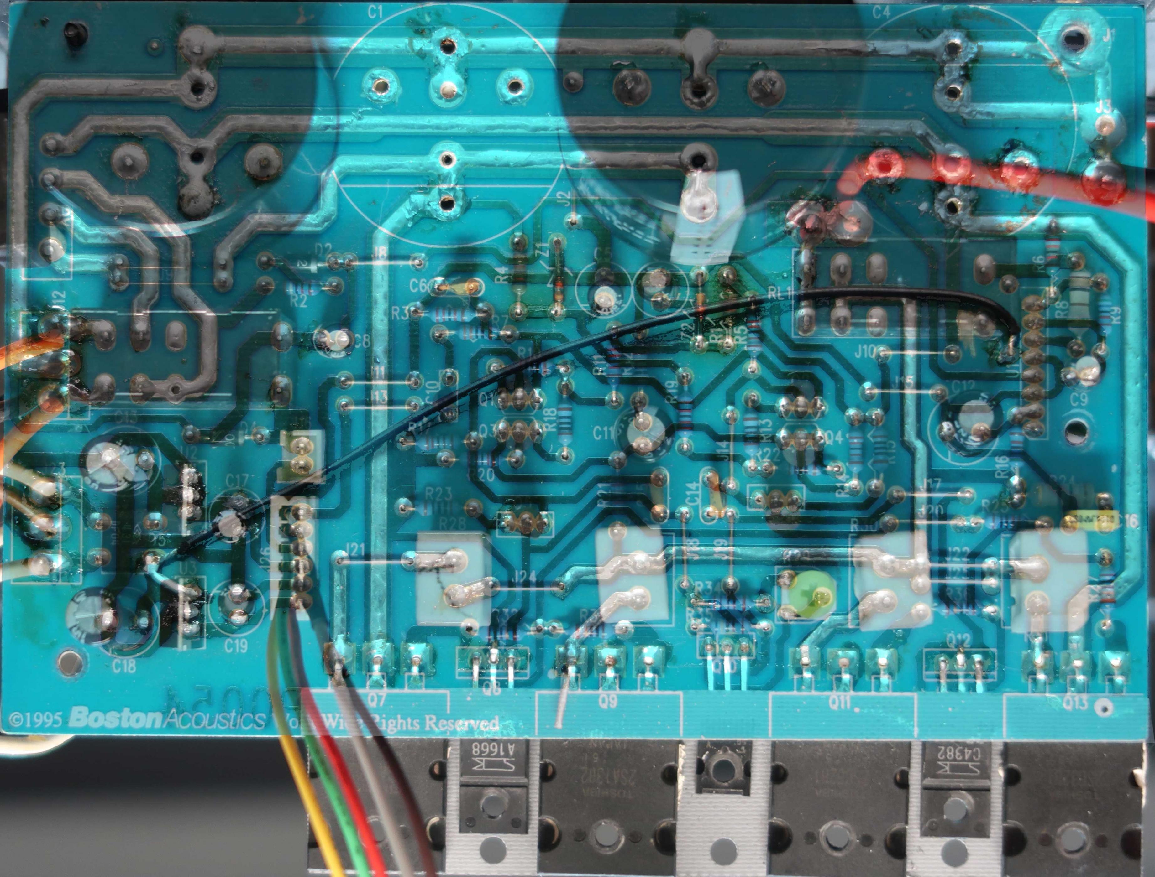

I reverse engineered the schematic, now I need some help with troubleshooting AB amp
Overall those voltages and the DC offset look good .
I have picked up on a 3 anomalies ..
1/ Voltage at Q2 collector +75.7V looks correct but it should be the same as the voltage at Q6 base (+74.7V ?).
2/ Voltage at Q1 collector -78.0V looks correct but it should be the same as the voltage at Q5 base ( -76.4V ?).
Maybe connecting directly to the bases of Q6 and Q5 causes oscillation and upsets the readings (quite possible).
3/ There is 450uA flowing through R14 ( according to all the other connected voltage drops ) which should give a voltage drop of 0.99V across R4 and not 1.6V (77.2V - 75.6V).
The current through R1 is 8.79mA and thro R4 8.95mA giving 0.479W and 0.497W dissipation so change them to 1W handling as " PRR " advised ( if you already have not done so ) .
I made the measurements using a digital oscilloscope and the accuracy of the DC values changed based on what scale I had selected and how long the Rms averaging was. I think they are all +- a tiny bit, so the slight anomalies you found are things I noticed too. I'm not too worried about the tiny mismatches, if that makes sense.

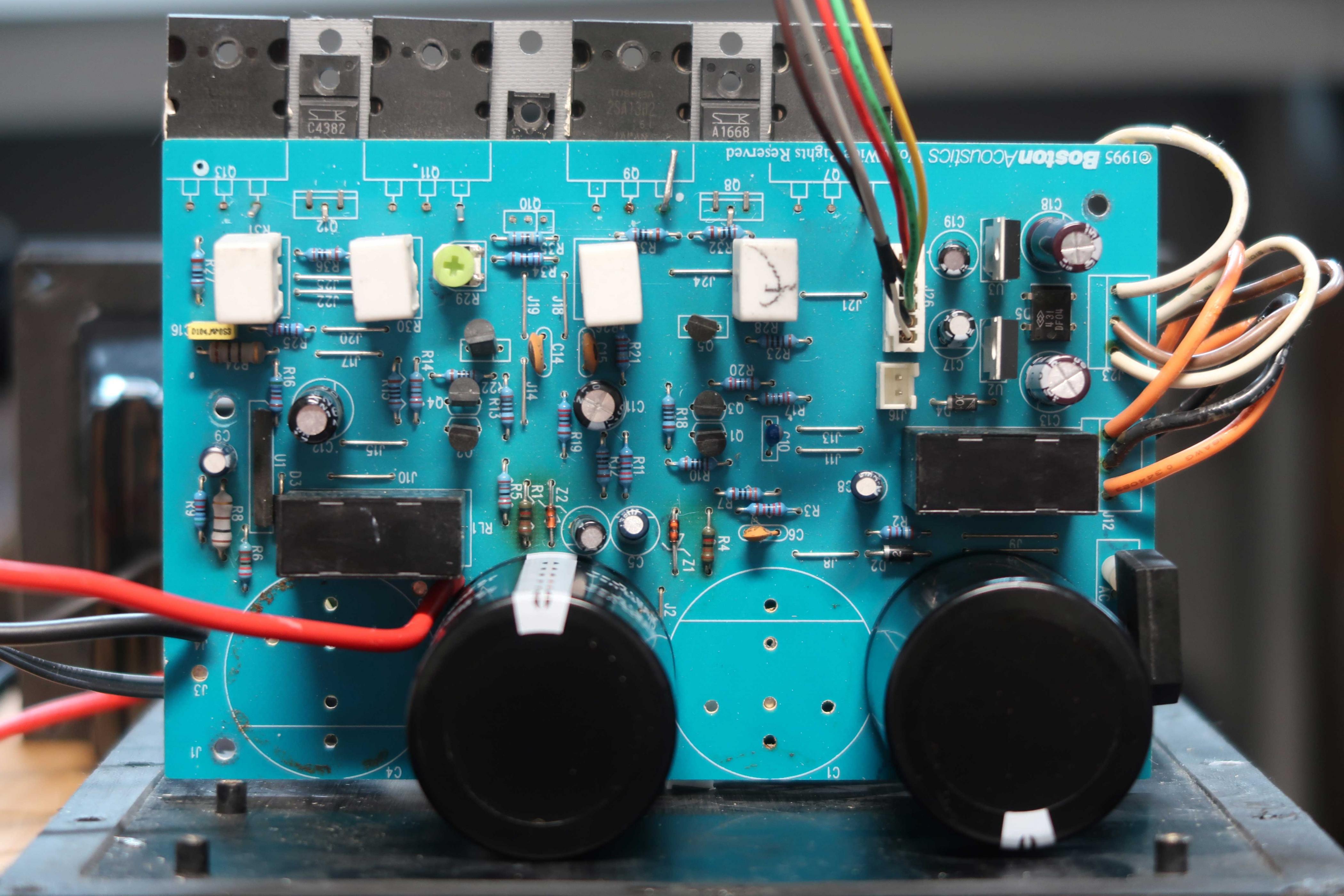

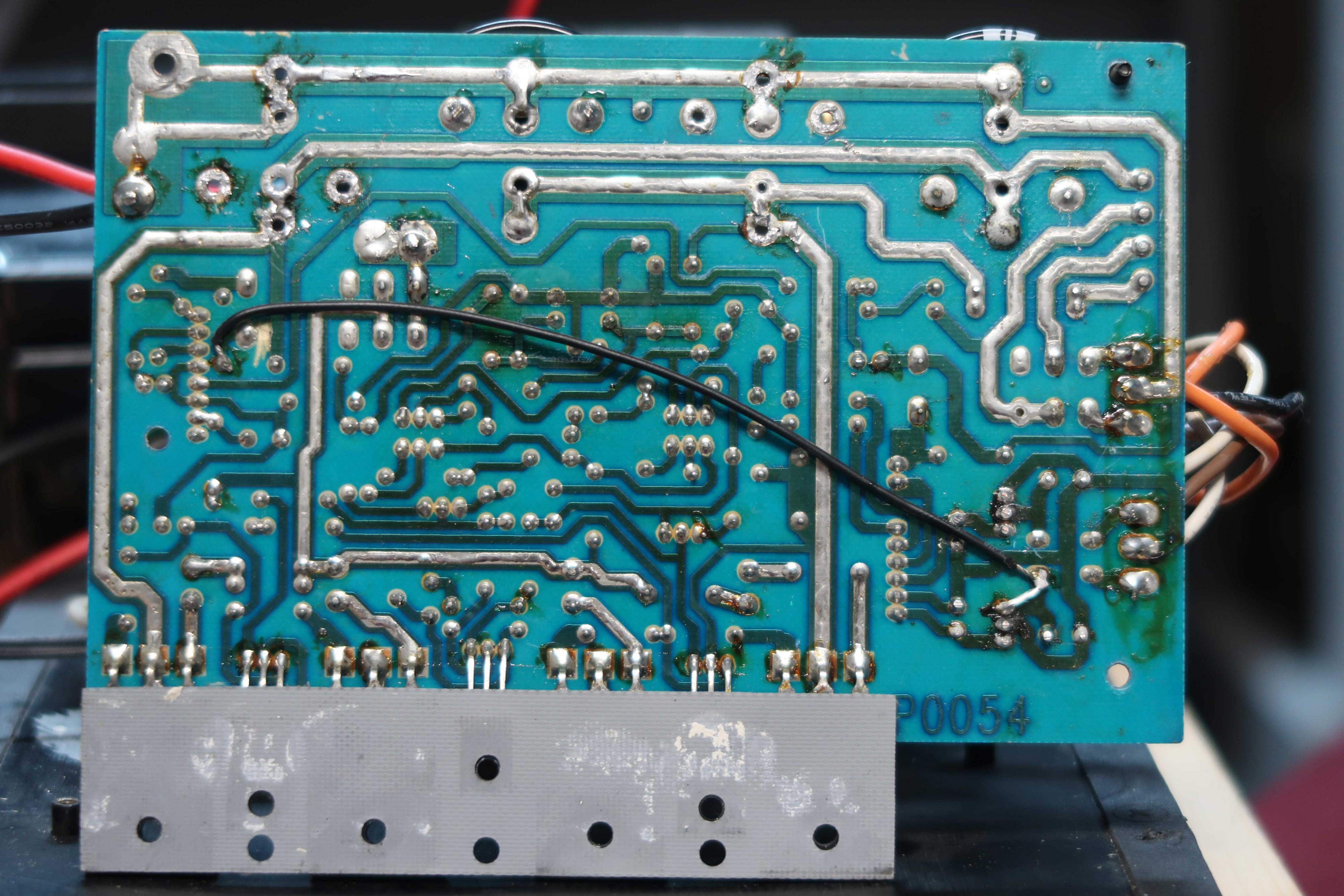

I replaced the main output transistors today, re-did the thermal heatsink pads with new grease, and turned it on. It didn't blow a fuse or catch on fire, so I'm stoked!
I slowly adjusted the bias potentiometer and measured the voltage across the output resistors using a regular DC volt meter this time. I can get a DC voltage drop between 0.0mV and 10mV at the most. I set it at 9.0mV.
The amp seems to pass a 100hz sine wave like a champ all the way up to amplifier rail voltages and down to about 20mV of AC noise with no input signal. I tried watching the output on the oscilloscope while adjusting the bias but couldn't notice any difference between min and max adjustment on the potentiometer. Should I be able to see something? I was hoping to see some crossing point distortion but maybe that's hard to see at lower frequencies?
I'm really happy with this and I thank you all for your help. I don't need more bass in the home theater since I already have one of these, but now I can have twice as much!

Great news on the working amp 🙂
On the issue of viewing crossover distortion whilst adjusting the bias , this is something I have not tried but suggest the amp needs to be driving a dummy load with approx. 10W . I know "nigelwright 7557" views the crossover distortion whilst adjusting the bias but I don't know the detail .
😎 photo .
