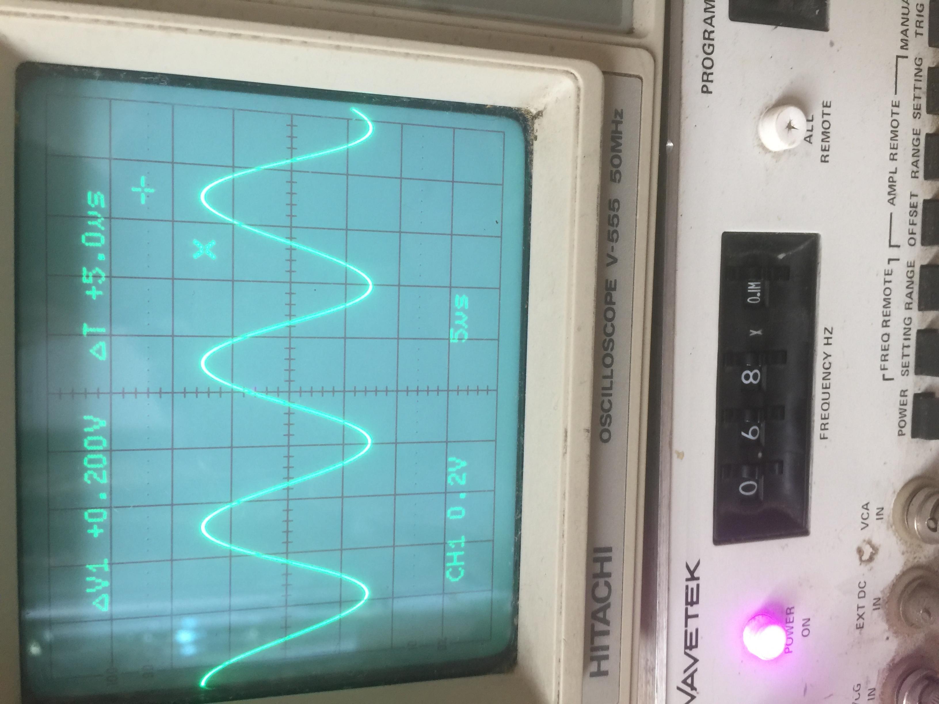

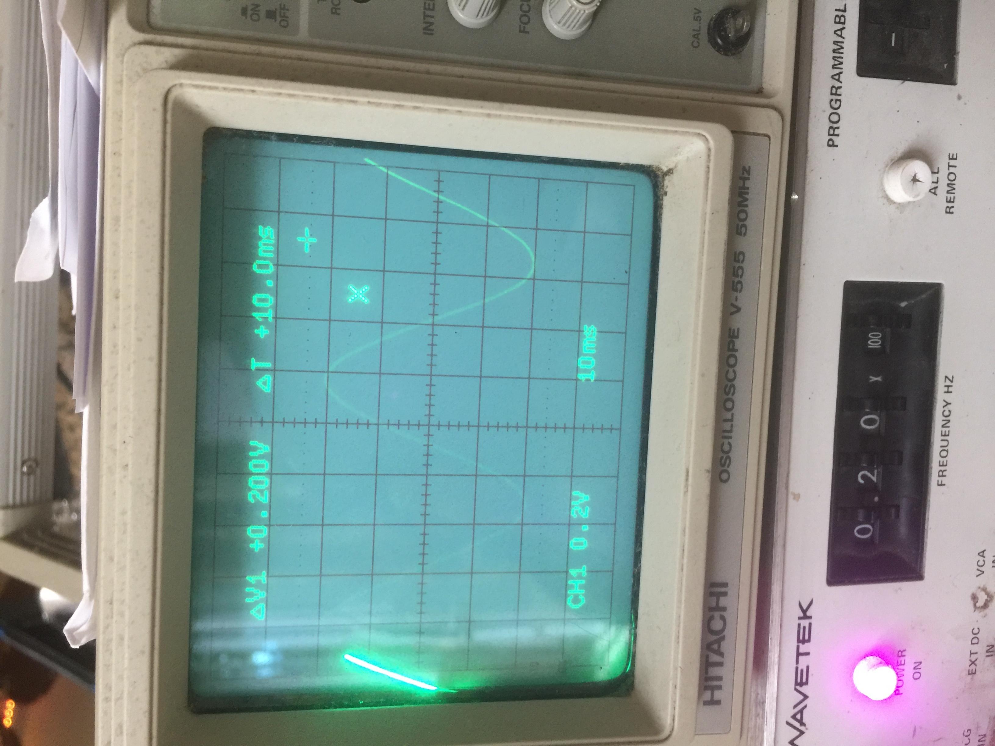

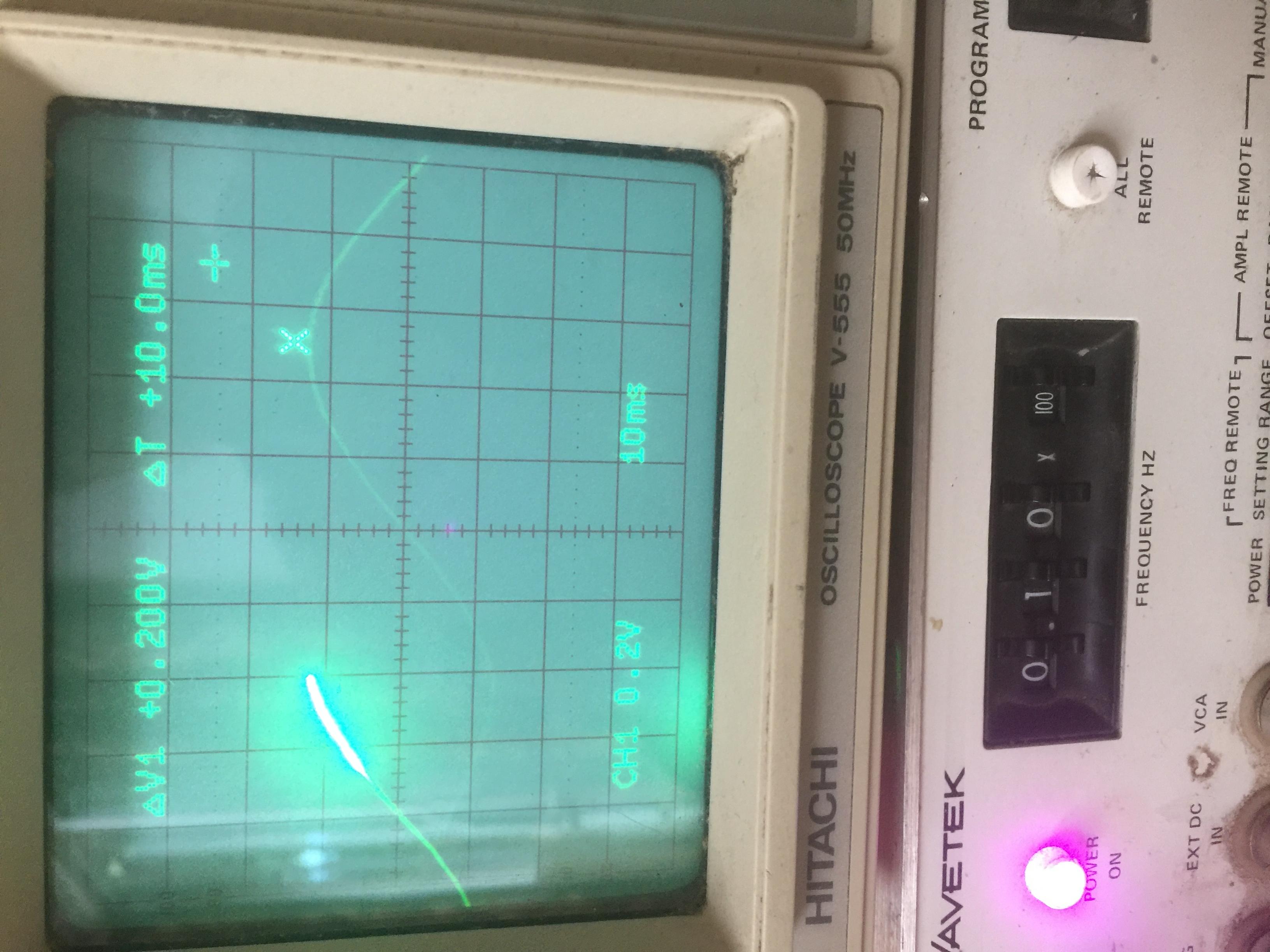

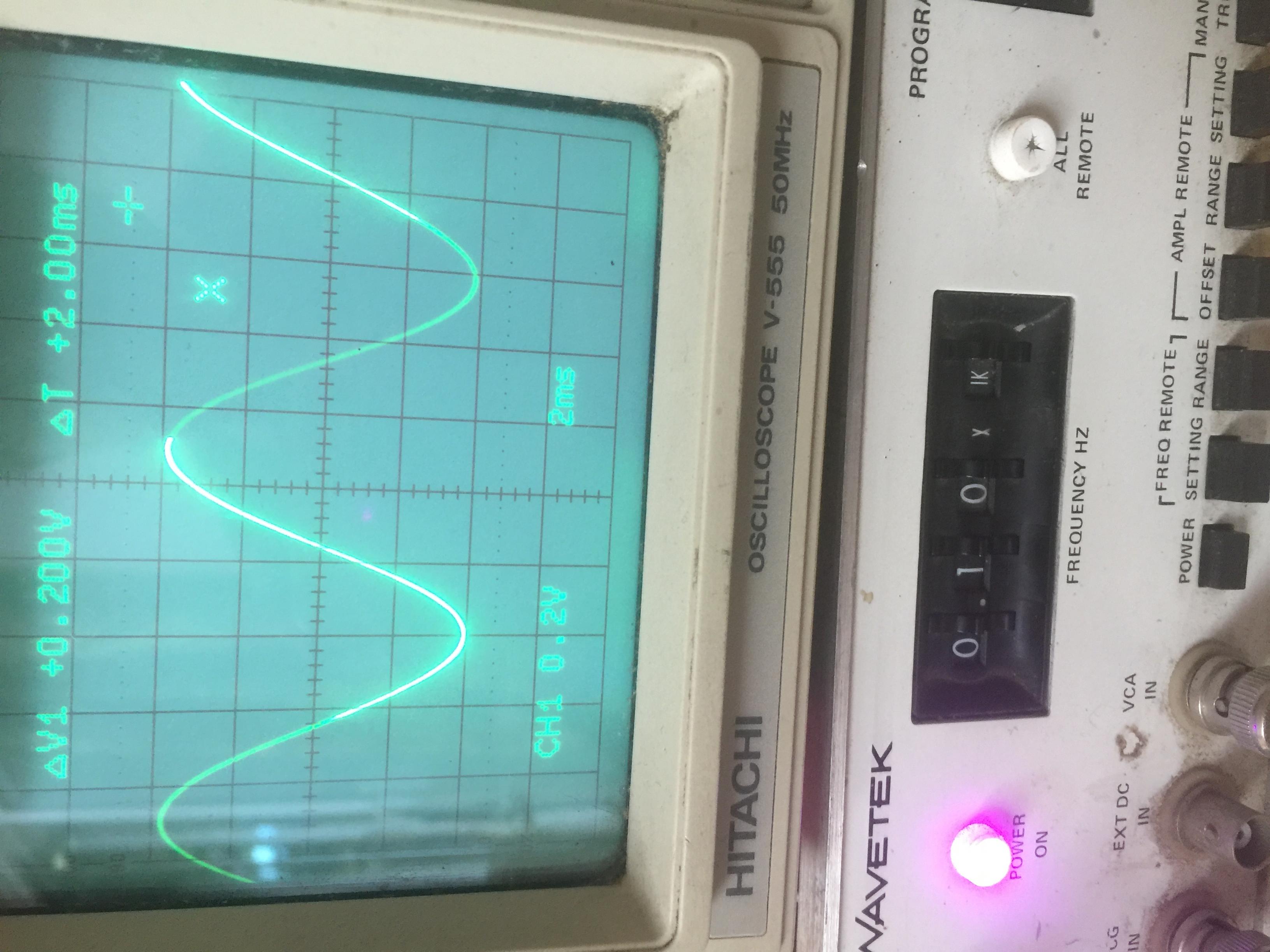

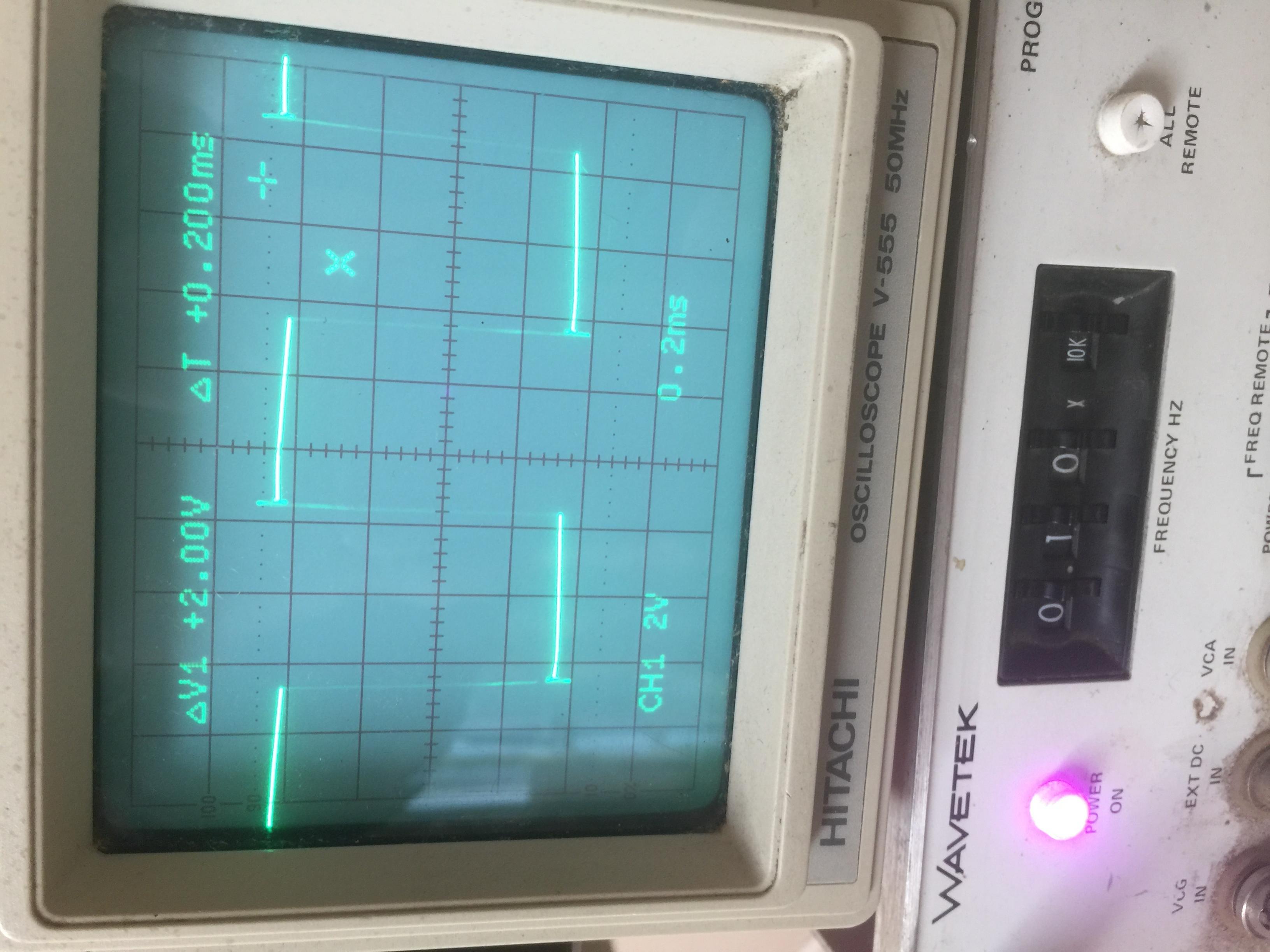

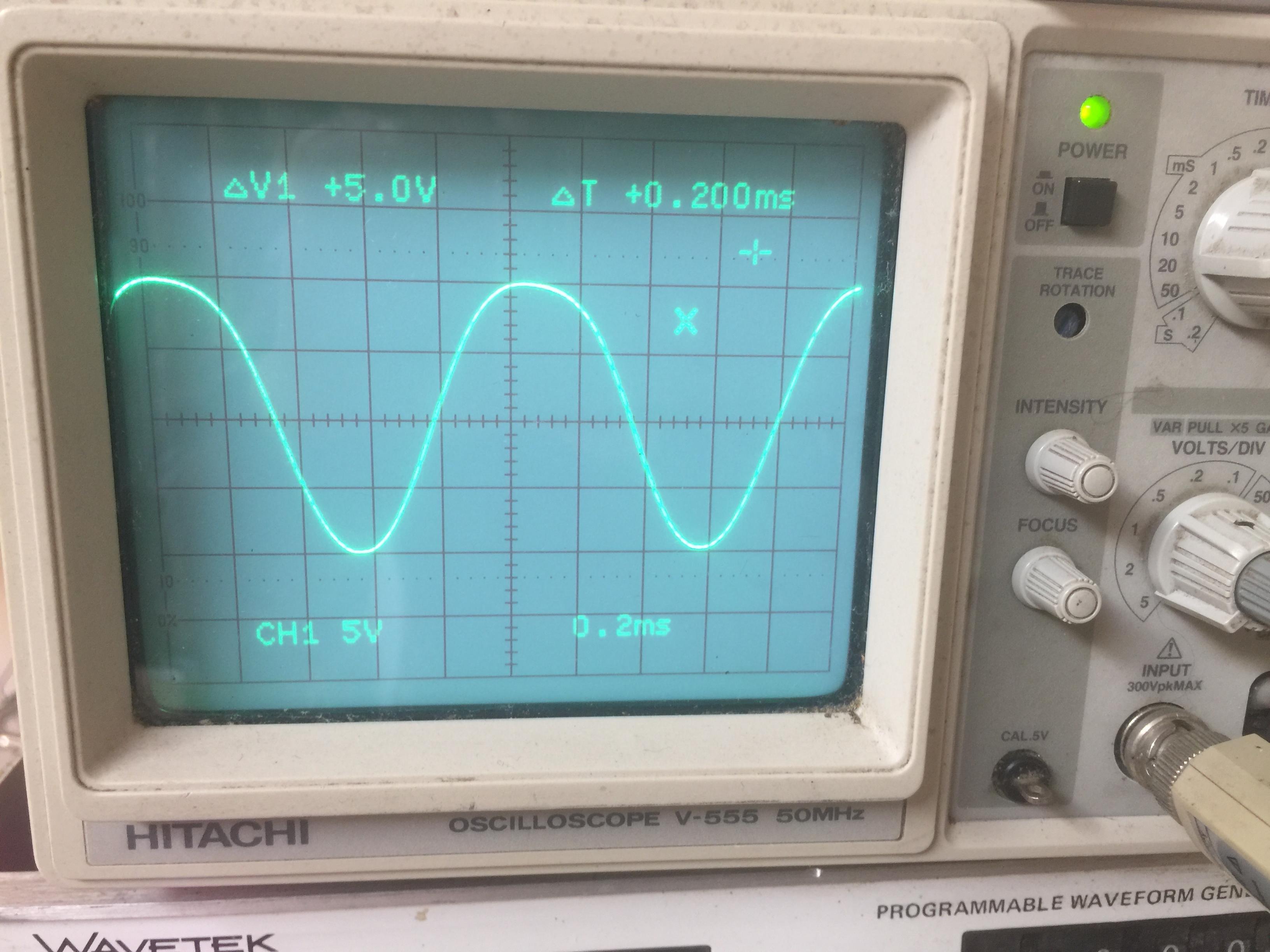

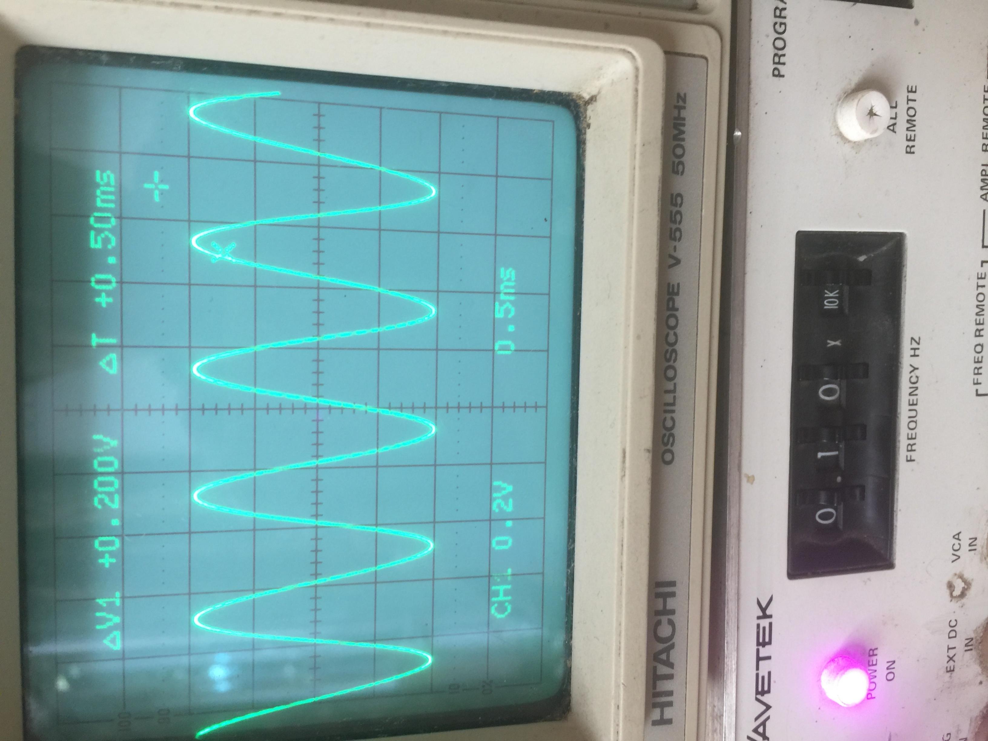

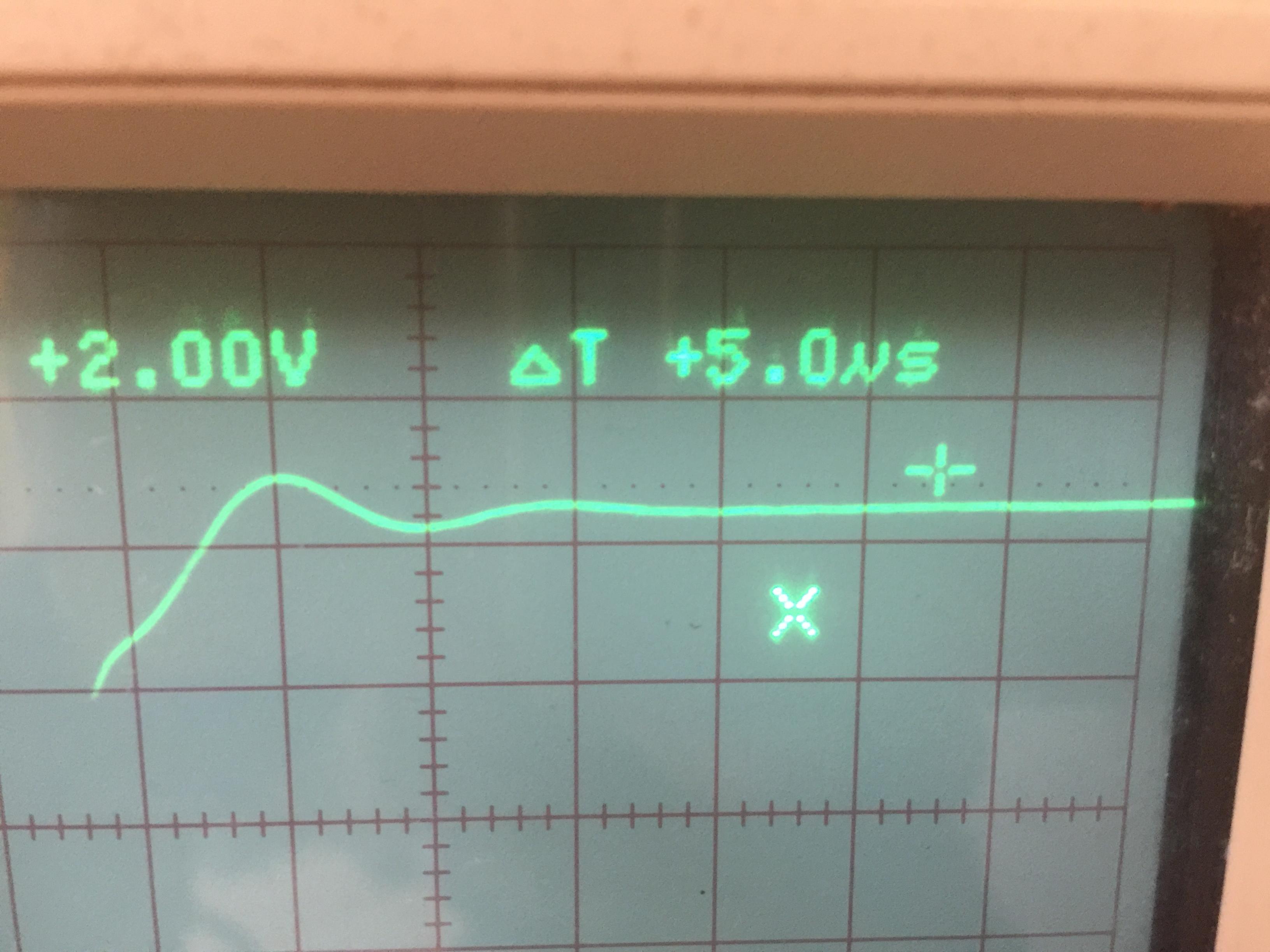

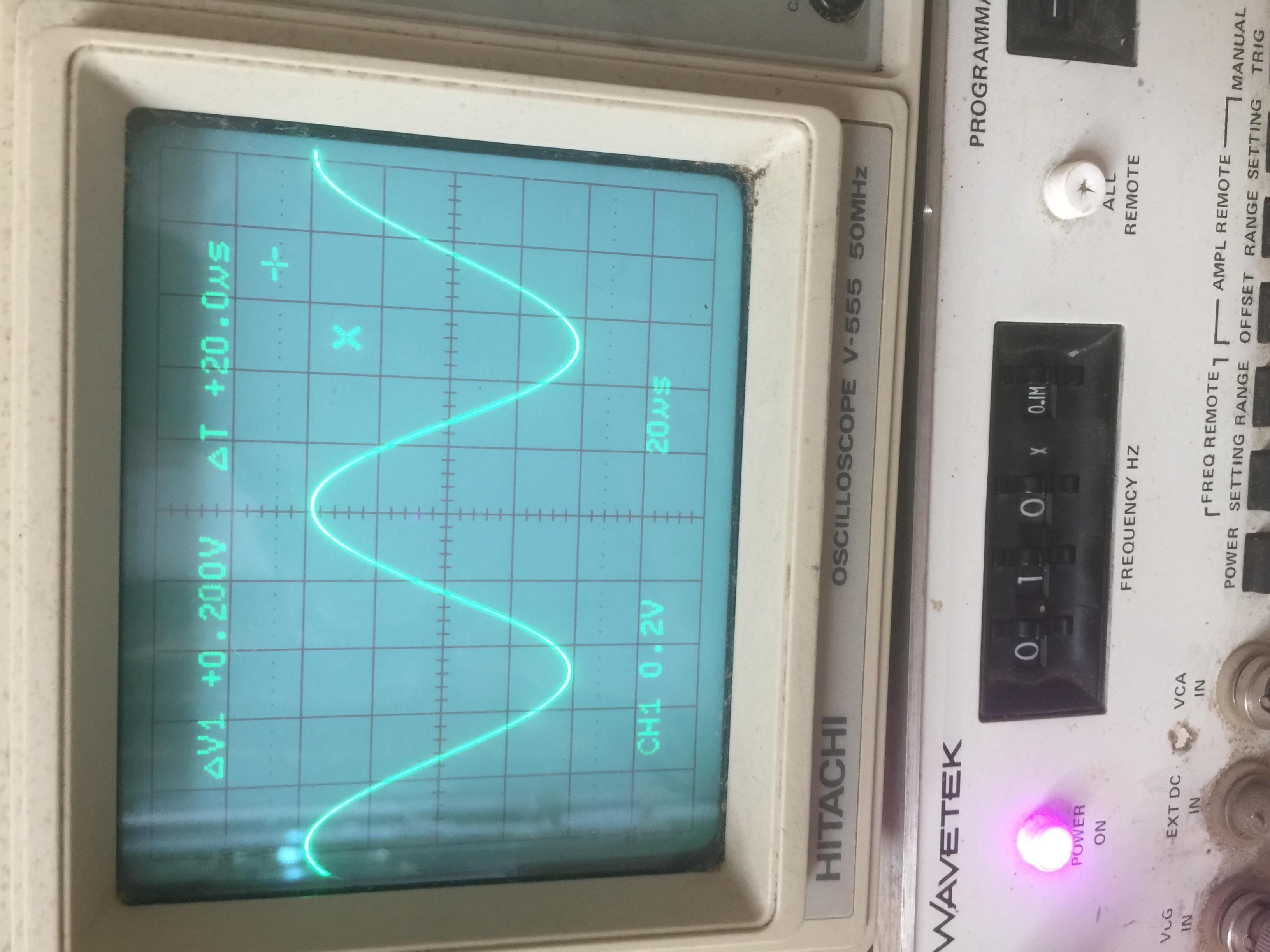

10W Edcor USA output transformers. 6.24w output on soft saturation with dominating 2'Nd order harmonic, 10 Hz - 68 kHz bandwidth on -3 dB level, about 125 kHz ringing. Posting pictures.

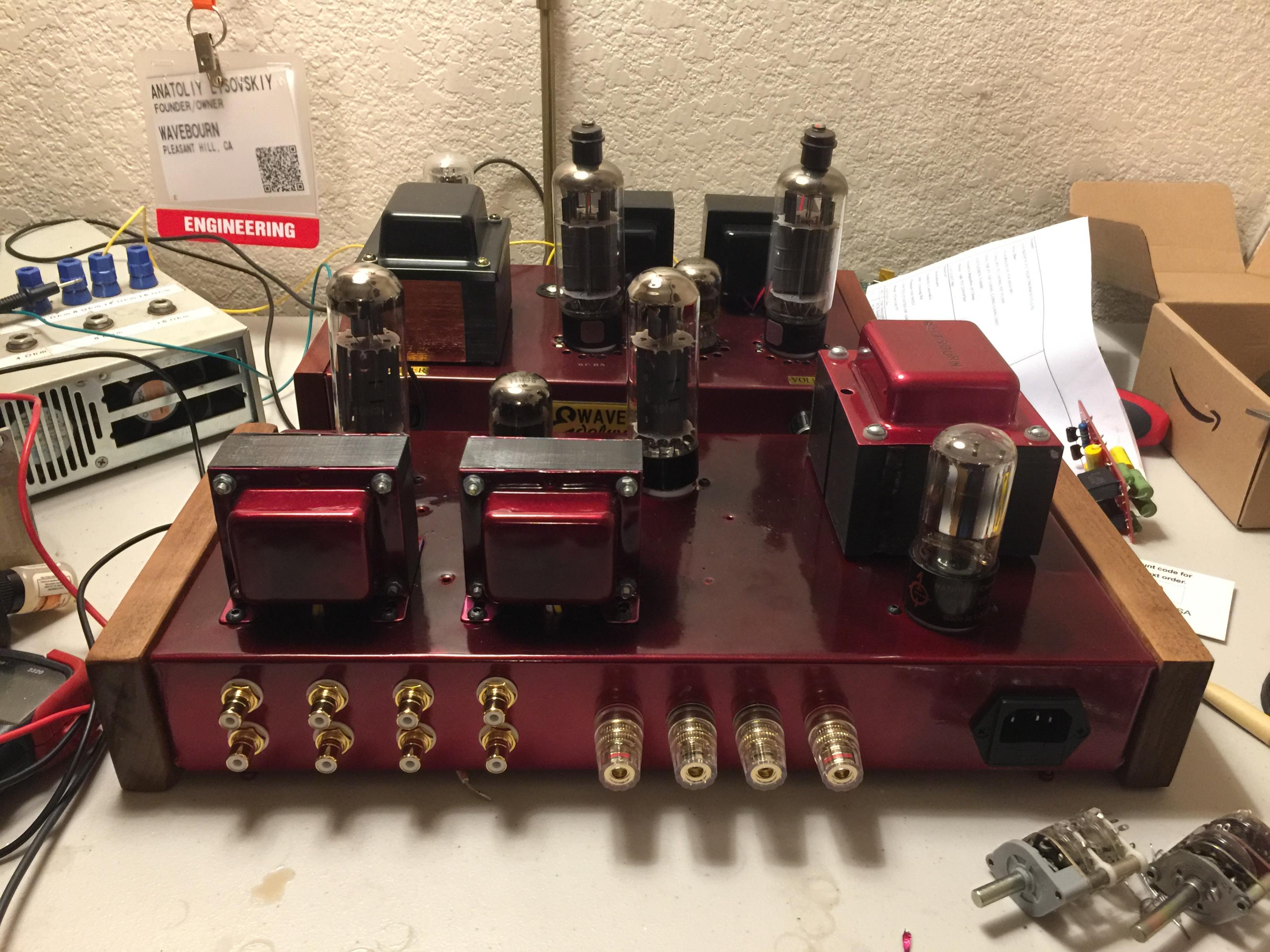

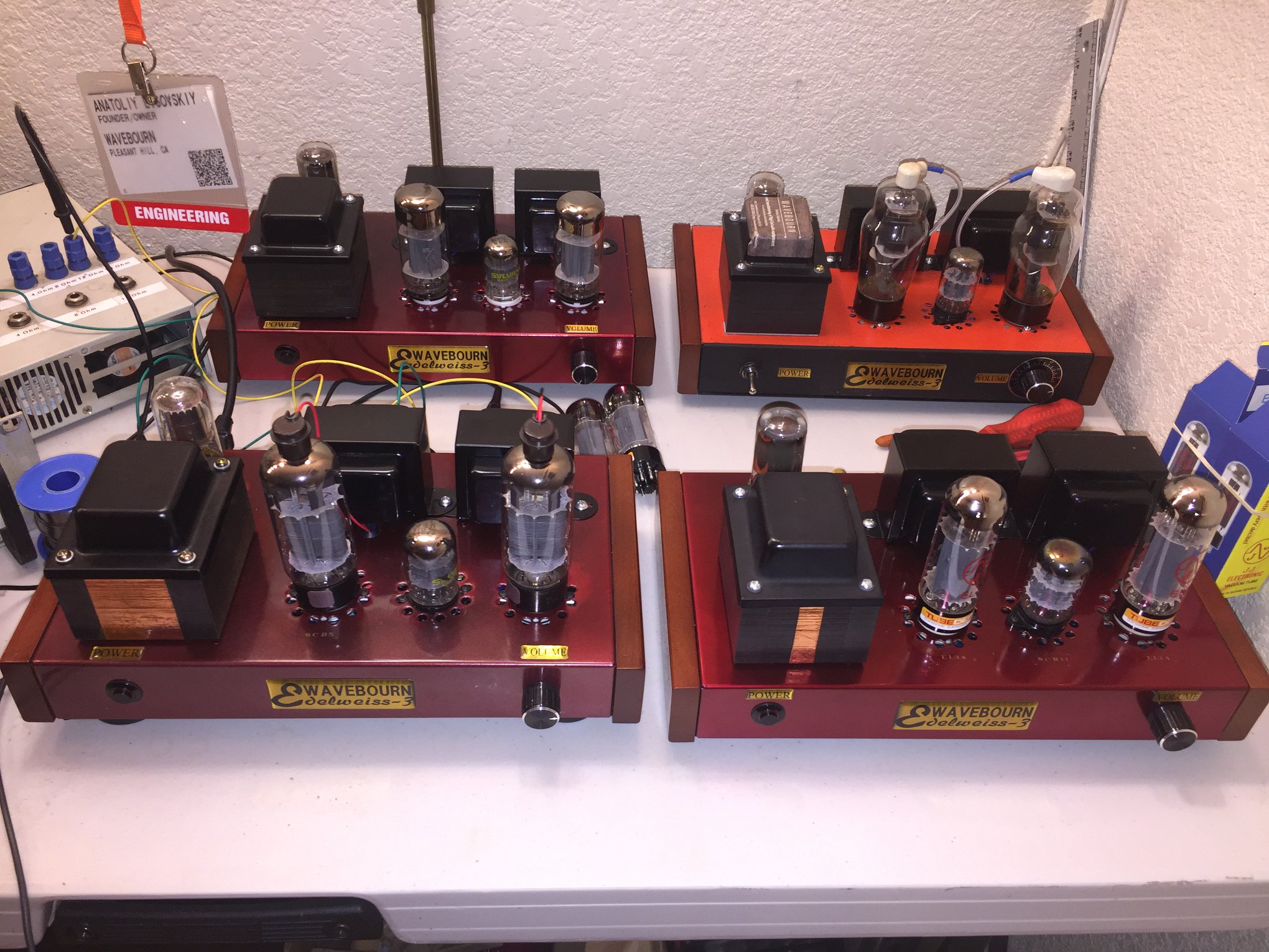

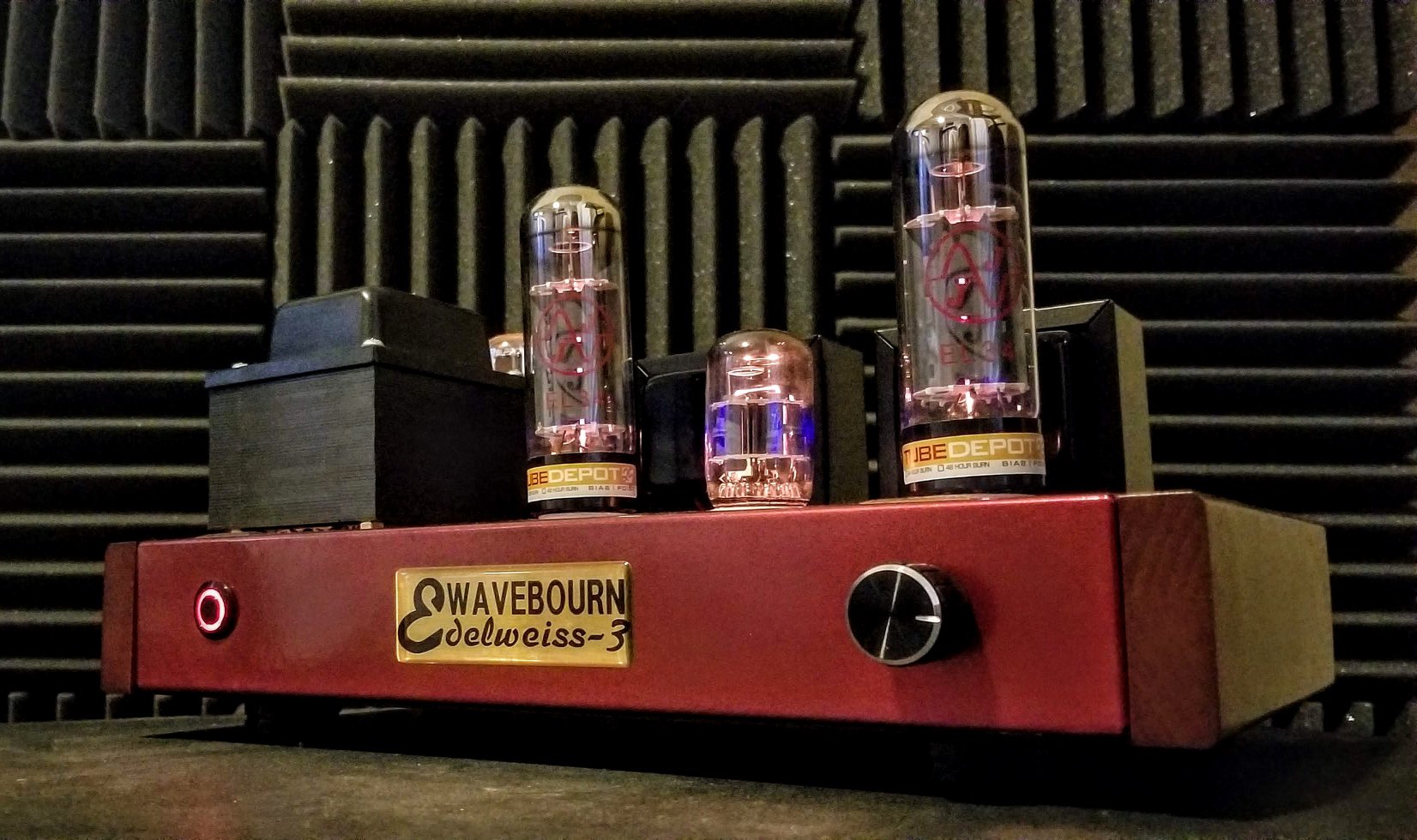

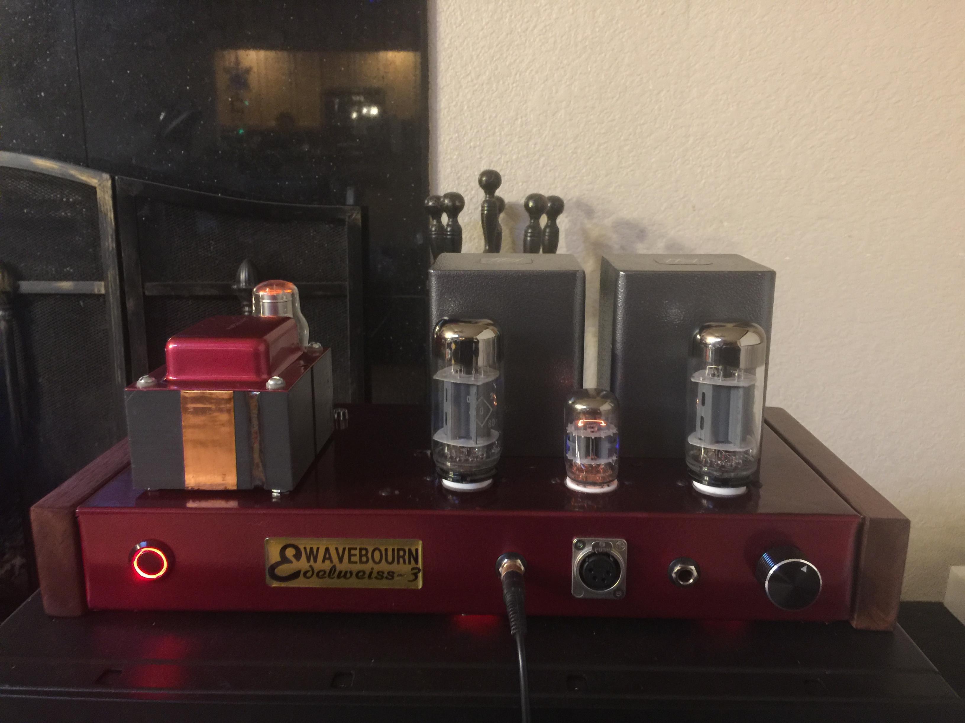

The first basic Edelweiss-3 sold to a buyer in UK, selling the next one, with more optimized internal layout:
Wavebourn high end vacuum tube amplifier prototype Edelweiss-3 (Basic) | eBay

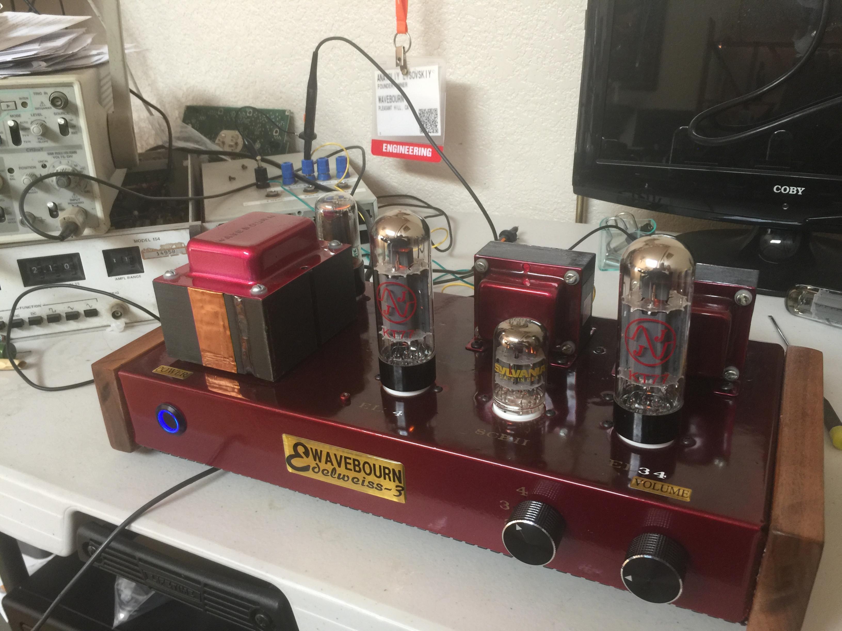

Leave em blue would be my vote. But I suppose you should ask the customer
His e-mail bounces back, so I attached the picture here.
