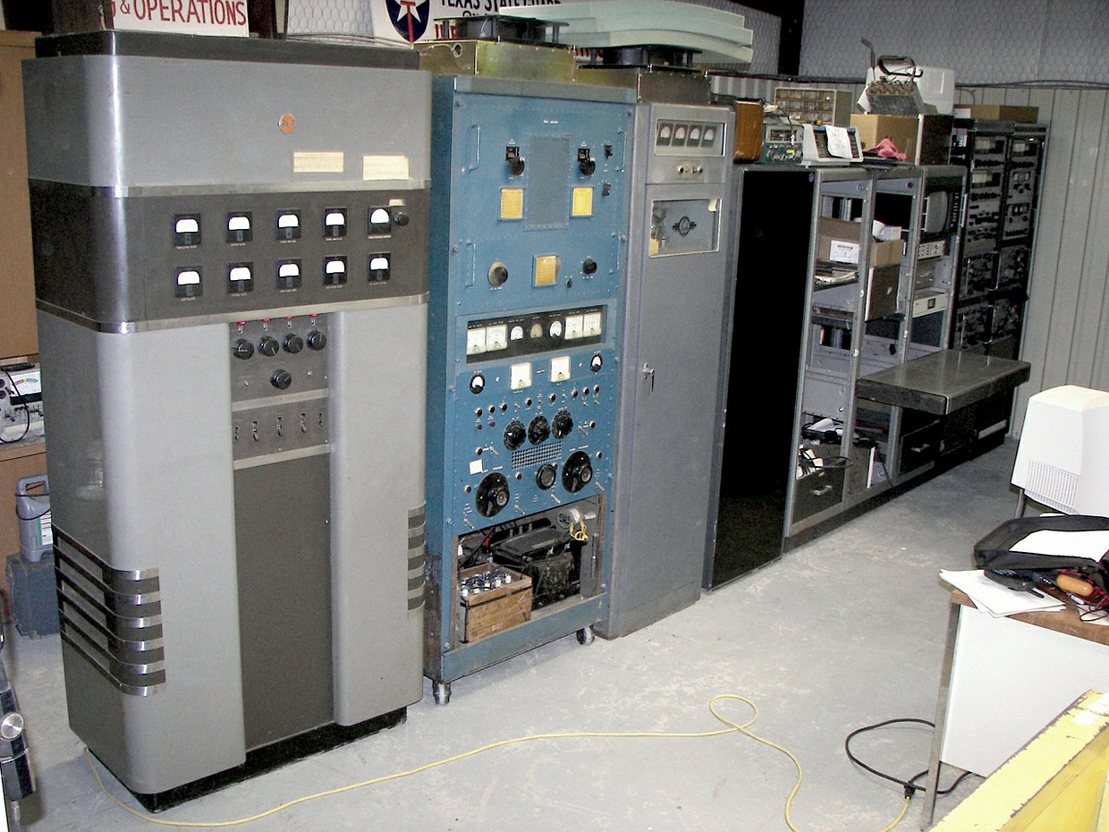

What exactly will you be using the mic for? I was unsure if you were using the mic for ham radio or if you were using a ham radio mic for something else.
Getting a hifi full range mic is pretty pointless for communications uses. Try running a 100Hz signal into a telephone and nothing will come out at the other end of the line.
If you are making recordings, that is a different matter. And it matters if you are recording human voice speaking or singing, or if you are micing say a guitar amp speaker or an organ Leslie.
Phantom power is alive and well, a good quality mixer would be naked without phantom.
When you say directional, assuming you want the mic to reject sound from the rear and off-axis, look for a "cardioid" pickup pattern.
Ok, well think I derailed the Icypro's thread a little, didn't mean to, it seems he is doing hi-fi stuff. So I'll just explain why i need a good mike and that should be it.
To make a reasonable communications bandwidth without amplitude or frequency distortion becoming a big issue, say to do 200hz to 3000Hz, it is necessary to have an audio chain that will do at least 50Hz to 10KHz.

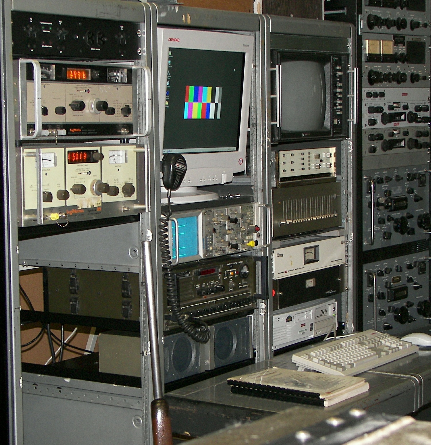

Almost all my ham radio activity is AM and use tube stuff. This includes building some of it because even on the used market it's high. I build tube stuff but never any mike preamp except a 1/4" jack thing that was also for guitar for a friend. The pic. shows I still have some building to do in the low level audio department.
Directional to mostly pick up my voice, not so much noise from the blowers in the transmitting equipment and racks, etc. I want the mike on a boom facing me, and to speak at it from an average distance. I'll use a compressor to level the output.
Bad audio sounds real bad on AM. In this situation, I do not want the cheap mike to be the limiting factor of the communications-quality passband. Good audio, flat and undistorted, from 200-3000Hz, is very important to me and the first thing in the chain is the microphone.
The results others have achieved in the AM part of the ham radio hobby show that it is not pointless to use a good quality microphone and to use equipment that is at least as good as "AM radio station" equipment, some of which they build themselves. It's completely reasonable. so anyway that ends my sidetrack of the topic and I'll read those resources.
