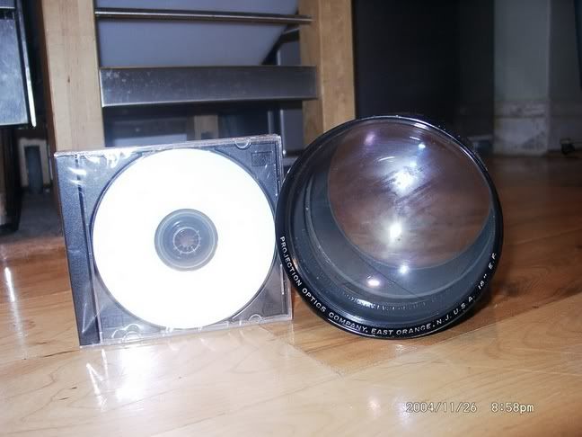

Then there is that as well;
Projection optics company, east orange, NJ USA 18" E.F.
as this one;

hello to truth fully say im a nooby here i have built a projector already and am ready for a new project i have just pict up a CHARLES Beseler COMPANY, EAST ORANGE, N.J U.S.A. 14" E.F. lense well i have the intire projector all the lenses r in good shape now will thise lenses work for a 15 lcd project
should i use all the lenses
the condensing lense is a monster
please some help in design would be appreciated i have posted some pics in another post in this section
ive been following your threads on focal distances and all of the math its pretty complex for me right now
