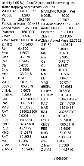

I’ve waited to post you until now and sorry if Im late, because I’ve been looking for a measurement I made years ago.
Now I’ve found it and this will hopefully show you a proofing of my statements I just made above.
See the picture 1(3) where the driver is about 95 % screened, leaving 1 or 2 cm^2 area open at the binding posts and all the affected parameters that will change and thus thereafter, will not apply for T/S values anymore.
What I’m proposing is a method (acoustic dampening) that is not screening the rear of the driver and that is conserving the properties of the air volume, a volume that only acts as adding an acoustic mass attached to the cone, and in a equivalent electro acoustical scheme will appear parallel with new acoustic resistance (the resistive dampening) that when transformed, is in series with Ras* that causes a driver Qms to a lower Qm.
Not as stated above, attaching an acoustic reactive compliance together with a port with its acoustic properties as will be if just screening or partly covering with cloth with unknown properties.
*In the mechanical view (equivalent) this is equal to an increase the Rms value that will modify Qm (Qms =1/Rms x sqrt (Mms/Cms).

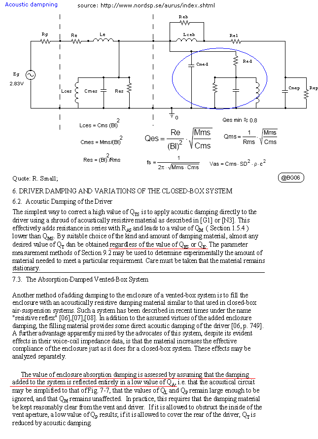

Look at picture 2(3) for the electrical equivalent schematic of a driver that uses acoustical dampening and is in a ported enclosure.
Red is the air resistance that appears and is the acoustical dampening and Cmed is the air mass trapped between the cone and damping material*, that must be attached in a way that not acting as a screen.
The unmarked components is what will be added if the damping material is not secured or what is the equivalent that must be added to the schematic if the damping fibers are moving.
You shouldn’t arbitrarily just attach fibreglass battings and staple them to the baffle or use several layers of cheesecloth’s if you don't have acoustic material measurement equipment like a tube absorption meter in your workshop so you can verify that your acoustic dampening is resistive within your low frequency application bandwidth, thus a secure measure taken in order to avoid to clogging and not just screening your driver to something unknown.
*The damping material fibres, inexpensive fiberglass type is recommended (density = 20(+) kg/m^3) and must be carefully applied with the fibers as perpendicular as possible to the rear side of the cone and also to the baffle where its glued.
It takes some DIY time to orient the fiber pieces into a new battens where most of the fibers are parallel if not a more sophisticated acoustical material is used that surely will be more costly than the few cent for the recommended.
When done correct, a mostly resistive damping material is formed and when used will decrease Qm and also Qt.

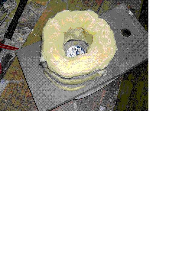

The picture 3(3) shows an application that works and is from a Swedish source where also the most of the content in picture 2(3) is fetched.

Hi Anders,
you're right, proofed by your test. Ron E right, Dan Wiggins right too.
Parallel, series and one coil shorted, Qts remains at the same value. :(

Bjorno, I am very interested in this method if indeed qts can be lowered for any driver. Unfortunately I am not as smart as you and I cannot understand most of your post above, as well as picture 1 and 2. Picture 3 is unclear and it looks like a regular sheet of fibreglass insulation rolled into a circle and loosely clamped to the driver.
Is that right? Is that the method you are recommending?
In the other post you linked to on page 2 of this coversation you said "fitting a 3-4 inch thick cylinder of glass fiber or mineral wool, (1.25 -1.5 lb/ft3 glued Liquid Nail type) to the rear side of the baffle adjusted to completely covering the rear outlets of the driver. The fibres must be oriented perpendicular to the baffle, also letting air to be passed through without any fibre moving.
Fibre-cylinder inner diameter is equal to the magnet diameter and the latter has also some glue on the surface for fastening the wool securing unwanted fibre movement. The length of the cylinder is about equal or slightly longer than the formed cylinder outer diameter."
I'm not able to picture this setup. Is it like picture 3 above? I'm not sure exactly what you are recommending, could you make it more clear please?
