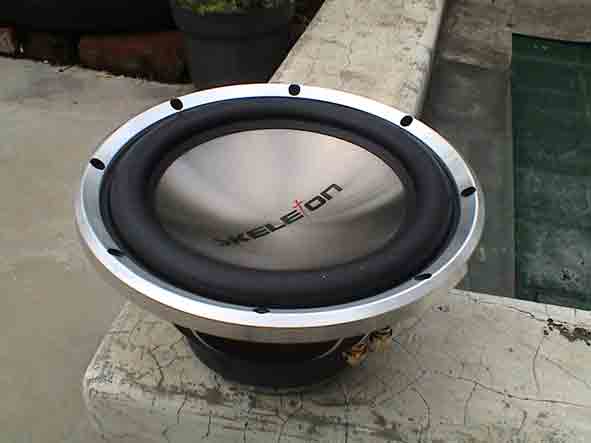

Hi Richie,
here is picture of my driver, doesn't look too nasty, does it?
Anyway, I'm still waiting your measurement technique, as your promise.
Hi Anders,
When no speaker connected, it has almost the same voltage reading at different frequencies.
Picture #2 is a close up of the driver, as you can see, between spider and chassis, it has a gap (covered with perforated steel grille), how if I sealed it off so no air can in / out from there, can it reduce the Qms?
Chris

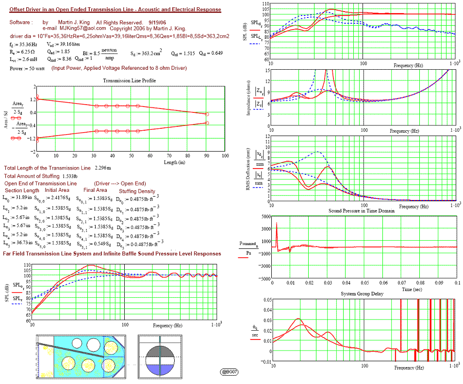

christophorus,
You’re right it doesn’t as long as you do not cover the rear of the magnet that should be of a vented type.
Se my simulation with a driver T/S you submitted in another post the effect when lower Qms from 8.36 to 1.
As long as the cone of the driver is off a stiffer type and the applied damping material is even distributed and secured not to move at all, then this method will work very well with drivers with high compliance.
If you already have an enclosure for your driver, why not practice both methods, i.e. simply first apply Qm lowering damping and if not sufficient; short one coil with resistors between 0 to about the Re value for achieving different Qm-values.
Test with 6.8, 3.9 2.2 and 1 to =0 Ohms while just listening to music on your speaker, if you don’t have measurement equipment, and of course, post your result and opinion of the results here.

Hi Bjorno,
thank's for your very helpfull simulation, it's look promising, but with your acoustic damper, could it really reduce Qms from 8.36 to 1? because when I sealed off the screen, Qms only drop to 7.83 (~ -0.5), but Qes goes up! around +0,4 , so overal Qts didn't change too much...
Does sealed of the screen not enough?
Would you mind giving me a drawing/sketch of your acoustic damper, maybe 1 cross section of the driver can explain better.
