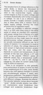

You've mis-understood how a zener diode works.
If the voltage across the zener diode is LESS than the STATED VOLTAGE (ie 24V), then the zener diode will NOT conduct.
If the voltage across the zener diode is HIGHER than the STATED VOLTAGE the zener WILL conduct.
The outcome of placing a zener in series with a resistor is that the zener will conduct enough current through the resistor in such a way that the voltage across the zener will equal its stated voltage.
If the LOAD is drawing sufficient current to drop the neccessary voltage across the resistor then the zener will indeed do nothing.
The aim is to calculare the resistor value so that the load current plus about 5-10mA of diode current will flow through it.
You want to drop 5V with a load current of 100mA.
If we used a 50R resistor then the voltage across the zener would be at its rated voltage so no current would flow through the zener.
If we use a 45R resistor. Only 4.5V would theoretically be dropped across it due to the 100mA load. As the voltage across the zener is GREATER than its stated voltage - IT WILL CONDUCT. It will conduct about 10mA which will cause the voltage drop to be 5V as calculated.
The zener will reach a stable point at which the voltage across it will be equal to the stated voltage.
Zeners can be used in series so that odd values of regulated voltage can be produced.
The zener is quoted at 5W because it has to be capable of drawing the full 110mA if the load is disconnected.

"...The voltage across the zener would be at its rated voltage so no current would flow through the zener" is the diode misunderstanding.
The 555 circuit seems pointless when discussing the TLE4242.
Sometimes we have to simplify a description to help those understand.
I referred to my copy already. And other refs. I'll simplify by pointing out from the column scan "...the zener voltage depends on current and temperature." The zener voltage is the point where conduction begins, so current can't be absent. By definition, I would think.
A zener only STARTS to conduct once the voltage across it reaches its threshold voltage.
Below the threshold voltage the zener doesn't conduct.
It might pass a tiny leakage current but to all intents and purposes it is open circuit.
Zeners are prone to drifting but this is irrelevant in this threads application.
A Zener passes a little current when the applied voltage is at or below the marked voltage.
If you plot this current vs applied voltage you will see it rises from zero at zero volts to a value ~2% max current rating @ ~80% of the Zener marked voltage.
After that the I vs V plot curves around the knee to a new slope. This high voltage slope gives the dynamic impedance of the Zener. Small changes in applied voltage result in big changes in current on this high voltage slope. I normally recommend that the minimum Iz be 10% of max current rating if one wants to avoid the "knee" in the I vs V curve. But many Zeners can operate down to ~5% and still be just clear of the "knee".
