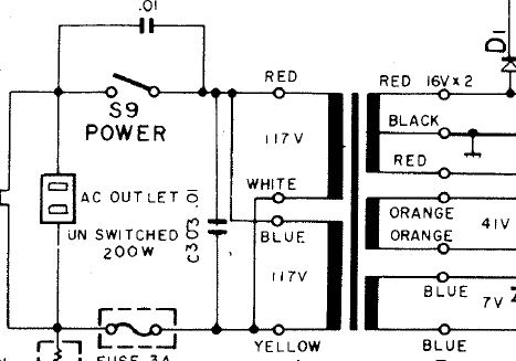

I pulled a transformer out of a Kenwood KR-5340 and I want to use it in my own amplifier build, but the wire is kinda weird. I can't really find much info on transformers that are wired like this one. I think it has 1 primary and 2 secondary connections, but one of the secondarys pushes out more power than the primary.
I also want to buy an off the shelf power supply too, but I don't know what will work well with this transformer.
I measured the voltage on the output.
- red to red = 35v
-black to red = 17v
- orange to orange = 45v
- blue to blue = 7v
I have a pdf of the schematic that's hopefully attached.

It looks like a pretty common transformer type.
Two primaries so it can be wired for 110 or 220 volt supply
One center-tapped secondary (Reds with Black CT)
Two other secondary windings.

Hi
What is your supply voltage? 110 or 230?
For a 110v supply you should wire red/blue to the phase (+) and yellow/white to neutral (-).
If you have a 230v supply you should join white and blue together and protect them in a blank connector , connect red to Phase (+) and yellow to (-).
Your output voltages look to be correct.
I would put the fuse on the incoming phase (IMHO) not the neutral as shown on the schematic.
Hope this helps

Yes your transformer can operate at both 120v and 230v. As mentioned before, its just how its wired.

Ok I looked at the basics a little and it looks like I wired the power input in parallel so I should hopefully be fine, unless more amperage is going into the transformer than needed.
