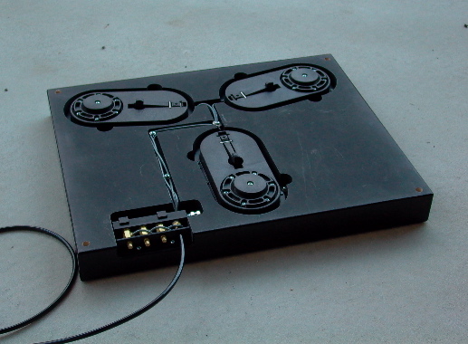

But I don't look in any way to the analog front end and I'm selling my TT. I tried soft suspention based on sort of foam pillows, but hard suspention provides more authority and definition in lower end of spectrum, and if suspending platform is chosen properly the rest of spectrum sounds fine as well. By that I mean that the signature of anything you place under the player is detectable sonically. I achieved good results with combination of spikes, acrylic feet, granite/blown rubber sandwich, sand box. But recent addition of pneumatic suspention changed my views on what is possible. It's just much more coherent presentation, if I use proper words. The main thing is almost unlimited and unrestricted extention of high frequencies, which are simply uncolored.

Peter can u post a picture of your suspension? I`m not quite sure how to interpet it. I think it also differs where you put the suspension; directly suporting the drive, or as a buffer, beneath.

And here's the pneumatic platform.
