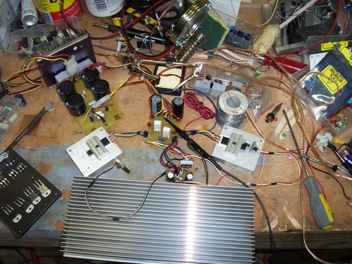

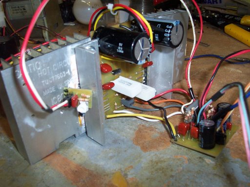

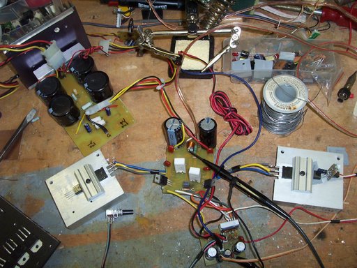

a couple of pics of the amp
here are a couple pics of the amp, and the output wave on the oscilloscope, im going to build a new board to fit the output transistors horizontally,with about 2 pairs of output transistors each. could be too much heat. but ill find out.im a try to fit may be two or three of these amps on the large heatsink.
