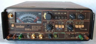

I finally used the line level input of my distortion meter with the low pass 30 Khz filter and tuned the pot to give me the lowest reading. That reading was pretty much factory set. I'm not sure if this is the way to go. Can anybody show me what the pattern on my scope should look like doing this alignment?

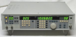

Separation is checking alternate channel leakage. Set the FM generator to 1 kHz 68.25 kHz deviation for the left channel only. Measure the tuner right channel output and adjust for minimum 1 kHz output. Repeat with generator tone set to right channel and measure the tuner left channel. Adjust so that there is balance in the minimum output for the both channels. That is, driving the left and then driving the right channels should produce similar output amplitude.

I used both of my ac meters hooked up to each channel and switched from left to right and was able to get it!

You are correct about the distortion meter that when I turn the pilot on the generator off, the distortion meter level does in fact drop off to zero so I think that with the low pass 30Khz filter on the distortion meter, I'm actually able to minimizing the 19 Khz tone.
