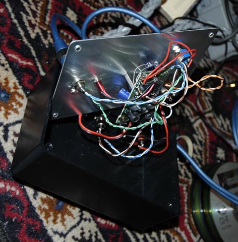

I recently modded my SI T-Amp. I reboxed and did the Stealth mod to the input caps using 4.7 uF caps and a 100k Alps Pot. I also put a 1000 uF cap on the onboard power tap. It sounds fantastic, but, there is a small problem. When I turn the pot, down (from max) it sounds fine until about half way. After halfway down, the left channel drops in intensity and the right channel stays at the level it is at half volume. Once I turnthe pot all the way down, there is no sound in the left channel and there i still sound (not very loud) coming from the right channel. I have been trying to figure out where I made a mistake and am at a loss. Any help would be greatly appreciated.

Anyway, it ended up being a stupid error on my part (as they always are) I went back and looked at the pot and saw that I had not connected the jumper from back pin to front. I put the jumper in (it is a ground jumper) and all problems ceased.

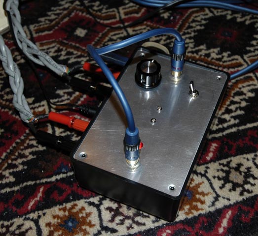

Here is a picture of her. Probably the ugliest t-amp around but I find her kind of sexy.
