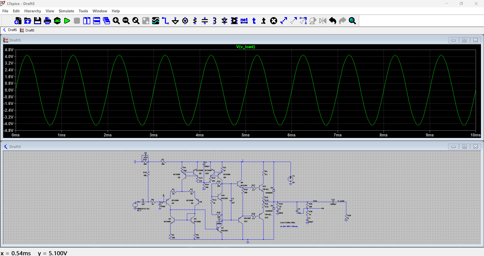

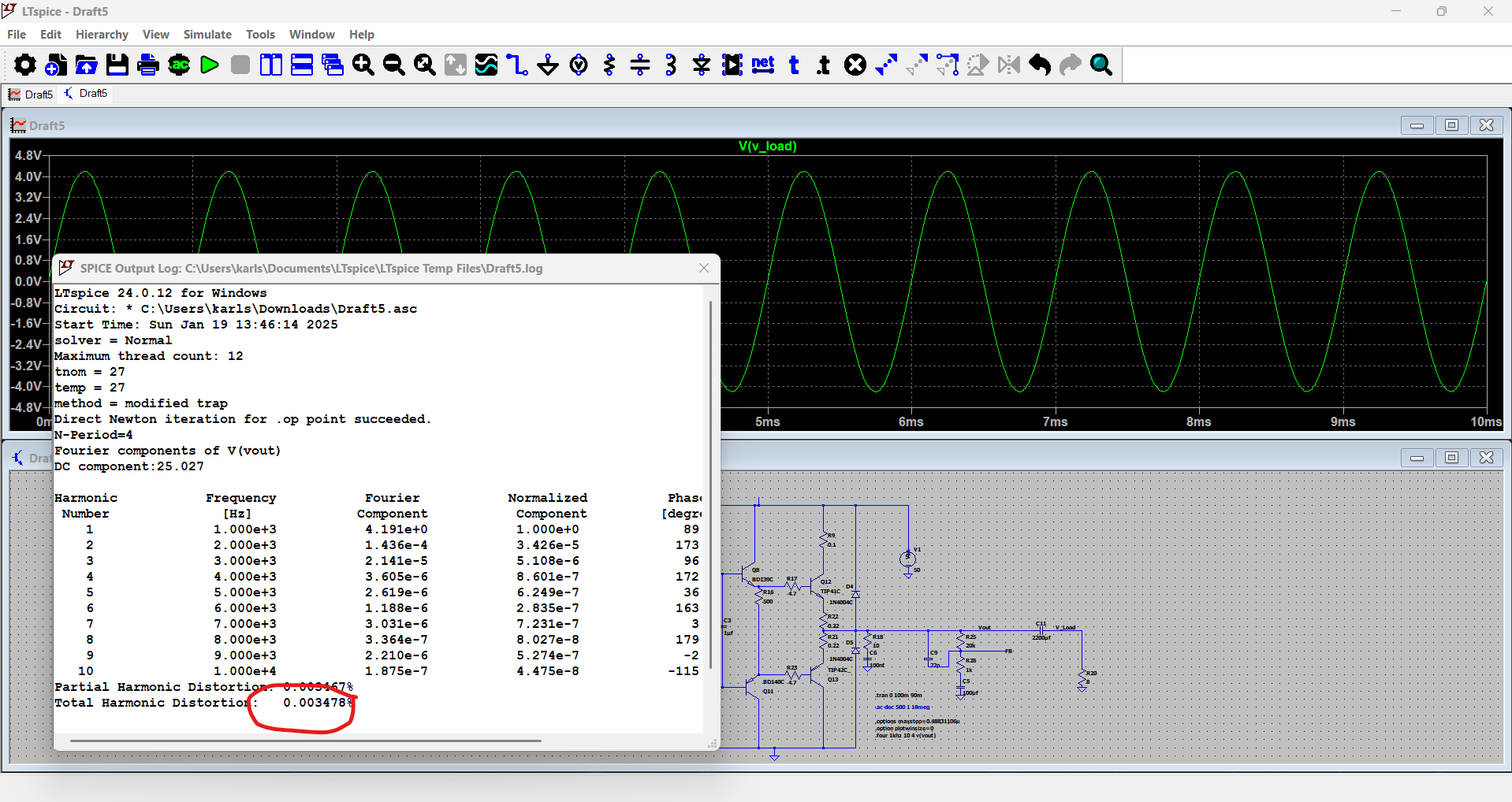

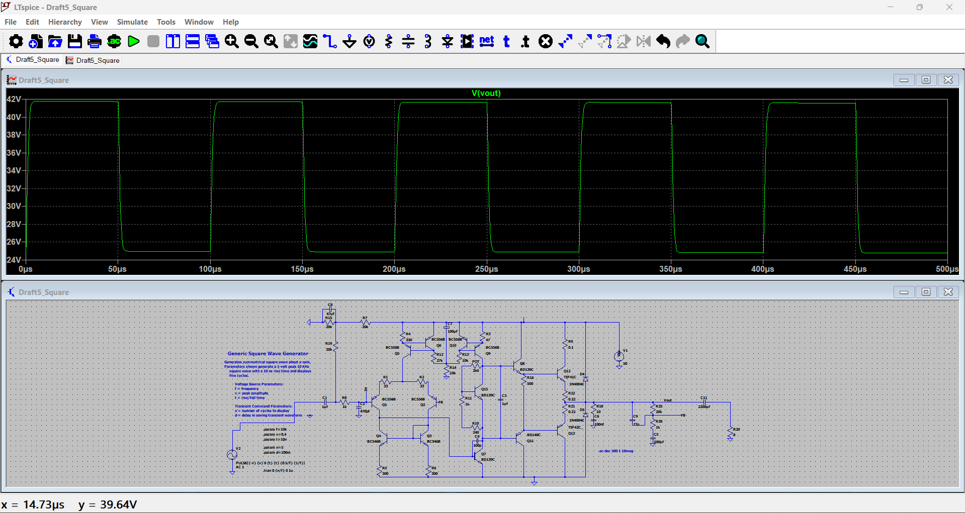

Thanks 🙂 So its not bad at all actually. This is the response and phase response, squarewave at 10kHz 1 watt into 8 ohms. A few changes. You don't need R9

Thanks for the analysis Mooly! R9 is not in the schematic i wanted to check something in the simulation and forgot to remove it, but it isnt present in the actual circuit board. Also may i ask how you came with the values for R1 and R2?
The easy way for those emitter degeneration resistors 😉 they looked far to high at 330 ohm. I didn't try and calculate anything. Its all very tweakable and the current you are running the input pair at seems perhaps a bit low (R4 value will change that) but these are all things you can thrash out in a simulation.
