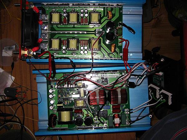

Manufactures uses toroids for inverters because they are thin, not because they are "better".
Here is a picture of a 3500W inverter with 6 EFD type transformers. This allows them to keep the case thin.
yes inverters have much higher voltage than car stuff ( stacked in series I believe so creepage is still a concern )
