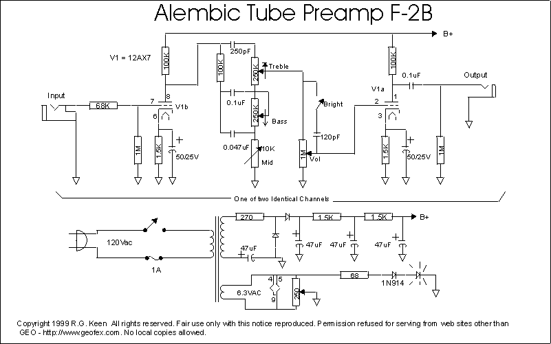

I want to start out with one just for guitar. I'm wanting to use the output to go into a solid state amp. It would have only one channel and i would want it to be as simple as possible seeing as i have no experience with this what so ever. I do have all the sockets i would need from some broken amps and a few transformers from a Hammond amp out of an m3 but i doubt those would be useful.

This is my first project doing anything like this at all really. Im looking for a step by step and a list of parts i need. i feel really stupid not knowing what im doing lol.
If theres any site anyone knows of like this or can explain themselves that would be great.
I think the closest you can get to step by step is the ax84 p1 amp at ax84.com . I have not seen a step by step for just a preamp, but you can easily modify the ax84 p1 to be just a preamp by excluding the phase inverter and power stage.

F2-B
I'd suggest Alembic F2-B preamp -
It's very simple, actually it's Fender Twin preamp section as a standalone unit. For power supply you may take two 6V transformers (1A minimum) wired back to back.
If you take two 6V trannies for the PS don't follow the schematics power supply, but do something like this (look at the power supply section) -
(it's something based on the F2-B I've done some time ago and play through it all the time)
if you plan on 12AX7 it's better to use 6.3V (not 12V) heater so you need a proper voltage regulator (like 317, look for the datasheet to see how to wire it).
