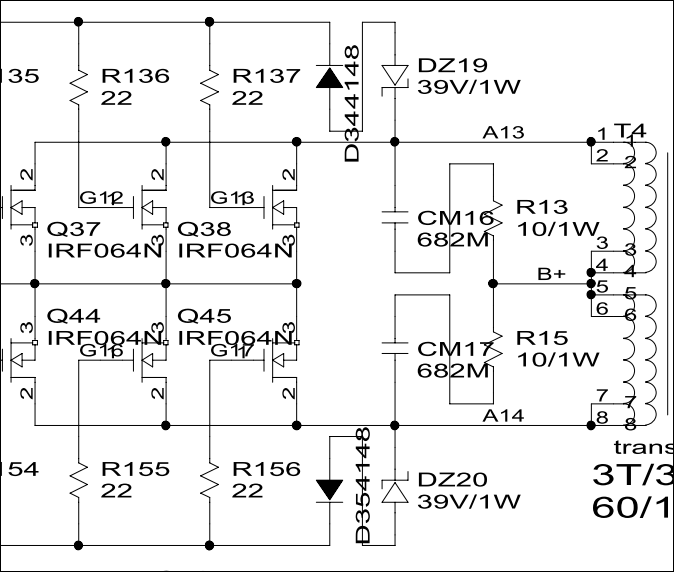

I need help identifying parts on a generic Korean 5k board
Joined 2024
I am having trouble identifying a diode that was physically burned by a cooked power supply mosfet. I could not get clear photo of the diodes in the power supply section but it looks exactly like D3 in the photo, no numbers just black on one end and a thin gold stripe. It has .6 voltage drop one way and reads open when I reverse the leads. I was thinking it’s a 4148. Any thoughts?
