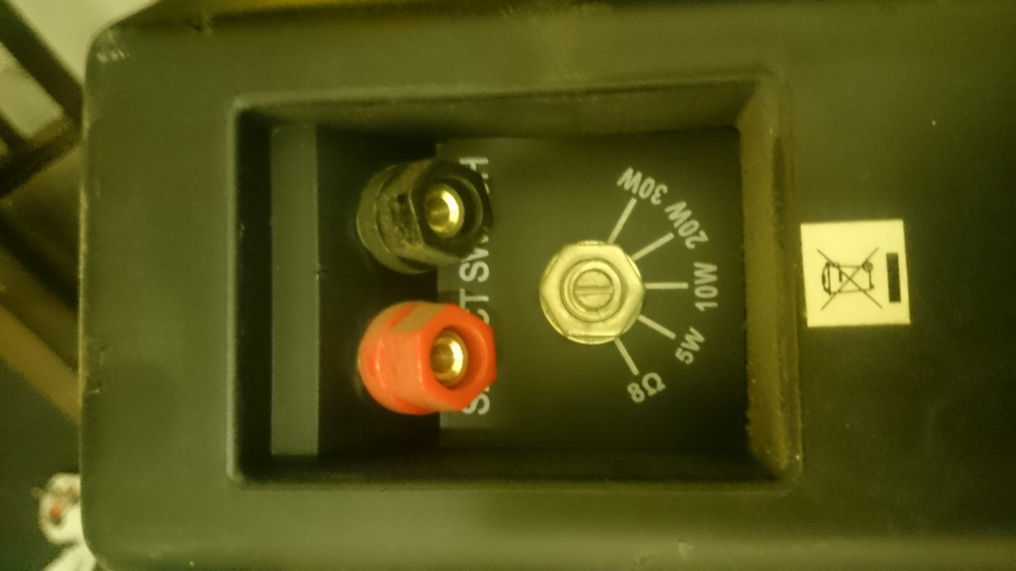

Hello, i dont know much about sound, i need to get an amp to drive a few speaker i have, first thing i wanna do is to use 2 speaker i got to connect them to my tv, these speakers are 10 watt 8 Ohm BUT i wanna keep using the tv speakes too, my tv has a toslink output, for all i know this optical out doesnt switch off the buildin tv speakers so i wanna use that output OR the hdmi from the source output to and amp to does speakers.
Next thing i wanna do is to use a few speakers a got, these are made by "SKY" and at the back it has a switch that let me select (8ohm, 5w, 10w, 20w and 30w), any help to get an amp to drive these speaker would be great...

sounds like you have speakers with built in 70 V line transformers.
are you looking to purchase an amp with a 70v line output or are you going to bypass the transformers?

For multiple speakers of undetermined number, the 70 vac system was developed. This allows one to pick different wattages of the speaker to make one spot louder or softer. It also saves on wiring, as 8 ohm speakers require fatter wire than 70v at long distances. 16 ga is usually fine for 70 v systems. mcm again has some inexpensive low powered 70 v PA amps.

If the op is going to use "a few " speakers on the same signal he needs to use the various 70 v system switch positions. I he sets more than two speakers at 8 ohms and hooks them up parallel on the 8 ohm amp output, he will blow output transistors on most cheap amps. If he hooks up 3 or more speakers in parallel at the wattage settings of the switch, and uses the 70 v output of a PA amp, he just has to keep the sum of the wattage rating of the several speakers < the wattage rating of the amp. Then every thing should be fine. 16 ga zip cord will work okay.
