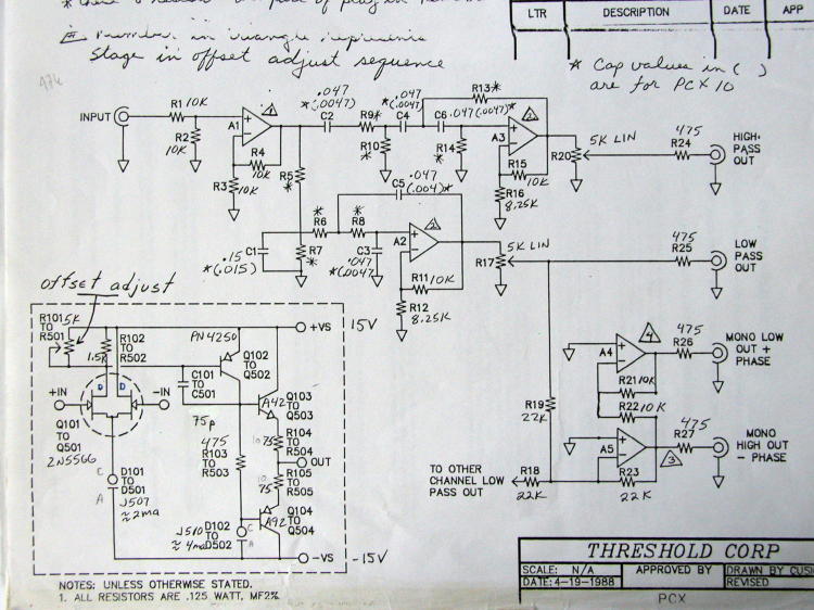

How could one get a hold of the schematic for the xover you are referring to. I have not seen or heard of them. Pictures would also be great. thanks.

HPotter
What is the note referring to the * cutoff at the top of the page?
Also, what does the line above the word "stage" say?
Finally, do you have any other info that goes with this unit/schematic (adjustment procedure/specs, voltages, etc)?

8 resistors with * are in a plug in module. Caps values in ( ) are for frequency x10. The numbers beside op amps in triangles are for offset adjustment sequence. Voltage is +/-15V. THD is .01%, slopes 18dbs, inp imp 20k, output 1k5 ohms.
Resistors values for 90Hz are 39k ohm, for 160Hz - 22k ohm, for 904Hz - 3k9 ohm. I guess from that you can calculate any other frequency. All 8 resistors have the same value.

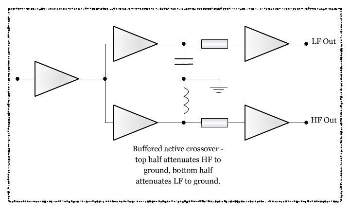

I just had this idea for an active crossover that has no phase incoherency - it's probably flawed as I only have very basic knowledge.
It's basically just a series of buffer stages (optionaly with gain control to equalise) that have either a low or high frequency low-impedance ground connection.
As I say it's really basic - so much so that it's probably seriously flawed.
<center>
</center>
One advantage I could think of is that it could be op-amp based for simplicity or fully discrete whatever you prefer.
Please don't laugh if it's a stupid idea
