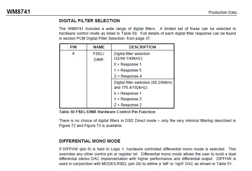

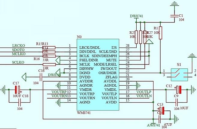

I need a very good fet line preamp circuit for wm8741 dac. The WM8741 have a voltage balance output.
I include in my post the circuit of the wm8741 dac.

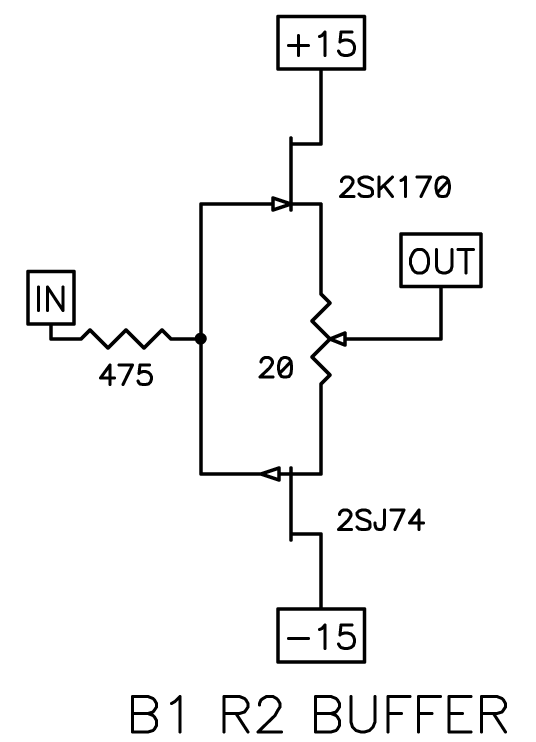

Having gone through the 66 pages for that part, and relying on Fig 83,
I think you would be well served by the classic buffer like the one I use in
the revised B1. It measures below .001% in the regions of interest, the
potentiometer can be used to neutralize or enhance 2nd harmonic and the
input resistor can be played with to minimize unwanted response to high
frequency digital noise.
:cool:

Hello
I did see your fet buffer, but I would need one with a balanced input and unbalanced output.
Thank and Merry Christmas
