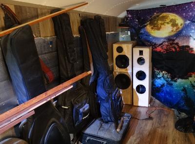

OP here... I had forgotten this thread lol. The big two ways are amazing! I did finish the speakers, but still have final sanding and paint for part of them. I designed them with changeable side panels. For a never ending change in appearance. They came out very nice, but waaay heavy.

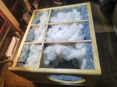

My only regret is how heavy and big they are. TOO much to ship. So now to make room, I'm trying to sell them cheap. But in my community of only 6000 people, cheap is relative, lol. I may own them forever, barring a local Californian wanting to meet me somewhere, lol. At least they sound great, with their huge roundovers, 1.5" BB plywood walls, and exte sive bracing. Reworked xovers helped too

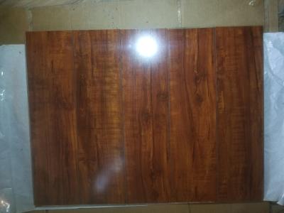

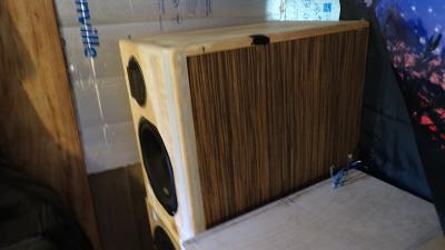

All the photos I have are unfinished ones like these. I'll try and get some finished photos next week. They are hard to move around for photos at 63 lbs each. I now have carbon fiber side panels, aged copper side panels, etc.

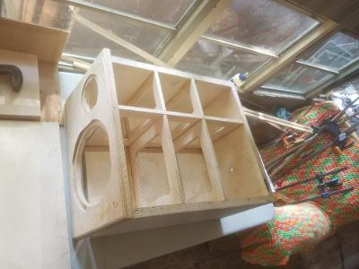

I built new crossovers with quality parts. Used quality wires. Eliminated the PRs, and built identical sized cabinets, same width, but in a 2 way, stand mount configuration. OR optimally you'd place them on bass bins with 12" Kappalite woofers.
They have 1.5 " walls. Weigh a ton, and are 13.5 x 20 x 24"
