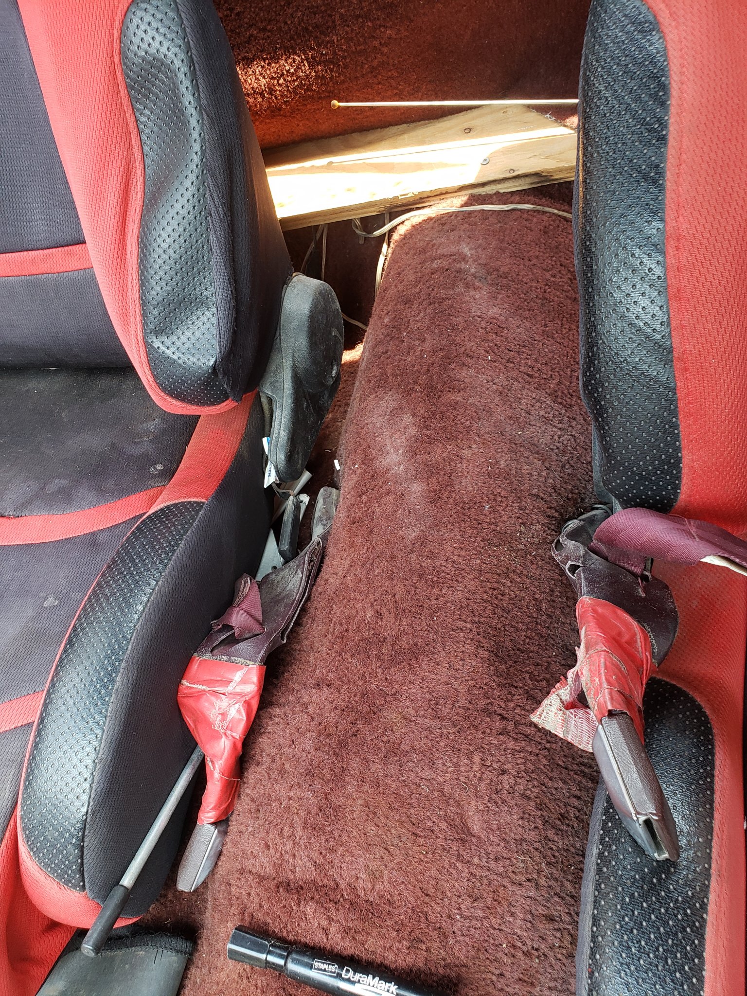

Its for the rear section of this Chevy H-ell Camino console. Attached is a rudimentary plan page I drew up, or threw up hehe, while in stop and go traffic. Complete with coffee stain. A sealed section at the very rear indicated by the dotted line will house this small sub of some kind.
It only has to accentuate a 5 1/4" pair of coax in a car built for street n strip. Too much extra wait, not in the plans., nothing crazy expected, this approach would be wrong from go anyhow. Most important, simply filling bass in audibly with a bit of punch in to the adjacent seat maybe.

The front section will wrap around the shifter and have two cup holders. From the magic marker point on back will be the sub cabinet section, all the way to kiss cars rear wall. I could easily accommodate 2 subs but again to keep weight down. It only has to fill in the lows.
Plenty of times id slide a couple facing bazooka tunes in there, but a console is just starting to push luxuries.
The nasty carpet goes, and seats go, for bolstered buckets. I have to fit those and new rails then ill know how wide go with the cab. I want the seats to hug the seats and look clean.

The Anarchy 6 works well in a center console subwoofer arrangement. The tuning you end up with lands very nicely in the area of cabin gain to carry it downwards to a decent cutoff frequency.
