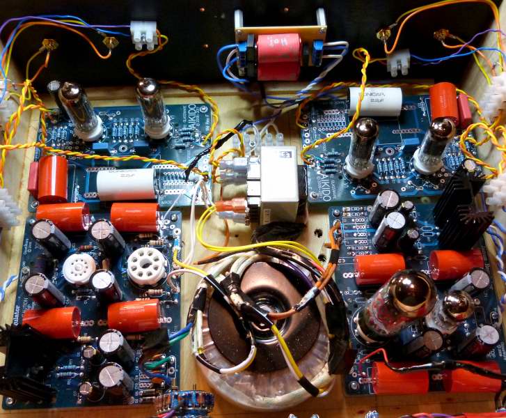

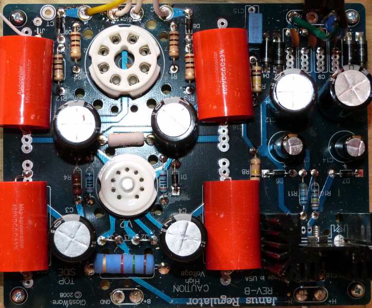

Hi Everyone,
I took some pics of the build and the regulator tubes. Please note the strong mirroring on the tops of the tubes, it's much heavier on one side than the other. Is it possible that overheating could have caused the premature failures ? The top is well ventilated but does get warm.
PJN

Hi PJN,
I seriously don't know what the problem is, as everything looks alright. As such I will propose some things that may sound quite logical and you may have tested already, still...
- have you tested continuity (resistance with DVM) between pins 2 and 8 of the 5Y3? - you said the 5Y3's were cold, so probably filament is broken;
- without 5Y3 in their sockets, measure voltage AC between pins 2 and 8. Remember, from the top pins are mirrored in relation to the bottom. Do you measure 5VAC?

Frankly I would suspect the rectifier tubes themselves. The filaments have apparently opened up which IME has nothing to do with the load current they are delivering.
JJ rectifiers do not have a good reputation for longevity/reliability and I avoid them. In this case your best recourse might be to by some good NOS GE or similar 5Y3GT on eBay. They aren't expensive. (Ham fests are a good source as well if you can find a local one)
You should always have spare tubes, I always have at least several or more of any tube I use in my designs. Current production tubes often fail without warning and will leave you in a music free state if you do not have spares. NOS, or good used tubes may in many instances be better than current production.

Hi PJN,
Both rectifiers going out at nearly the same time, as you describe, probably indicates some other problem in your circuit. I would be careful just plugging in new rectifier tubes, as they may well go poof on you.
I wouldn't expect both rectifiers to blow within a short time of each other. It's possible, but in my experience such things usually indicate another problem somewhere.
Since the original rectifiers didn't blow immediately, you can probably check the output current from the regulator boards, see if it's what you expect it to be.
