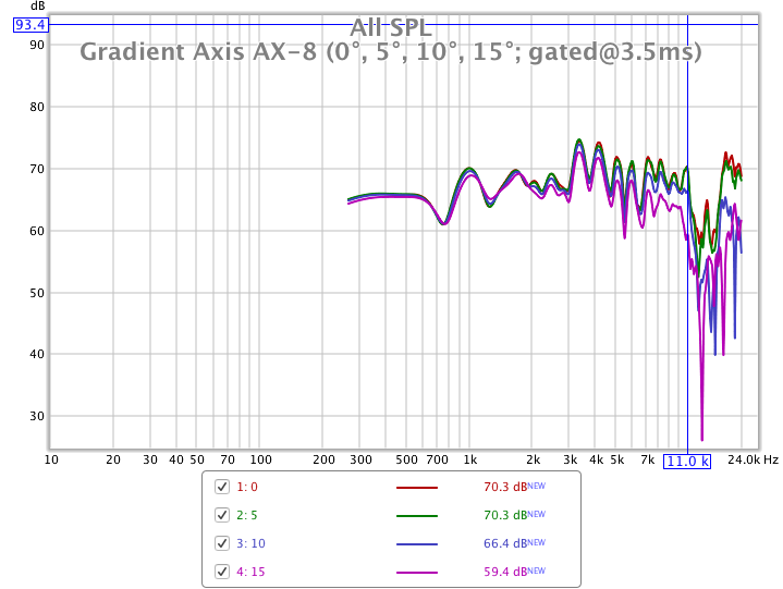

recommended filter for a direct radiator/bvr cabinet uses 3.9mH. I an AX08 mounted in a Karlson Twelve from 1955 its too hot in the screech area. I think the K-application would use less aggressive contouring.
wonder what L value would make a good compromise? can one dispense with the filter across the fullrange>
Gradient 's measurements - no fiklter + filter
Filter values
AX08 indoors at the top of a 13" wide pipe

found a 0.2 ohm dcr 4mH inductor - paralleled it with 3R - not too bad - I think the filter across the driver is there to allow suppression of the 3-5K area per blue curve vs just the 3.9mH/3.3R filter by itself (red curve). The Karlson 12 is smaller than a recommended BVR - still looks big for an 8" driver with an overall external bulk of 3.3 cubic feet.
In BoxSim i had a very good result with R(3.3Ohm)//L(2.2mH,0.5Ohm) in series with the speaker. The RLC is only for the spikes on the 3 and 5kHz region. Maybe you don't have them in a Karlson.
I appreciate the input from everybody and found a 2.5mH coil laying around - that seems ballpark subjectively with getting a balance which isn't "nails across the blackboard" screeching yet doesn't have too smeared/heavy/muddy bass (that is with the cabinet elevated 18" from the floor and away from walls)
