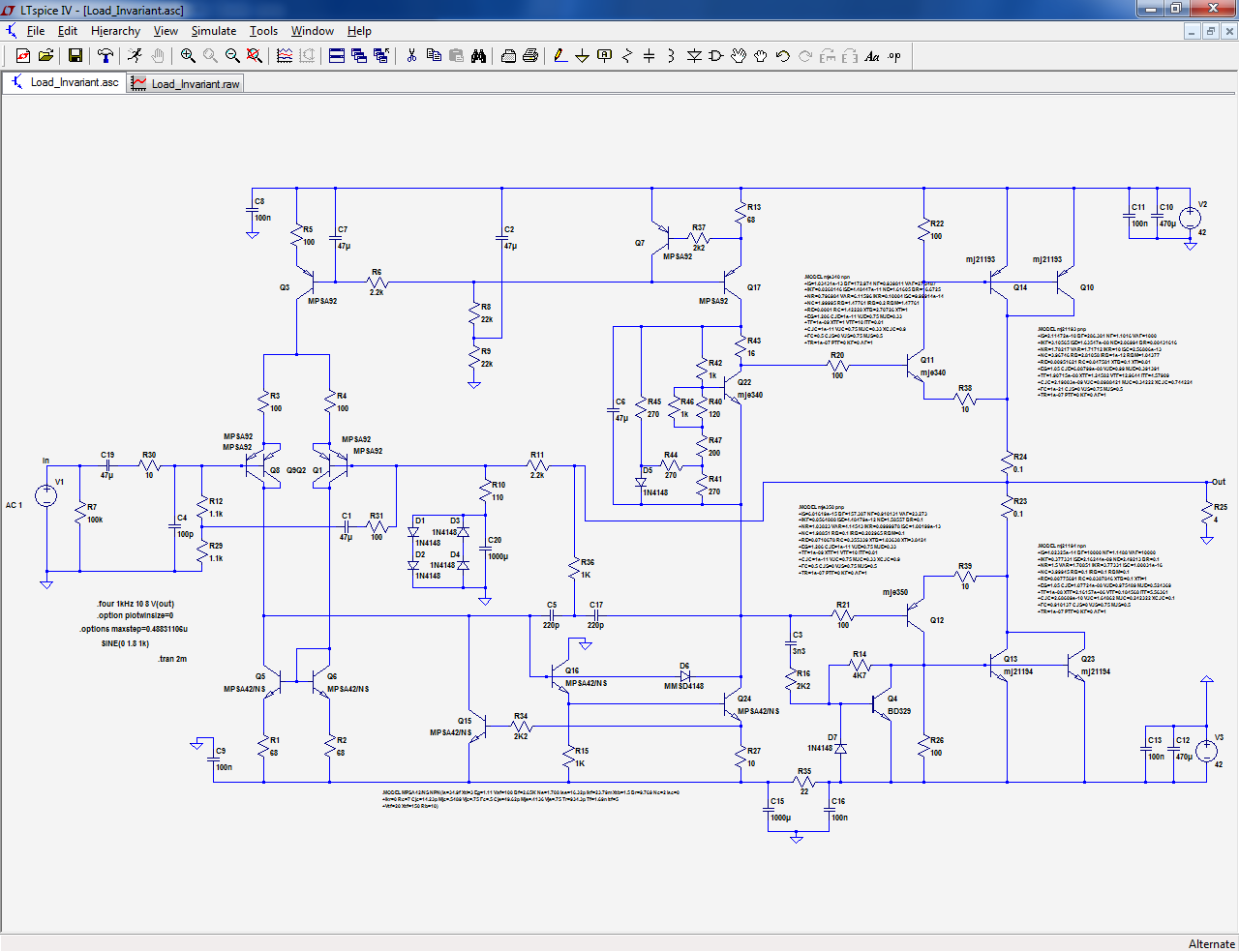

here is the schematic. It is more or less the schematic from D. Selfs Book APAD 6 Figure 10.12. The overload protection is ommited for clarity, as it is not used in the moment. In the simulation the rail sticking due to saturation is also visible, but not the oscillation. Tomorrow I will post some real screenshots from the oscilloscope.
Currently there are two grounds on the PCB - Input (input & feedback network) and power (decoupling Caps). Both grounds are connected by a separate wire to the star point on the PSU PCB. I will try to add a 10R resistor to input ground.

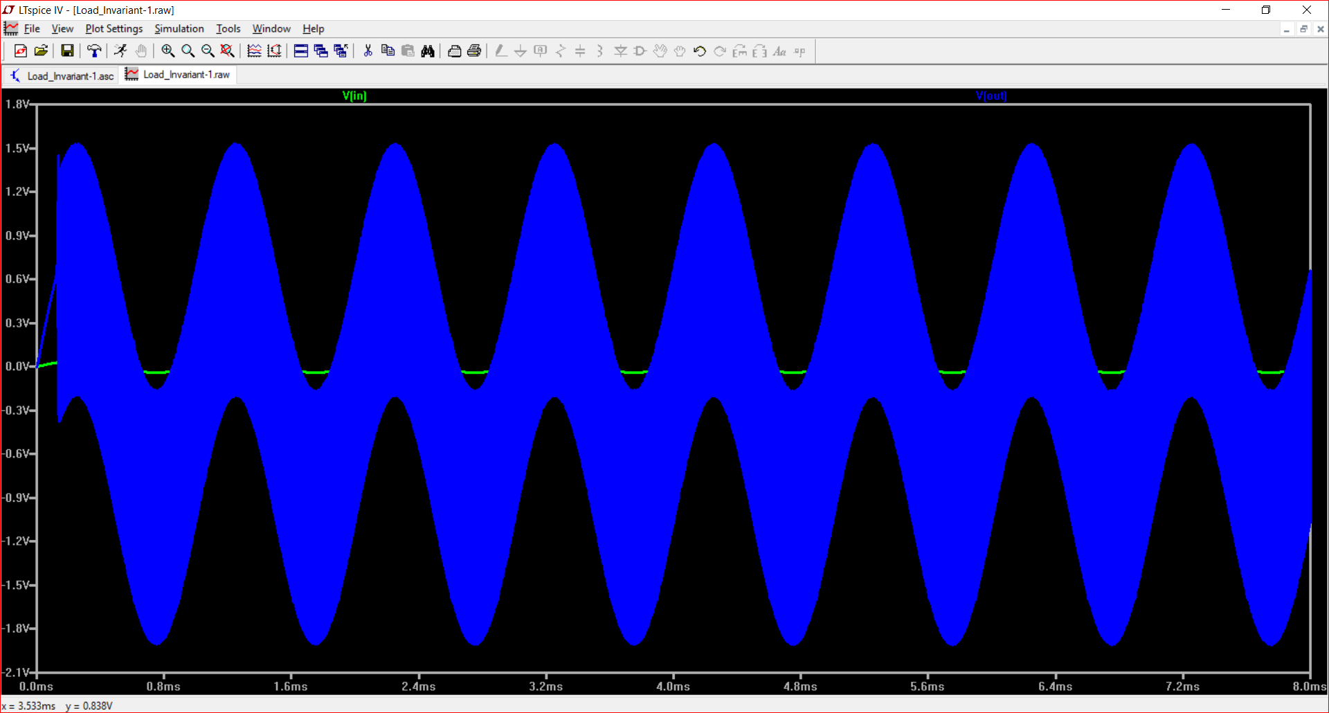

OK here's what I have found so far: the circuit does not show spurious oscillation on negative clipping using 2N3440/2N5416 drivers. With 1uH lead inductance in each of the main wires (+,-,spkr gnd and signal gnd) there is a spurious oscillation at positive clipping. If the drivers are MJE15030/MJ15031 there is oscillation at all points, not just clipping.
It can be suppressed with a Baker clamp on the CCS, and decoupling capacitors connected directly to ground. I used 100uF plus 1mF in series with 1 ohm resistors, to damp any ringing with the lead inductances.
It seems from this simulation exercise that the parasitics are related to the driver transistors, and lead inductances. I note that the circuit shows power supply suppression capacitors, so my guess is that they are physically too far from the output stage pair, or, that the ground connection is not ideal.
With the MJE drivers a 10 ohm resistor was needed in the emitters to suppress the oscillations too. So a combination of trying to reduce the loop gain in the output stage and reducing power supply line impedance at HF looks to be necessary.
Hate to say this ... but simulations look much more stable with conventional Darlington output stage (NPN/NPN and PNP/PNP). If you can't fix the oscillations with degen resistors, decoupling caps and a local earthy link resistor, and 100pF caps on the base-collectors of the drivers, suggest try swapping the output pair around. Will need to change the bias circuit to accommodate 4 Vbe's instead of 2, and use separate emitter resistors for the power transistors. Increasing the values to 0.33 ohms may be necessary to stabilise the quiescent current too, so it won't quite look like the original circuit.
BTW I would also use separate emitter resistors on the input diff pair to ensure equal currents, or you would need to match them quite accurately.
I believe Douglas Self would say that the CFP can be a tricky combination to stabilise.

I wonder if it could be oscillation around the Q16-Q24-Q15 loop? When over-driven and Q24 saturates, that loop would become quite slow.
What if, as an experiment, you opened up the collector of Q15, and then put a diode (1N4148) with anode to base of Q16, and cathode to collector of Q24? You might not want to end up that way, but it would give you some information.
If that worked, I might also try to raise R27 a bit...it says you can pull down about 6.8 times harder than you can pull up. Maybe with R27=33 Ohms, you'd still be ok, and you'd only be pulling down twice as hard as you're pulling up, which would be for more symmetrical limiting drive current, and as a side effect might keep the Q16-Q24-Q15 feedback loop happier if you decided to do that again.

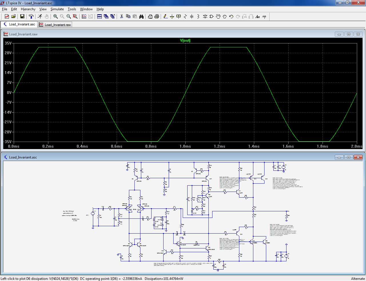

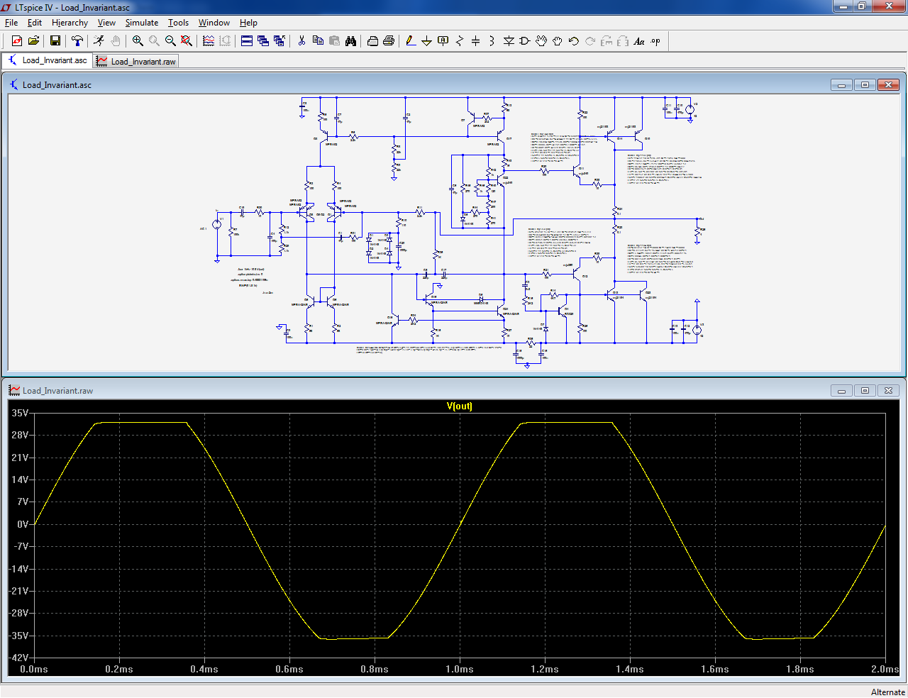

Anyway, I copied the simulation attached to post 20 and adapted this for use with Bob Cordells transistor models - main changes are for small signal transistors MPSA types - these replaced by 2N5551 NPN and 2N5401 PNP.
With added zobel network and series coil//resistor into 8R//2uF - at a glance the 1kHz sine wave looks normal, and the FFT and THD are OK below the level of clipping.
A 1.8 Volt input signal takes a bite size chunk out of the top and bottom of the sine wave cutting this back to 1.7 Volts gives a peak output voltage of 39 Volts which is pretty close to the rail voltage - I settled at 1.6 Volts in the end.
I will look at 20kHz sine and 10kHz square wave into 8R//2uF tomorrow.

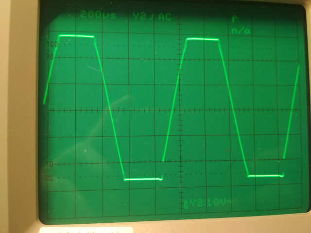

Dear all,
Thank you all for the detailed circuit analysis!!!
The output devices are mounted on a separate heatsink connected to the PCB by ~10cm long wires. The decoupling caps are directly at the connectors to the output devices. I tried already to increase the caps from 220uF to 1000uF on the PCB, but with no effect.
Currently I use a 2x32V@2x5A bench power supply to power the PCB. The power leads are ~50cm long. The supply is no name brand. I should check how the power rails looks like on oscilloscope... Maybe its part of the problem. The final PSU will have +/-42 V rails. That's where the 42V value in the LTSpice simulation come from.
I also switched from TCM (or output inclusive as D. Self calls it) to standart dominant pole scheme. With TCM it looked better. But until know I havent gone higher as 220p for all BC capacitance experiments... Maybe I should check it also with 330p.
The output devices must be in TO-3 package due to custom made casing. The side walls are used as heatsinks. At the moment I don't have any other types available. I will experiment around with all tips and hints you all proposed when I find time for it. If nothing helps, I will switch back to EF output stage. Since 5 years I use a selfbuilt minimalistic "blameless" amp using EF output with the same transistors. It's rock stable. The ongoing upgrade should add some more functions like short circuit protection, output relay etc. The main reason to switch to CFP output was the much smaller quiescient current. Unfortunatelly I didn't make the PCB universal for both output stage types 🙁

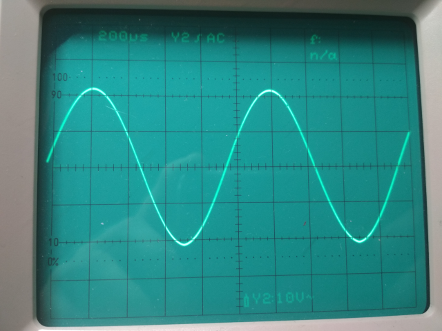

As promised, here comes the few measurements done @1kHz, ~20Vpeak and +/-32V supply.
Just before clipping:

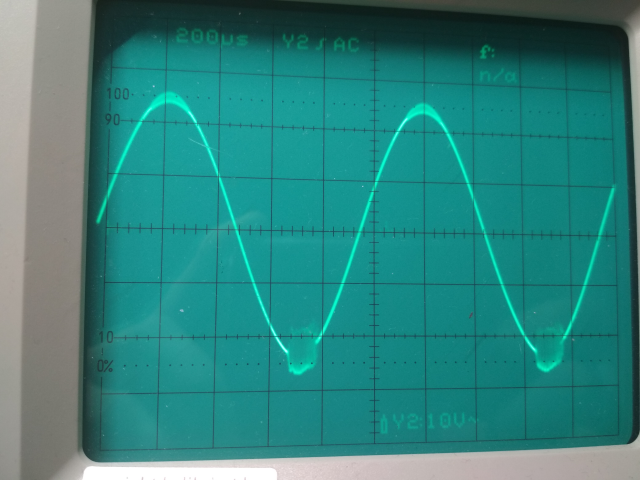

Oscillations at light clipping:

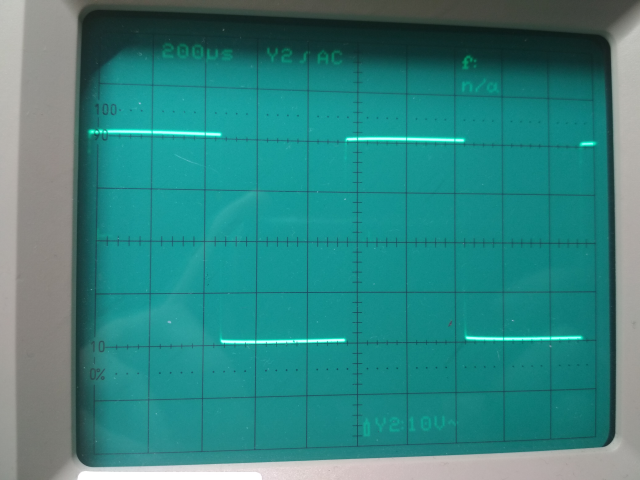

Heavy clipping:

You picked it, the bench supply is a general purpose instrument. Just use it to get an indication your amplifier is working correctly.
Self avoids regulated supplies for power amplifiers - perhaps you can now see why. If you use 42 volt supply rails you could use his output inclusive compensation scheme with the capacitor values he prescribed.
You changed to standard compensation to improve matters with the amplifier in harness with the bench power supply - I think shackle might be a more appropriate word.
