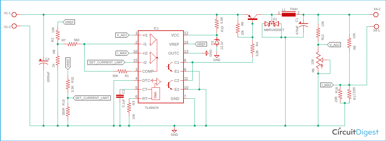

@russc I originally used LM2596 ( ready made board ) it died on 2 amps at 20v consumption. Another board i changed the inductor with a toroid type from a PC PSU ( change windings myself for 47 uH if I remember correctly , as the original inductor, measured it's inductance with an LCR meter .) worked fine , again it died on high power consumption.
Look at the L200 IC. It’s a little more complicated than LM317, but it’s got adjustable current limit and it’s easy to add an external transistor.@stv I wanted to use an ic since it's easier.

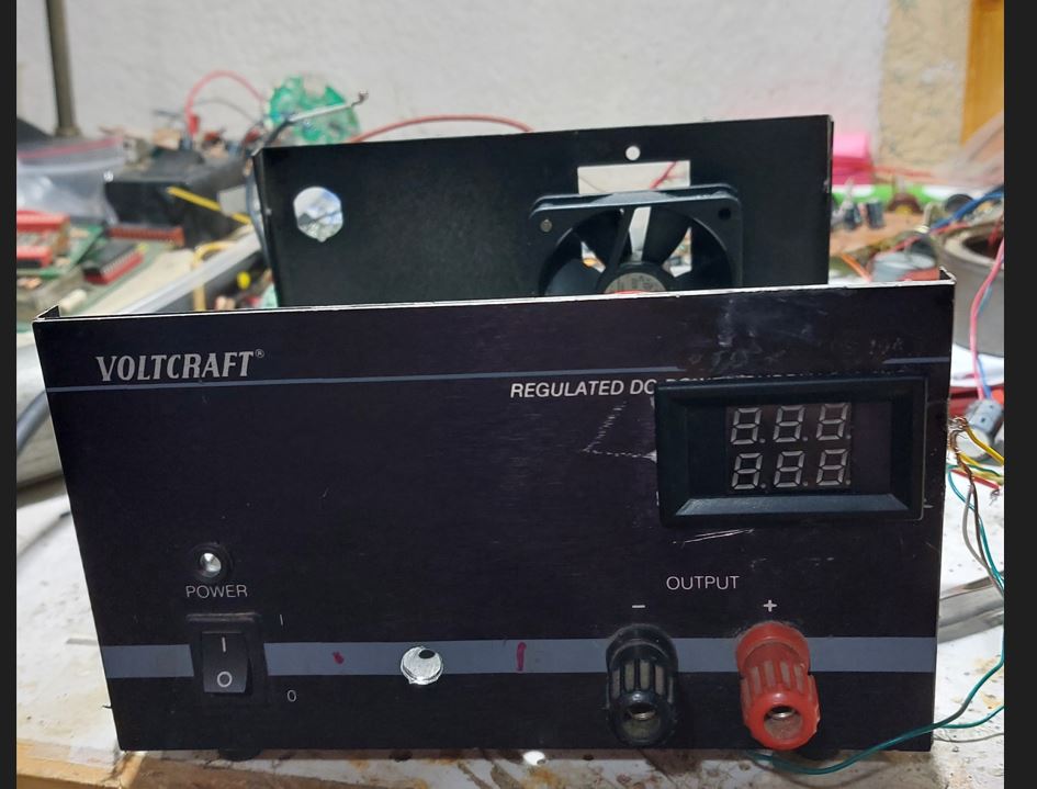

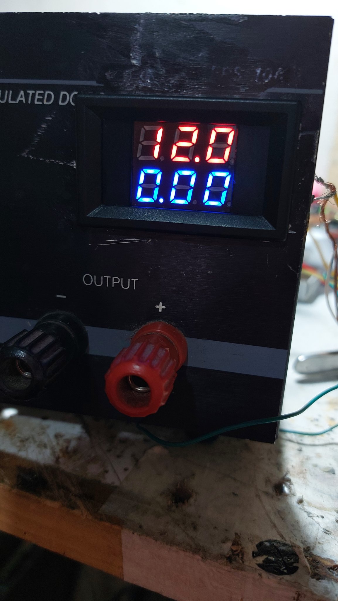

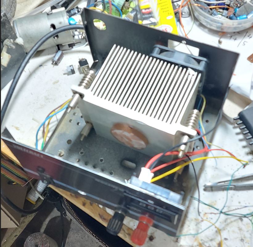

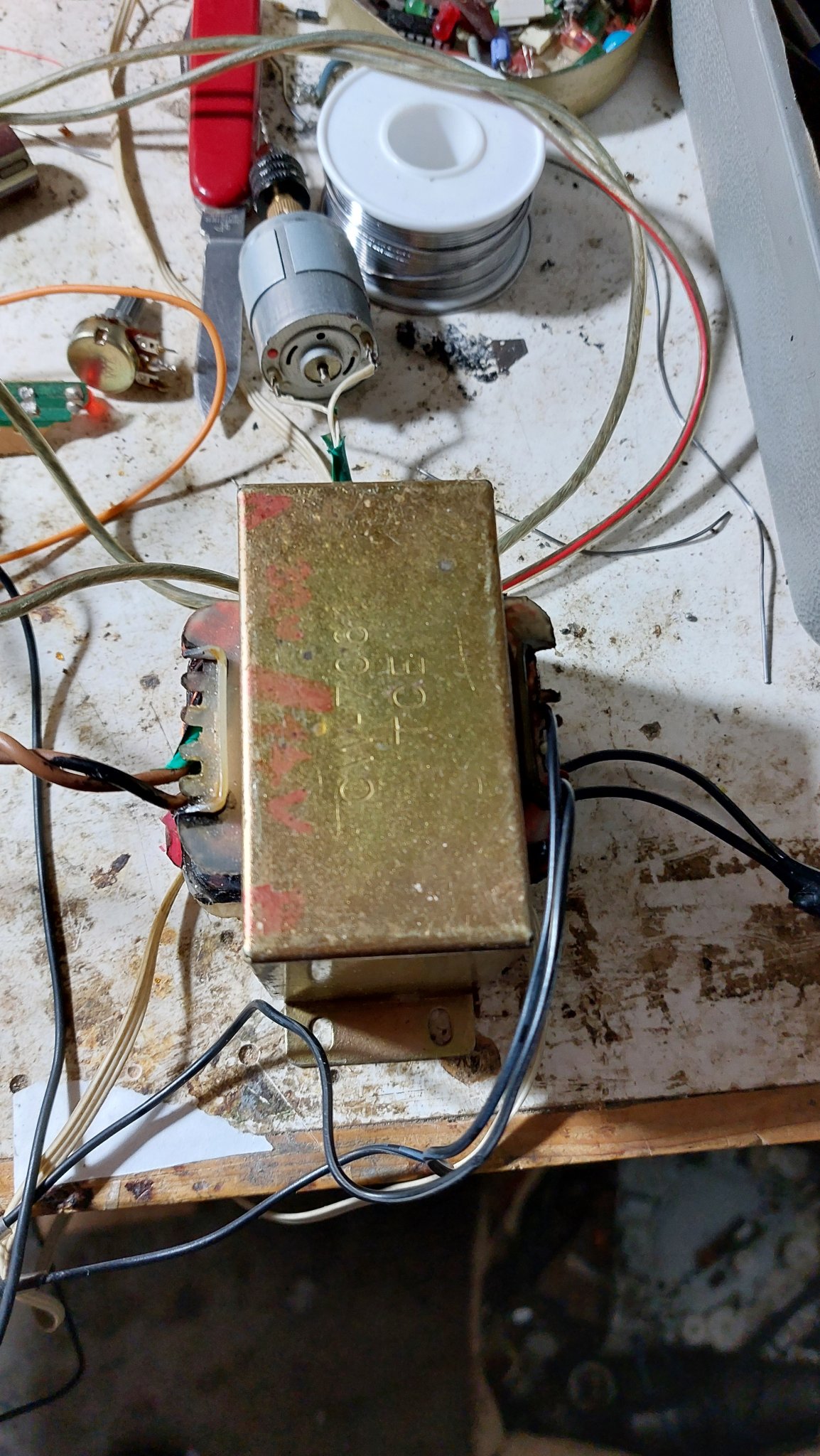

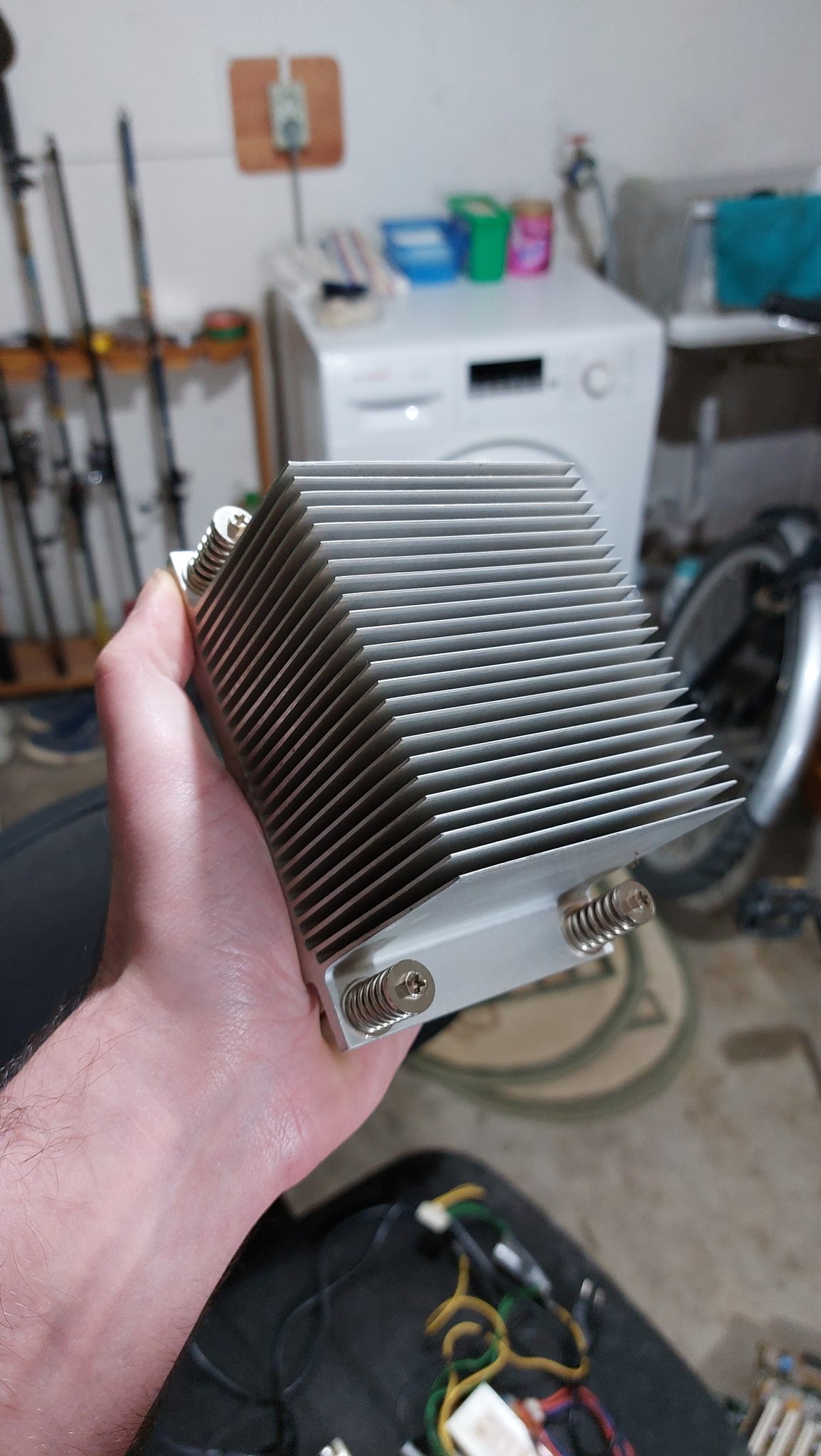

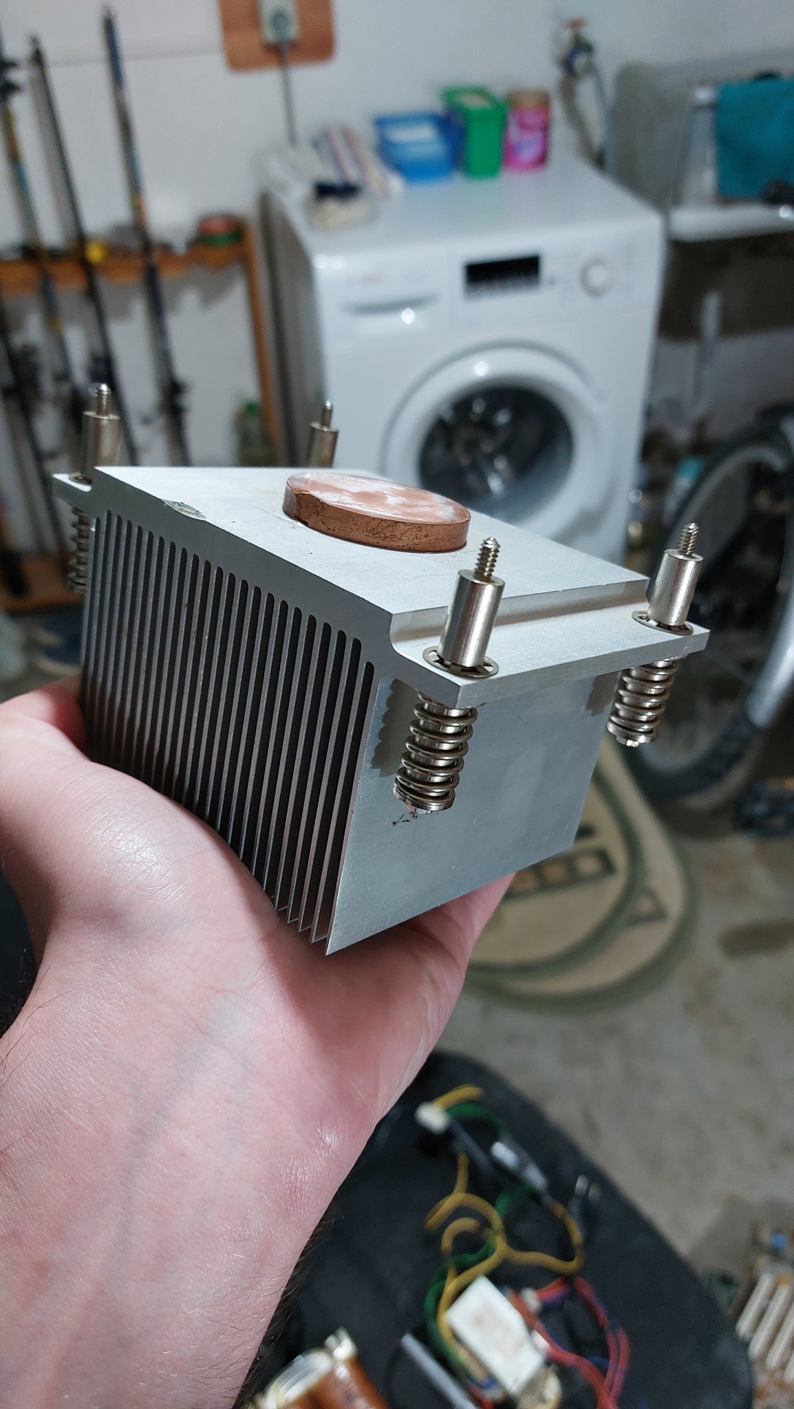

@v4lve lover Thank you for your suggestions and time to respond. I already have a few transformers, heatsinks,

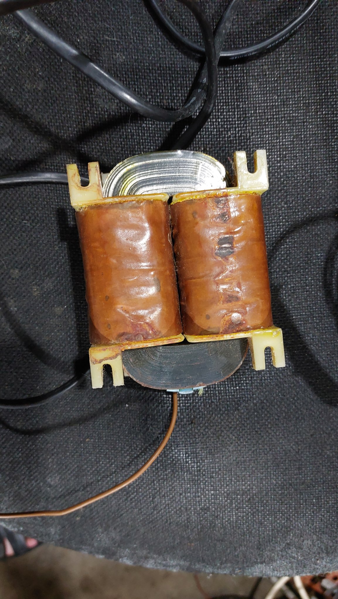

I have the case from an old Voltcraft powersupply ( it was 13.8v 10A for car batteries or audio testing idk exactly ) I dont have it's transformer anymore, it was a beefy overbuild in my opinion transformer , 17 - 0 - 17 v ac rated 8 amps made an audio amp with it for a friend., anyway.
I do have one 37v DC I cut a few turns to make it that voltage, I think around 3 amps , and also one that has two 13 - 0 - 13 2.2A , if I could cut it open but its sealed with varnish, to rewind it in parallel for 13 - 0 - 13 4.4 A .
I also have a few LM723 , I have a few TL494, I have only one LM317 on hand, lots of small transistors ( BC546, 2n, 2sa, 2sc , etc ) , BD's , TIP's,
These old " cases" are strong iron, I did diy the cut for that V/A Meter, I might sand/ repaint the front. Maybe print on Photopaper , with " proper writings" for , Voltage adj, Current, etc . and stick it to the front and maybe cover it with a few coats of varnish
I forgot I also have a toroid , 200VA 26.5 - 0 - 26.5v ac 3a But I think its a bit to much for a test bench psu.
Anyway, here are some pics.
PS: Sorry for the mess ,

Okay, you got some of the major parts
I am designing a PCB for my personal use, when its done i will post pictures of the design here.
