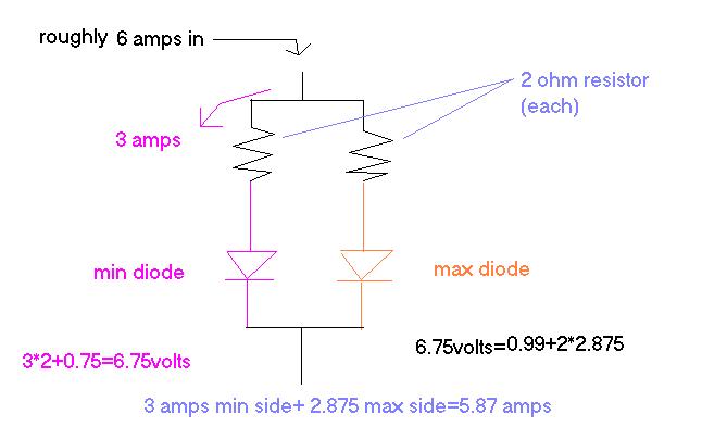

parallel diodes

mmm, i don´t mean the internal resistance tolerances making diodes work diferently.... my goal was that this graphic displacement you was triyng to show me can make one diode work in much harder conditions than the other....
I don´t know how to xplain it but this is same problem with leds. Tho leds in paralell is not welcome, it was one of the things i learned firmly. (my teacher used to say that if you can´t xplain it, you really didn´tunderstood 😀, well, he didn´t consider the language problem 😀)
diodes in parallel=not very good idea
diodes in antiparalell=no problem at all (this is tipical for some cases we need this)

Thanks Rox,
The section at the bottom of your second webpage reference shows exactly what I proposed. If you used exactly the same type of diode, then you can increase the total forward current. (They call that "matching".) They give you a drawing to show the potential problem with unmatched diodes:
"Figure 12 shows exaggerated characteristics to highlight the variation in current through each diode." (My underline)
The theoretical forward PN junction voltage drop across a silicon diode is about 0.6 volts (germanium is 0.2 volts). But the silicon not at the junction and also the component leads also have a certain amount of resistance. If the two diodes are exactly the same type by the same manufacturer, that extra resistance will be very close to the same. If you had "perfect" diodes with zero resistance, then a slight difference in the forward voltage drop would send all the current through one diode, and blow it up.
But they are far from perfect! Looking at some 1N5404 datasheets, I see that they drop about 0.9 volts at 2 Amps and 1.0 volts at 3 Amps. For the sake of simplicity, lets assume that each diode has a linear relationship over that range. Let's think about what would happen in the various cases:
We want to get 5 Amps from the pair, so the combined current will be 5.0 Amps. If they were perfectly matched, then they would each pass 2.5 Amps with a forward voltage drop of 0.95 volts.
If instead one diode passes 5% less current per volt and the other diode passes 5% more current per volt in that range, then one will pass 2.625 Amps, and the other will pass 2.375 Amps. Not bad, since they are 3 Amp diodes.
If they differ by plus and minus 10%, then one will pass 2.75 Amps, and the other will pass 2.25 Amps. Still okay.
If they differ by plus and minus 20%, then one will pass 3.0 Amps, and the other will pass 2.0 Amps. This is the limit we can accept for this circuit.
I picked 3 Amp diodes precisely so it would sitll work with a huge amount of variation between them. If you actually measured the difference between two of these 1N5404 diodes from the same mnaufacturer, I think you would find no more than plus and minus 5% difference. Not plus and minus 20%.
The resistance of the non-junction silicon and the component leads is acting like the load-matching resistors they show in Figure 12.

mmm, the resistors are introduced for matching purposes only. It is not the internal resistance "representation".

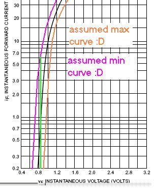

well, no diode tolerances found yet, but let me try with this explanation;
This is a general purposse diode datasheet, 3 amps stated.
http://www.fairchildsemi.com/ds/1N/1N5401.pdf
Check the graph on the datasheet (page 2), attached fille also shows in detail.
This is typical diode curve for that manufacturer, they all will be somewhere close to that curve. Check the stated 3 amps current is for a 0.875 volts drop on the TYPICAL diode.
Now let me assume 5% tolerance here;
0.875+-5%=====> 0.831 to 0.918 volt range.
I looked on the graphic and drawed the lines for 2 amps and 4 amps. This is rougly the 5% tolerance I was talking about.
If you rest 0.91-0.825=0.085 volts difference, Now this volts diference is changing from 2 amps to 4 amps on a typical diode.
if you work out 2 amps/0.085 volts, this means 23,5 amps per volt increment near 3 amps working zone.
This is why paralelled diodes are not welcome. You don´t certaily know which diode is really working. It can work fine, but it can be a disaster also. Do not go this way 😀. Buy a stronger diode.

http://www.onsemi.com/pub/Collateral/1N5400-D.PDF
new example, this time ensuring the stated forward volts @ 3 amps is the MAX spec; 1 volt.
the typical forward volts is not detailed on first page as the one mentioned but you can check on the tyipical diode curve @ 3 amps; somewhere 0.9 volts.
Now if we check the 1 volt value for a typical diode..... somewhere 10 amps is the current.
Now let me play something more with numbers 😀;
let's define tolerancy as the % from typical stated forward volts at rated current (0.9) to max stated forward volts for a random diode (1 volt); 0.9+0.9*X=1 where X=0.11=11%
this 11% tolerance causes 3X current increase, and it is not the worst case since we are comparing the typical Vs the MAX case, If i would compare the MIN case VS MAX case..... 😀 😀 😀.

still plaiyng with numbers and montains of assumtions ;D.
the max curve on the image was assumed with V=1 @ 3 amps criteria, just moved the curve horizontally (why horizontal?... yea could be moved vertically or diagoally at any angle... well lets assume something as drawn 😀)
the min curve was drawn with no criteria, just something simetrical at the other side... 😀. (montains of assumtions yea 😀)
We want 3 amps*2=6 amps.
So this is the worst case (min Vs max)
total amps=min diode amps + max diode amps=6 amps.
the paralelled diodes will run at 0.82 volts moreless, the min diode current will work near 6 amps and the max diode current will work near zero value, yea, the system will aparently work at 6 amps, but the reallity is that only one diode is working, it will last some seconds before the diode burns (both).
This was a streme case, but two tipical diodes will work in very diferent currents, and any increment on one of them will burn the diode since we are making them work in their limits.
Nothing more to coment, this is general knowledge for electronics, paralleled diodes, zeners, leds... are not welcome 😀.

just thinking about how a series resistor solves that problem;
let's keep the exact two diodes on the last example, the assumed max and min diodes.
After rough calcs I worked out this circuit (attached)
The strongly mismaching diodes are now working on a very close conditions (3 amps and 2.8 amps) it is not 6 amps total, but this resistor helped setup is much better than the "erroneus" paralelles one.
Obiously, there is a wasted power on this setup because of the resistors (like 36 W wasted at all :S) also the volts drop must be considered going this way.
But the final conclusion was to show how simply paralelled diodes do not work fine and series resistors and then paralelled diodes do work better. Anyway, If i were you, I would buy a single more powerfull diode. Good luck.
