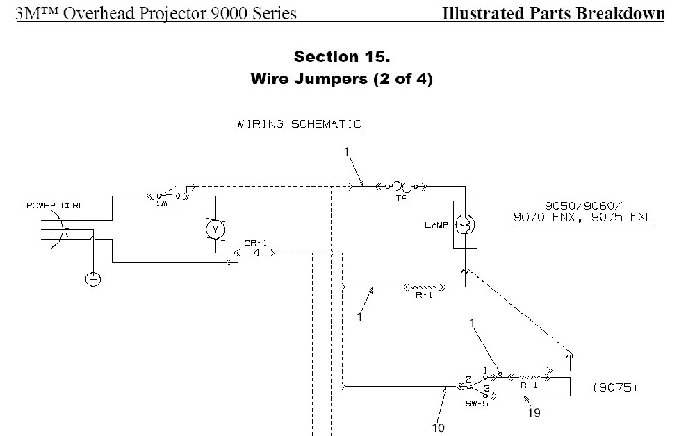

oh yeah, in the diagram:
TS = Thermostat
R-1 = 1.2 ohm ceramic resistor (big one!)
CR-1 = 82v diode
"M" in circle = 120v fan
SW-1 = on-off switch
BadBoy 😎
TS = Thermostat
CR-1 = 82v diode
BadBoy 😎
