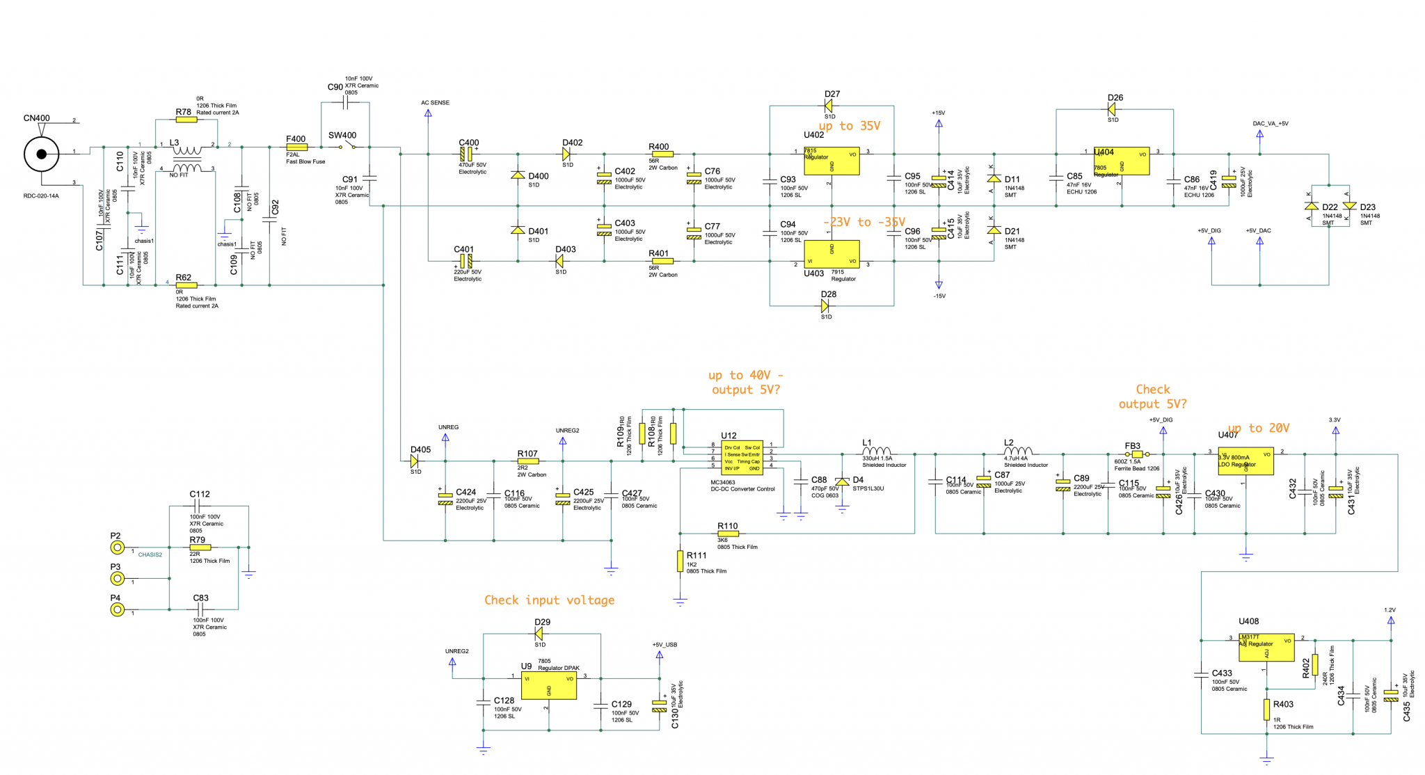

BTW, did you know that if your appliance needs 12VAC from the wall wart, you can equally well use a 12VDC wall wart? Not the way around, though.
thanks for the information, I am not sure I follow the logic - can you explain further. You mean you supply a circuit designed to rectify and smooth an AC supply with a DC supply?BTW, did you know that if your appliance needs 12VAC from the wall wart, you can equally well use a 12VDC wall wart? Not the way around, though.
Yes, the DC just flows through half of the internal rectifier. It could work if the internal circuitry needs + voltages only. Practically it feeds the input of the internal voltage regulator(s). It can't work if +/- voltage is needed. You need to check the internal PSU of the Dacmagic.
ok - thanks, interesting! / this would not work with the DM unfortunately - see attached.Yes, the DC just flows through half of the internal rectifier. It could work if the internal circuitry needs + voltages only. Practically it feeds the input of the internal voltage regulator(s). It can't work if +/- voltage is needed. You need to check the internal PSU of the DacMagic.
