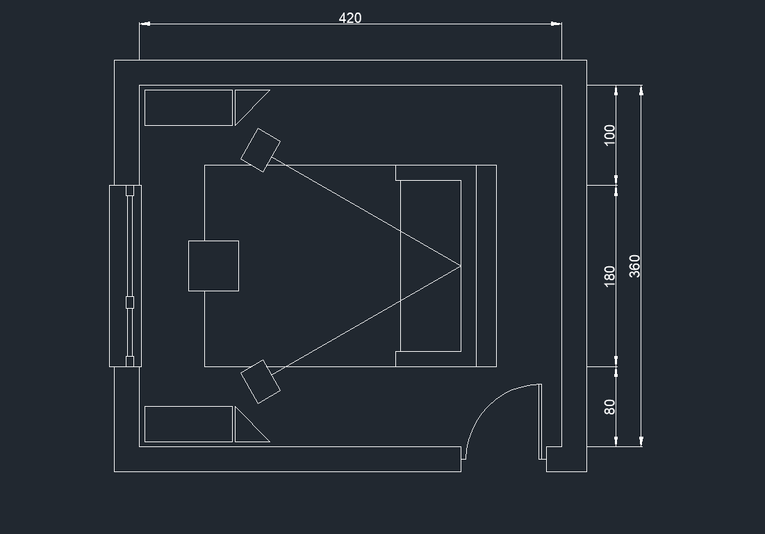

Since I have some spare time, I decided to finally work on the room acoustics. Currently I have just a carpet to deal with the acoustics. I also decided the cross the axis of the speakers about 1m (3ft) in front of the listening position to compensate for the lack of treatment, which worked to a degree.
The room is situated in an apartment building (6th floor, concrete slab, wooden parquet flooring).
Ceiling height is 2.5m (8.2ft)
Current positioning is in the attachments, but I might change it in the future.
I tried the clap test, and I get some fast razory echoes, which I hope to fix.
Was leaning towards putting diffusers inside, since I prefer the sound of a live room. Now, are there any diffusers that would help with the wall being directly behind the listening position?
Also any idea how to fix the early reflections which would hit the window? Was thinking of making movable diffusers on stands, but any recommendations are more than welcome.

I guess another possible position would be the following. Just a rough idea.

Looking at your second arrangement, with the seat facing the window I would suggest you go that way.
But there are a couple of downfalls to a room that small (I assume it was intended to be a bedroom?)
First you are likely to get a repeat bouncing echo from the front and back walls. If you take a dog trainer (clicker) and snap it at your listening position you might here it going back and forth repeatedly in a gradually decreasing ring. Generally the answer to this is to put down carpet and use heavy drapes wall to wall on the window wall and maybe some Canvas Art on the back wall. As long as one of two parallel walls doesn't echo, the other usually tames down pretty nicely.
For your side reflections, I would look into some well placed canvas art (i.e. without glass on top) or tapestries to break up the reflection a bit. Like you I enjoy a lively room, but in a room that small reflections can be overwhelming.
Finally, on the two back corners... Be careful that you don't end up with one or both speakers aimed directly into those corners. Things can get really weird when that happens... a sound from (for example) the left speaker suddenly comes from behind and right... You might also look into a couple of corner traps back there as well... Nothing ugly, even plants or narrow vertical tapestries will do.
I'm no fan of those stupid egg crate panels or the ones with wood sticking out at all angles. It's always best to solve the problem in an attractive manner so that you have a comfortable, inviting room.

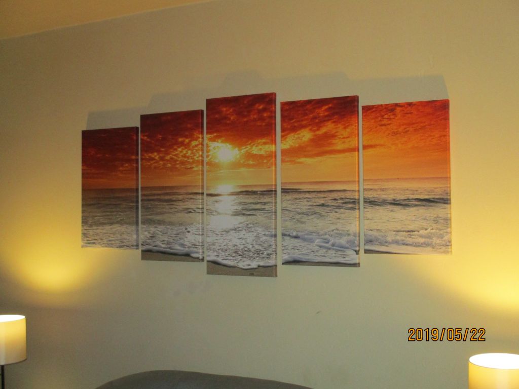

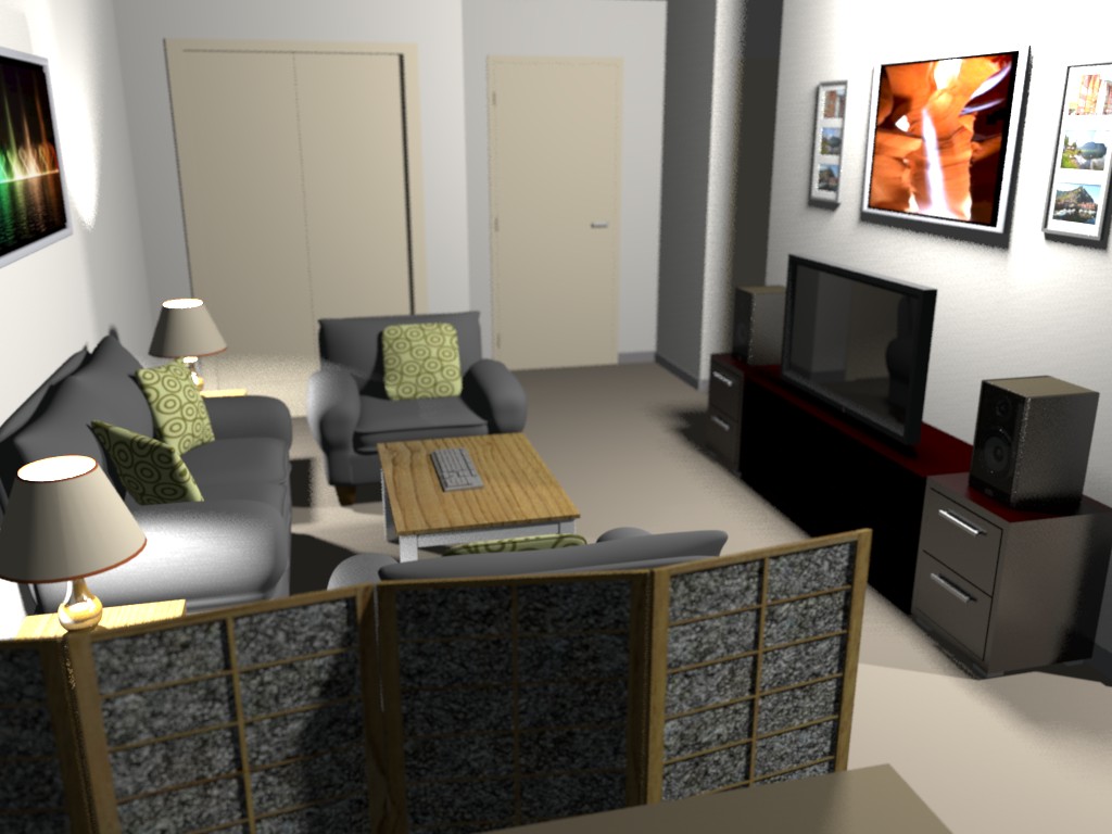

Here's a computer mockup of my listening area, also in a livingroom. I used this when redecorating last year. Worked out pretty well, with only a few minor differences in the furniture.
Also, fwiw, one of my favorite canvas art pieces, hanging above the love seat, looks a whole lot better than those silly egg crate sponges.

For canvas art you don't want hard artist's pasteboards.
You want fabric canvas stretched over a frame...
The effect is that sound moves the fabric microscopically on the way in, then again on the way out, causing a damping effect. There might be other more effective treatments, but none of them look that good on a wall.

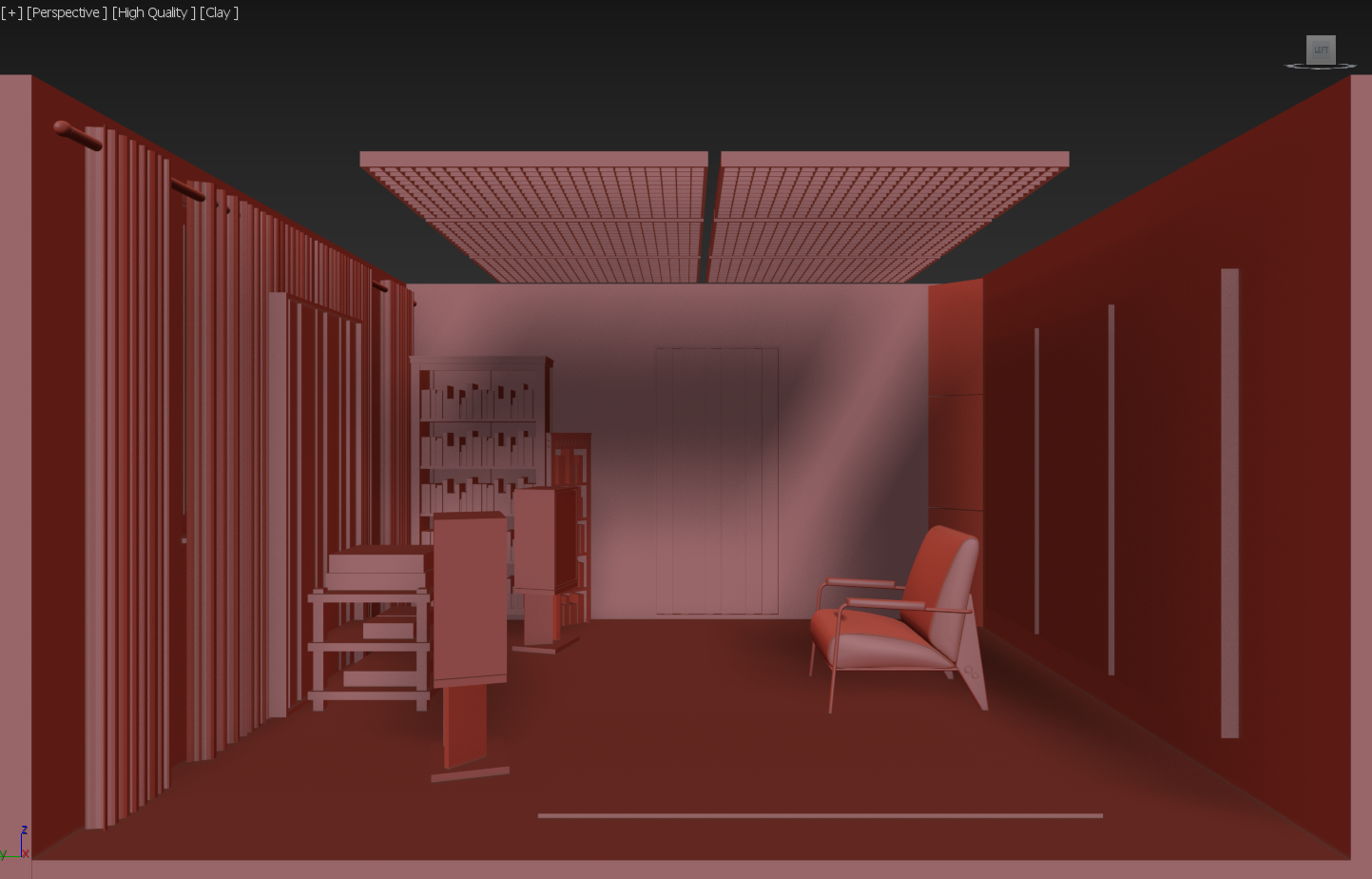

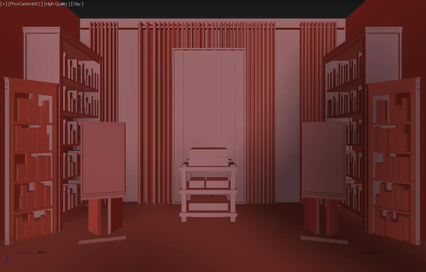

I did a model of the room. Just a rough idea, I will change things when I will progress with the positioning.
I like the second layout as well, mostly because it allows one to pull the speakers farther out into the room and off the front wall.
