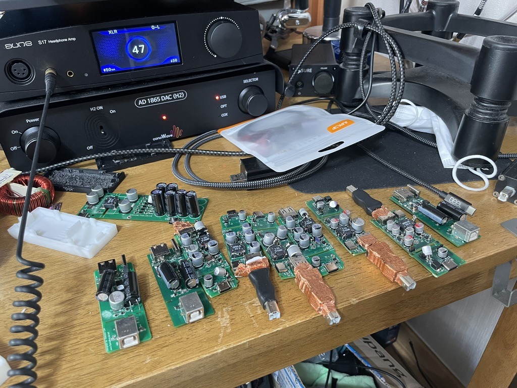

This still needs a bit more testing.
I have made 5th version until now.
and test and test and test...

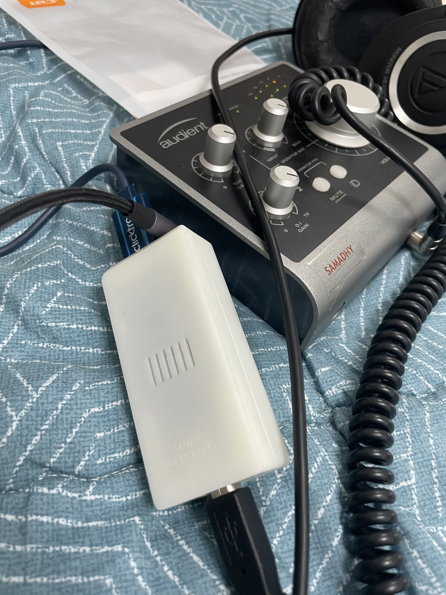

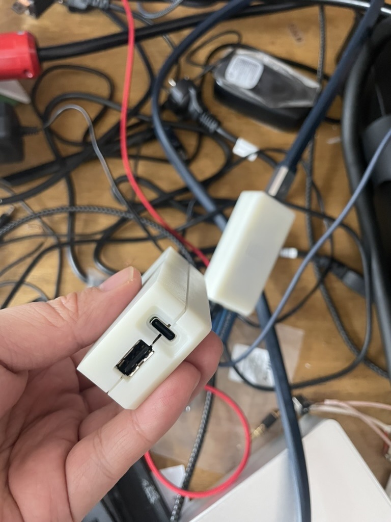

I also ordered a 3D printed case from JLCPCB.
Recent changes include
1. Use type B terminals on inputs and type A terminals on outputs for general use
2. Using the LTC6655 voltage reference and increasing the capacitor on the SET pin to 4700uF to improve the 1/f noise of the LT3045 powering the TCXO;
The LTC6655 is an option since the LT3045 works without soldering the 6655 chip. I think the increased capacitor on the SET pin is enough to reduce the 1/f noise.
