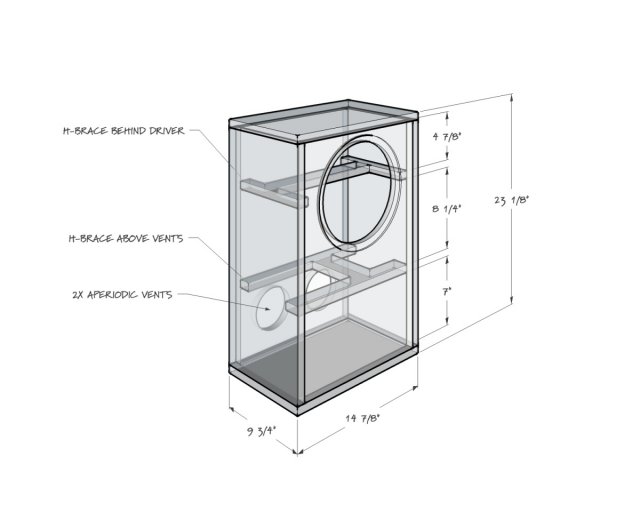

OK, after looking at your volume measuring photo, I will assume that each B200 presently has a volume of approximately 12 litres available to it, or approximately 0.4 cu ft.
Using your existing boombox design, you could experiment by resistively ventilating the solid backs of your two B200 enclosures. If this improves the sound then well and good, if not you can always return to solid backs.
By my calculations, here's what you have to do to each of the two speaker enclosure back panels:
Drill 5 rows of 4, 1/2" diameter, holes through each back panel (That's 20 holes per panel.)
The centres of the holes should be spaced 3/4" apart.
Cover the holes on the inside of the back panels with a felt cloth like that used in winter overcoats.
Line the side, top and bottom interior walls of the enclosures with a thick absorbant material like fibreglass.
You have now made aperiodic enclosures! P.S. Make sure the rest of the enclosures (apart from the ventilated backs) are airtight.

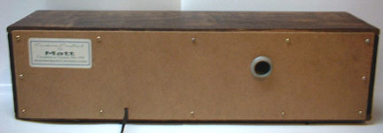

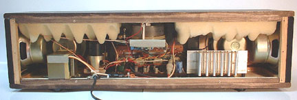

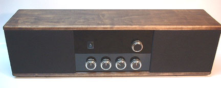

A centrally located port tube near the bottom, below the amplifier, going through the amp mounting panel, might be a good way to extend the bass.
I've built a stereo radio with such a port out the rear, and it enhances the bass quite nicely.
Make the port about 20 to 25 CM diameter, flush with the interior area behind the amp board, and flush with the rear panel.
Alernatively, a "slot" could be designed across the bottom of the amp board - the full width of the amp panel, and perhaps 15 CM high inside dimensions.

The high Q of the B200 makes it unsuitable for reflex port loading and diy buffs use large sealed enclosures, slightly smaller aperiodic enclosures or open baffle mounting.
Consequently, a B200 is not the best choice for a boombox application and any suggestions we may offer are unlikely to significantly enhance the bass performance in such a small cabinet.
Still, it may be fun trying to do so before spending money on more suitable drivers. 🙂

PRR makes a valid point and you did say that the B200s were pleasing you, except at high volumes.
If you do wish to experiment with resistive venting then, using a router, you can cut out narrow slots in each of the backs instead of drilling holes.
4 slots in each back, each 4" x 1/4", will do the same job as the 20, 1/2" diameter, holes I suggested earlier and will produce a neater finish.
As I said, it will be easy to revert to solid backs if the resistive venting does not prove to be of advantage. Nothing ventured, nothing gained! 🙂
