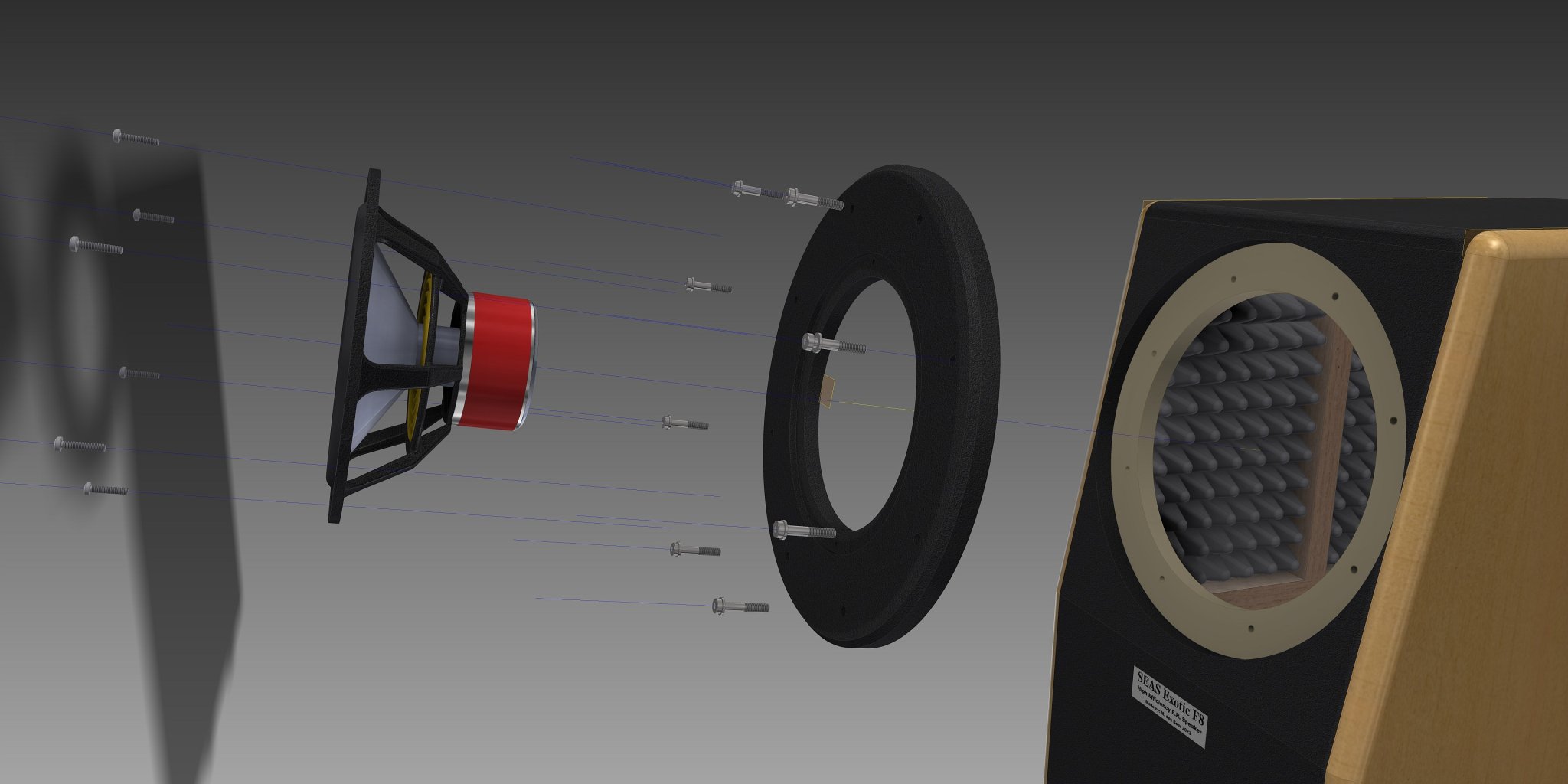

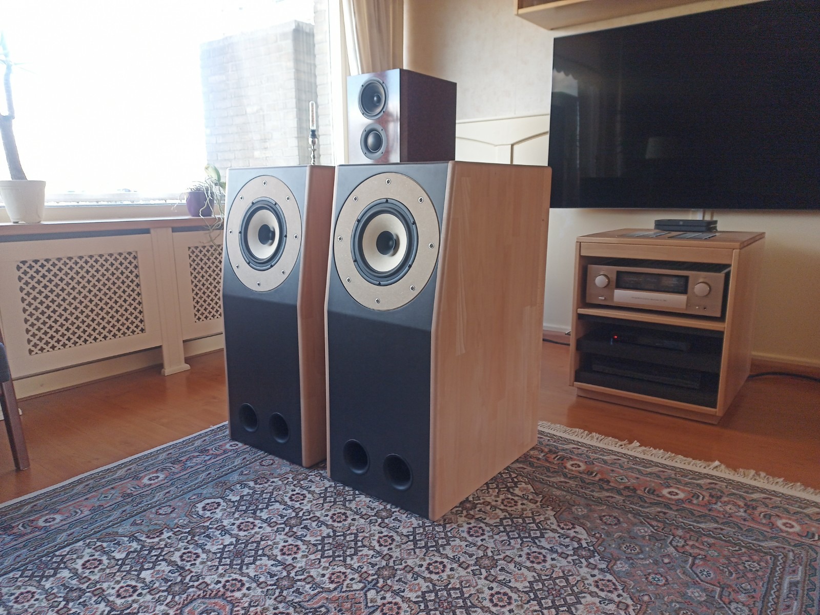

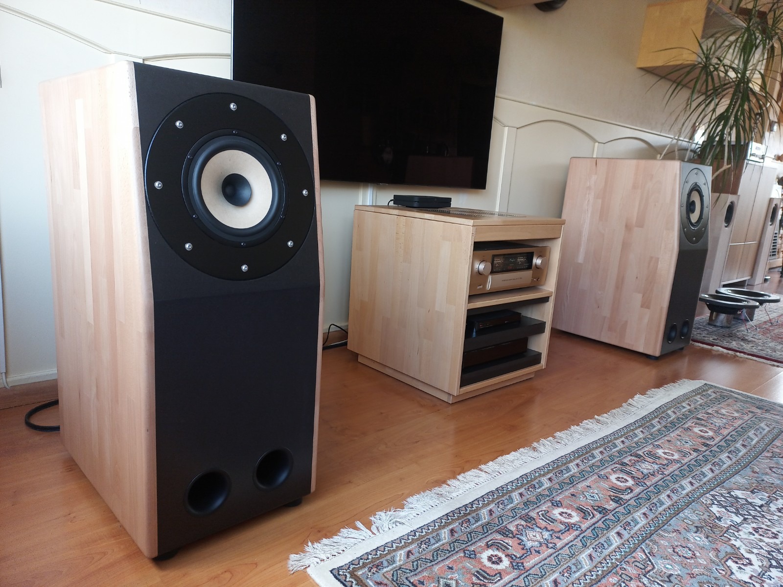

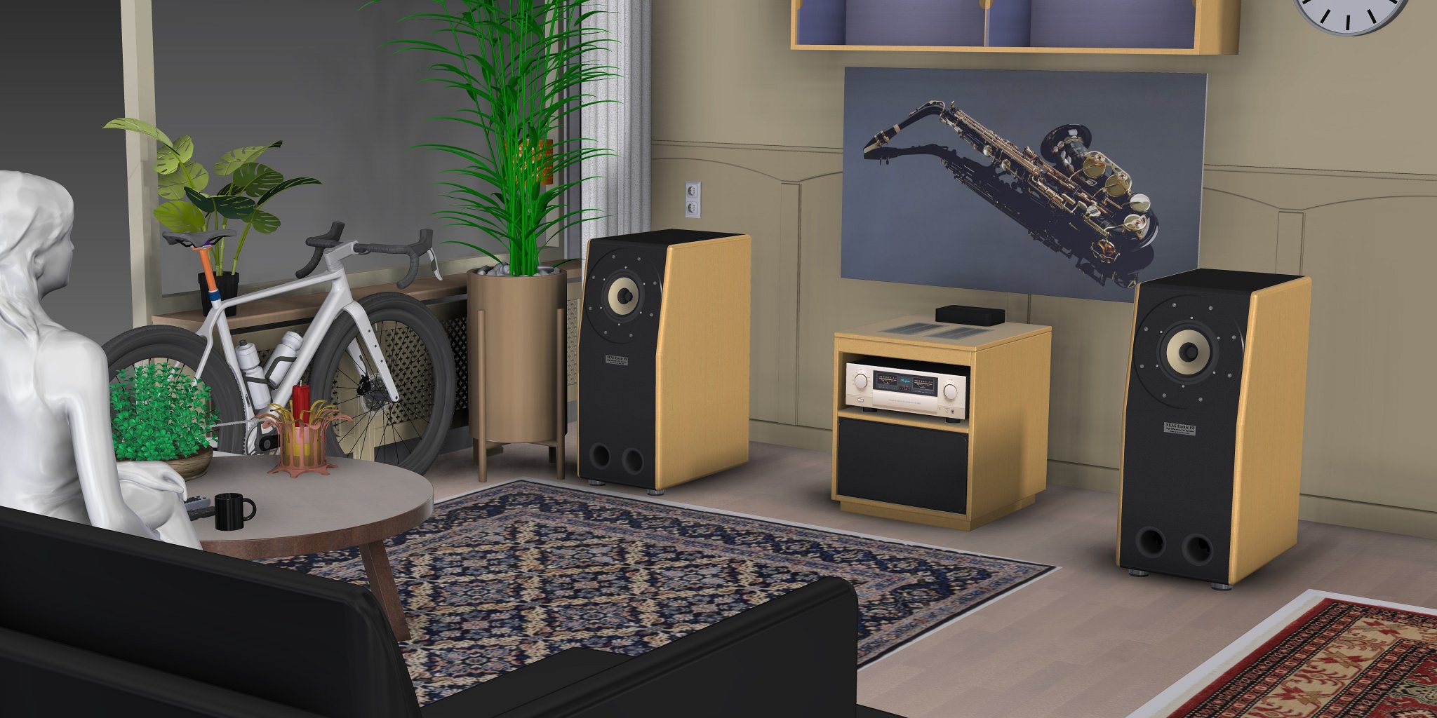

Yesterday evening I connected my lovely Exotic's again to my Accuphase and listening to them 😍😍😎.
What a wonderfull driver placed into 160 liters 😍😍😎.
Very very smooth and very deep and perfectly controlled.
This is going very very nice.
Description:
Ready B.R. speakers equipped with the very expensive and beautiful full range 8 inch drivers from SEAS with a beautiful flat curve and an impressive superior depth.
This goes very nicely, deep and low with ease.
Drivers with certificate and subsequent serial numbers.
REMARKS:
MATERIAL CABINET 18mm BLACK AND STANDARD MDF.
SIDE PANELS 19mm SOLID BEECH WOOD.
BRACINGS 44x27 SPRUCE WOOD.
PRITEX 42mm DAMPING GLUE TO ALL INNER PANELS EXCEPT BAFFLE.

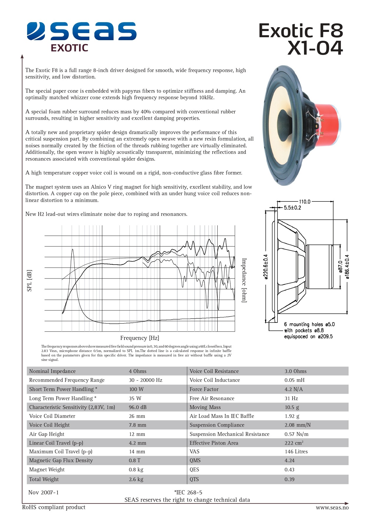

TECHNICAL DATA:
Driver: Full Range from SEAS type X1-04 EXOTIC F8.
Volume cabinet: 160 liter.
Sensitivity: 96 dB/W(m).
BR port (2x) 70mm diam. x 109mm length.
BR tuning @ 30 Hz.
Frequency range: 29Hz - 20kHz (-3dB). (edit)
Impedance: 4 Ohm.
Long time power 35 Watt.
Short time power 100 Watt.
Two tone cabinets.
Sleek and solidly built.
Transparent satin finish.
Built 2023
M. den Boer
Brielle
The Netherlands.

You can measure if you want. No problem.Do you have any measurements? 🙂
I have. And after my experience all fullrange drivers need some compensation 🙂You can measure if you want. No problem.
But Seas Excotic and FA22 is in the smoother division.
https://www.hifisentralen.no/forumet/threads/helob-the-final-en-åpen-baffel-byggetråd.67189/page-13#post-1608505
Se also the post from Nelson Pass yesterday about full range drivers and the need for taming the hot top:
https://www.diyaudio.com/community/threads/lowther.389573/page-2#post-7544276
