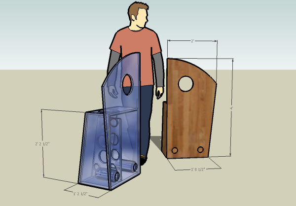

I have 4 Pioneer Bofu's sitting around and just waiting for some projects. I was poking through the internet and came across the idea of pairing an open baffle with a ported box using identical drivers.
Here's what I was thinking for my Bofu's. A large OB approx 2' wide x 4' tall with a 3 cu. ft. ported box attached to the rear with a second driver firing up. See the pic if my description confuses you as much as did me when I wrote it.
Who here has he done it? What are the draw backs? Expense of the second driver? (I already have two pair so that's taken care of.) Will the output of the two be matched well enough? If it really works then why haven't I seen more of these?

You could be cross omni driver for a 1.5way to compensate for dipole rolloff and BSC
Another thing is that driver Qts=0.5 pionts more in the direction of a closed design, rather than BR
To maintain your general design with omni bass, maybe make a cut below the OB baffle, so that OB baffle is positioned in the middle of the omni driver, so that it works more like real omni

Just going by WinISD (for whatever that is worth) puts a sealed bofu at a F3 of approx 60hz and a F10 of 32hz. A ported box of 3 cu. ft. tuned to 35hz has an F3 of 32hz and a F10 of 26hz. I know extension isn't everything but the ported curve looks better to me and I've always liked the sound of ported boxes over sealed for the music I listen too. I believe Zilla has had the Bofu in both boxes so maybe he could comment on this.
Moving the baffle back to where it straddles the boxed woofer is an interesting idea. Would there be any weirdness having the two drivers firing into the listing area at 90 degrees out of phase with each other? I don't know that much about how these things behave really.
As you guessed the goal was to have the merits of the "Open Baffle Sound" coupled with real bass output without resorting to bi-amping or eq'ing. I already have the Pio's sitting around so I might as well give it a shot.

If you go with that enclosure type, I am not sure how it would sound with a bass reflex enclosure. That thread is to eliminate the need for BSC, since when the OB driver moves outward, the BSC woofer also moves outward, thereby making the net displacement essentially zero in the rear. If you want to avoid something like this, I would just mount the BR speaker in the front. You can also invert the phase of one of the woofers, or just mount it inverted with the magnet sticking out.
Also, I would definitely recommend rolling off the BR driver somewhere in the upper midbass or lower midrange. There will be some cancellation due to the phase shift if you dont add a highpass to the OB speaker, but it won't be as bad as you think in the upper midbass

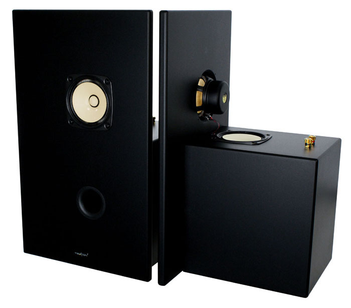

Wire both in phase, and the rear driver (LP around 500Hz), and it cancels the back wave of the OB driver.
The idea of this design is fairly simple: you get bass response better than the OB and the boxed driver would give separately (mine go an octave below Fs), and you get the airyness of an OB system.

paulfk, that speaker is the one that got me thinking about this. I saw someone selling those on the Obad import site and I thought I could make it on a larger scale.
