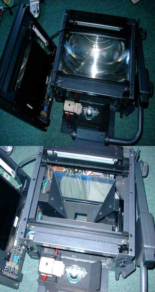

The ohp+tft panel is an all in one , called the NOBO INTEGRA POWERLITE its a little smaller than your average ohp (8" X 12" X 13") i get a clear image in daylight ,the only thing ive changed is the condenser lens.the lamp it takes is a 575 watt m/h
ham-anegg it has 1 fan,which blows cool air on the bulb and 1 in the tft panel(one of those long barrel type fans)
