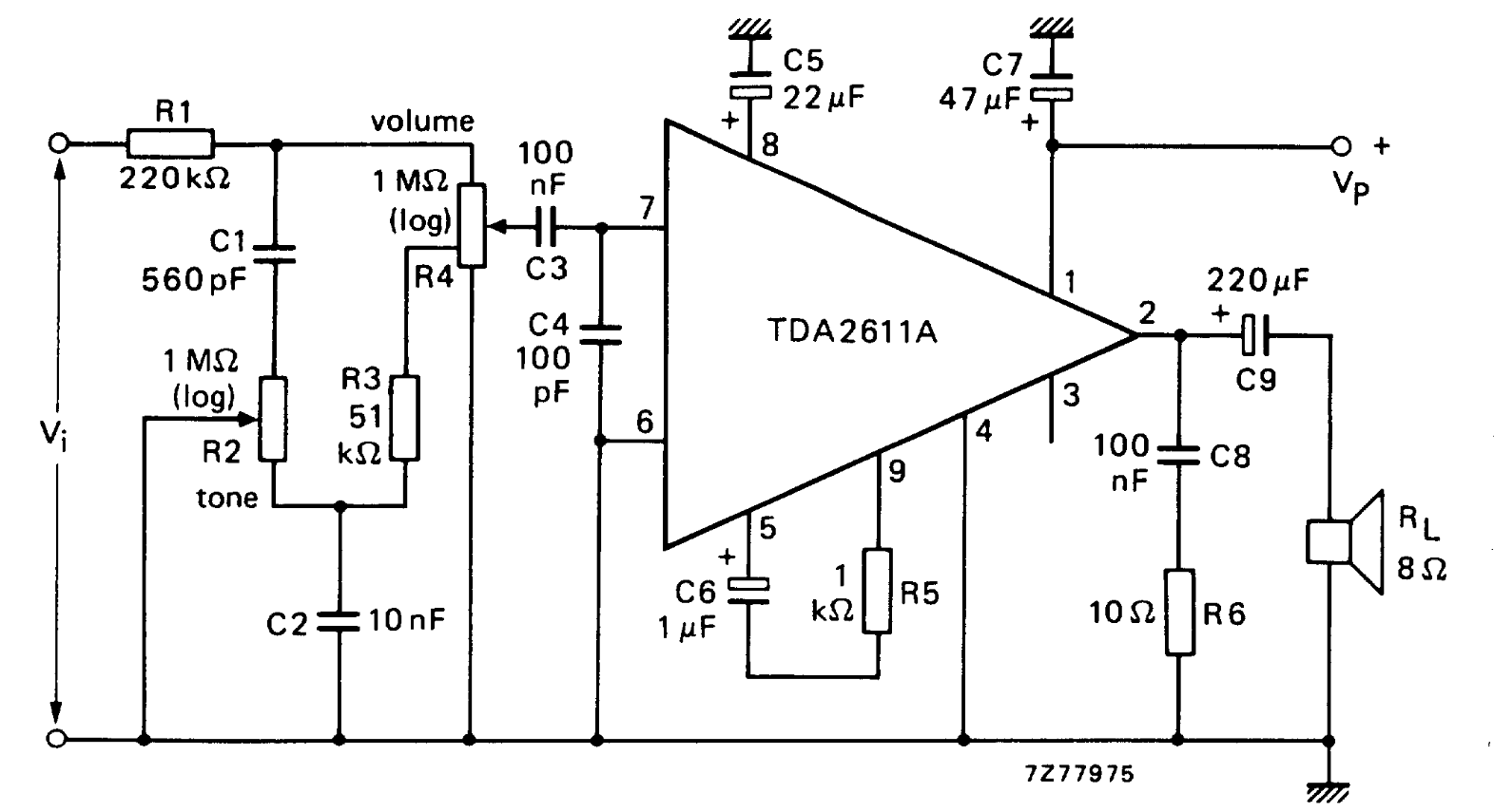

The circuit in post #5 is pure fiction, click bate. TDA2611A is not a dual chip.
https://media.digikey.com/pdf/Data Sheets/NXP PDFs/TDA2611A.pdf
