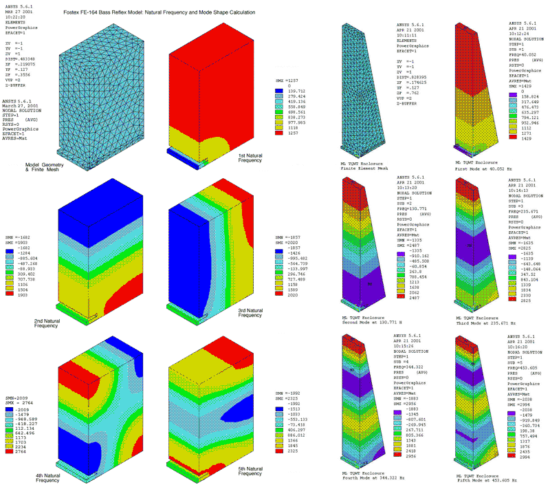

Is there an aspect ratio where an enclosure stops/starts behaving like a pipe?
The BR math assumes a box with dimensional ratios not that far off from a cube. As one dimension starts to significantly grow and the other 2 shrink, the box will slowly transition from a BR to an ML-TL. I have boxes where i purposely work to defeat the ¼ wave behavior (the Compact FLoor Stander miniOnkens) and visa-versa one can work to enhance the ¼ wave action (the big Woden ML-TL for the GPA 604).
Here is a picture collaged together from Martin's ANSYS simulation of a BR vrs his 1st ML-TQWT which clearly shows the different characteristics caused by a stretching the box... both have the same driver, volume & port -- the only difference is shape.
