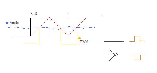

Eva, I was referring to the theory applied in the acquisition. that is, to understand about nyquist? but in practice it is necessary to acquire a higher fS 2x. You can not reference to the audio signal, just because you listen to it. try to track the value sampled at 2x. ECG (cardiologic track) Have you think of 100Hz samples then?
ok, I do not want to bring confusion, thanks for the joke (I could do better amps), if they are better, it is not for sampling.
Now, little question:
please, you guessed Want get (or create) for AD clock signal must be sampled with the same result as the comparator. please, show me.
This can help you.
Sorry for easy design.
This can help you.

To AP2:
The "audio signal" in your drawing has -20dB of 10Mhz content...
Wrong example to prove a wrong knowledge system.
Triangle wave modulation leaves many problems unsolved, namely a cumulative error from the previous cycle to the next that takes several cycles to be corrected. And it adds an input-to-output delay equal to the clock period. That's why triangle-wave modulators need a quite high clock to get some accuracy.
There are better approaches that leave little or no cumulative errors for the next cycle, all involving non-linear modulation (integration and convergence). These give better accuracy with a lower clock.
Understanding that may require updating your knowledge system.
To EVA:
I draw this simple design with paint ... just to show the application of the clock.
why do you answer me something else?
please, answer what and how it should be the clock to get the same result with AD (if you think that you can get)
ok .. audio signal is a line (no noise).
not explain what is better or worse. just answer the question.
if you have a deep knowledge (not just theoretical bla bla ..), then you can respond in 10 sec.
the question that I made you discover many things.

Believe it or not, the square wave before the filter contains all the audio frequency components with the right amplitudes. In fact, the filter has to be designed to leave these components intact, and attenuate only the frequency components above audio frequencies, which both speakers and our ears ignore.

I have never heard of a filter that can do what you describe. Filters are always causing phase distortion along with their attenuation, hence they build up energy (this side effect comes in handy when pulsing high speed bursts in to a `slow´filter, as the bursts are absorbed and released by the filter as an average amplitude being of lower or at the ringing frequency of the filter)... As we are talking about PWM, no? The width of the pulses are the variable, and the amplitude is given, no? -So how can the amplitudes be `the right amplitudes´ as you claim (you ment in the right proportion, no)? Maybe you got a different taste in music, but my collection usually have different and very varying amplitudes, and i also like to adjust the volumen once in a while 😉
Where do you get these ideas from(measurements, writings, own ideas), can you be more elaborate, or are you just saying things for fun?
