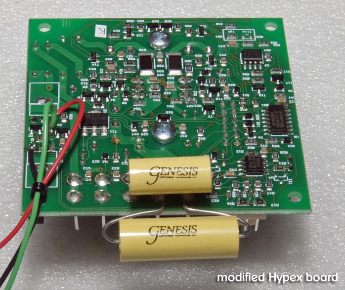

i've replaced the output filter capwith 680nF tin foil KP one
for smaller cap , you can use PPS ( polyphenil-sulfide) one

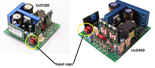

I looked over it last night. This mod just doesn't make any sense to me. There's already a good quality WIMA polyprop cap there, at least on my UcD modules.
Then its more interesting to bypass the input caps to make the modules DC-coupled, provided you understand the risks and are willing to take them. The simple way of doing this is to solder wire on the rear side of the board to short-circuit the caps. Which caps are shown below:
