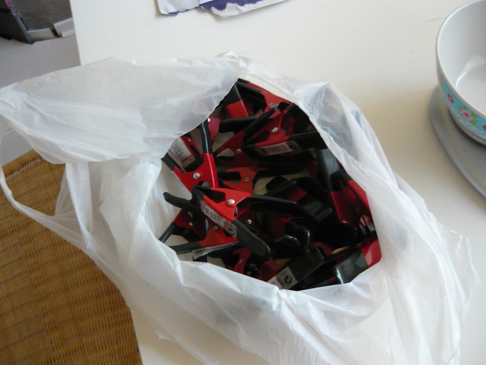

Clamps 32 in total , just to do some test, maybe buy more if i want to use the whole frame.
2#
clamp power it can hold on easy to the bag of the rest of the 31 clamps

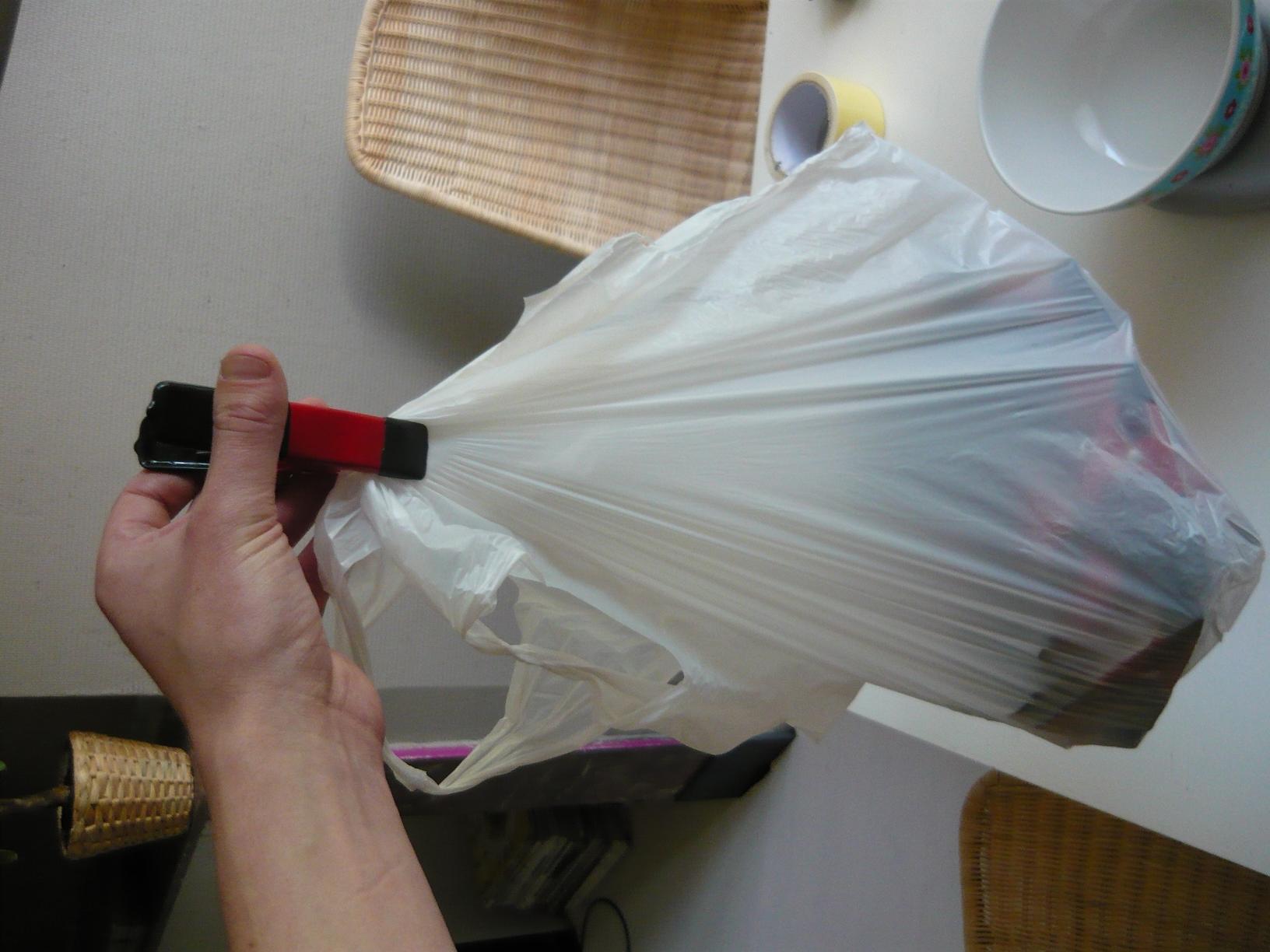

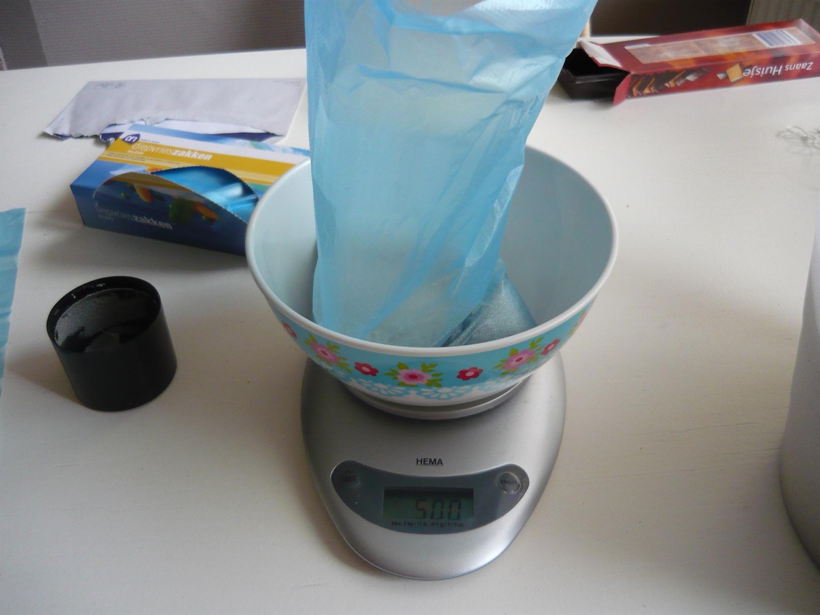

uhm scale with sandbag exact 500 gram

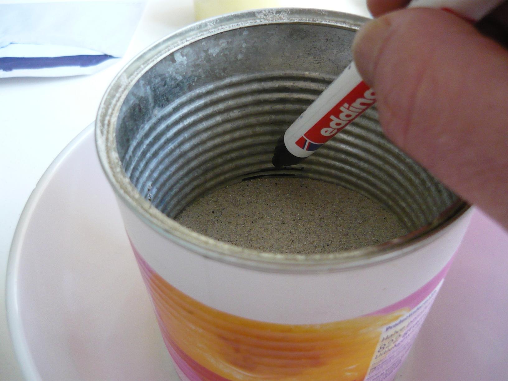

4# marking a can to use as measure device , so i fill alll the bag with this can and fine tune later on the scale, otherwise my scale went of because i whas to slow.

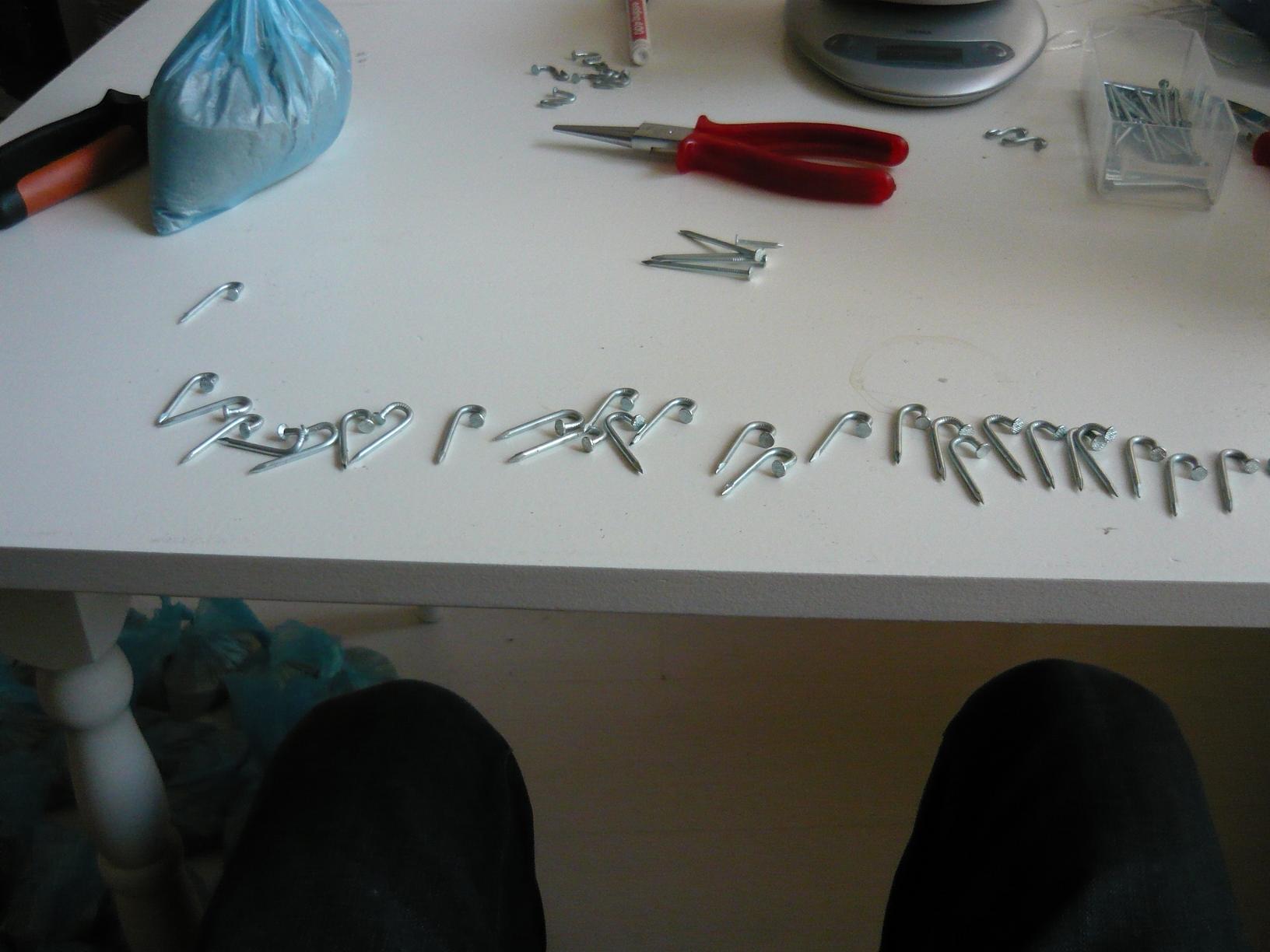

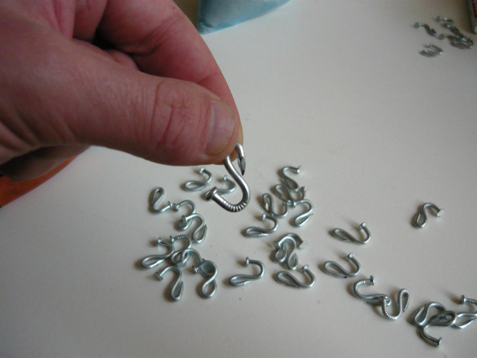

making hooks, could not find any S hooks in the hardware store, so just do some bending with nails.
6# the bending result, not really all the same but the will do there job

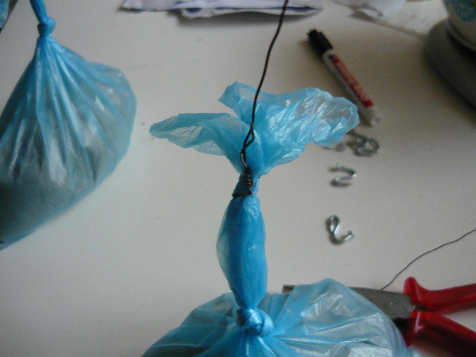

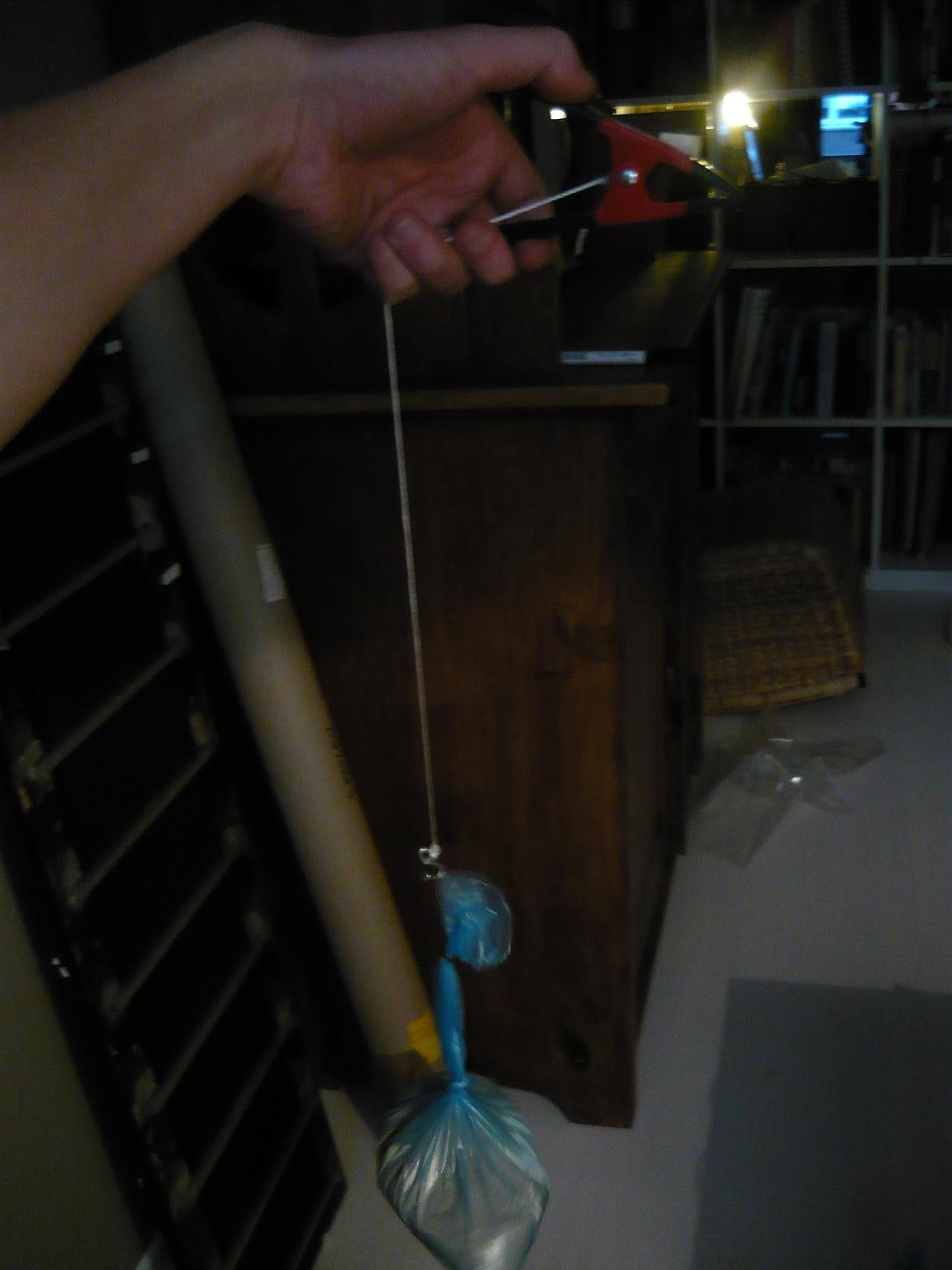

7# get some steel wire to make a loop on top of the plastic bag so i can hang them on the S hooks as many is a like
8#
what i just told in 7

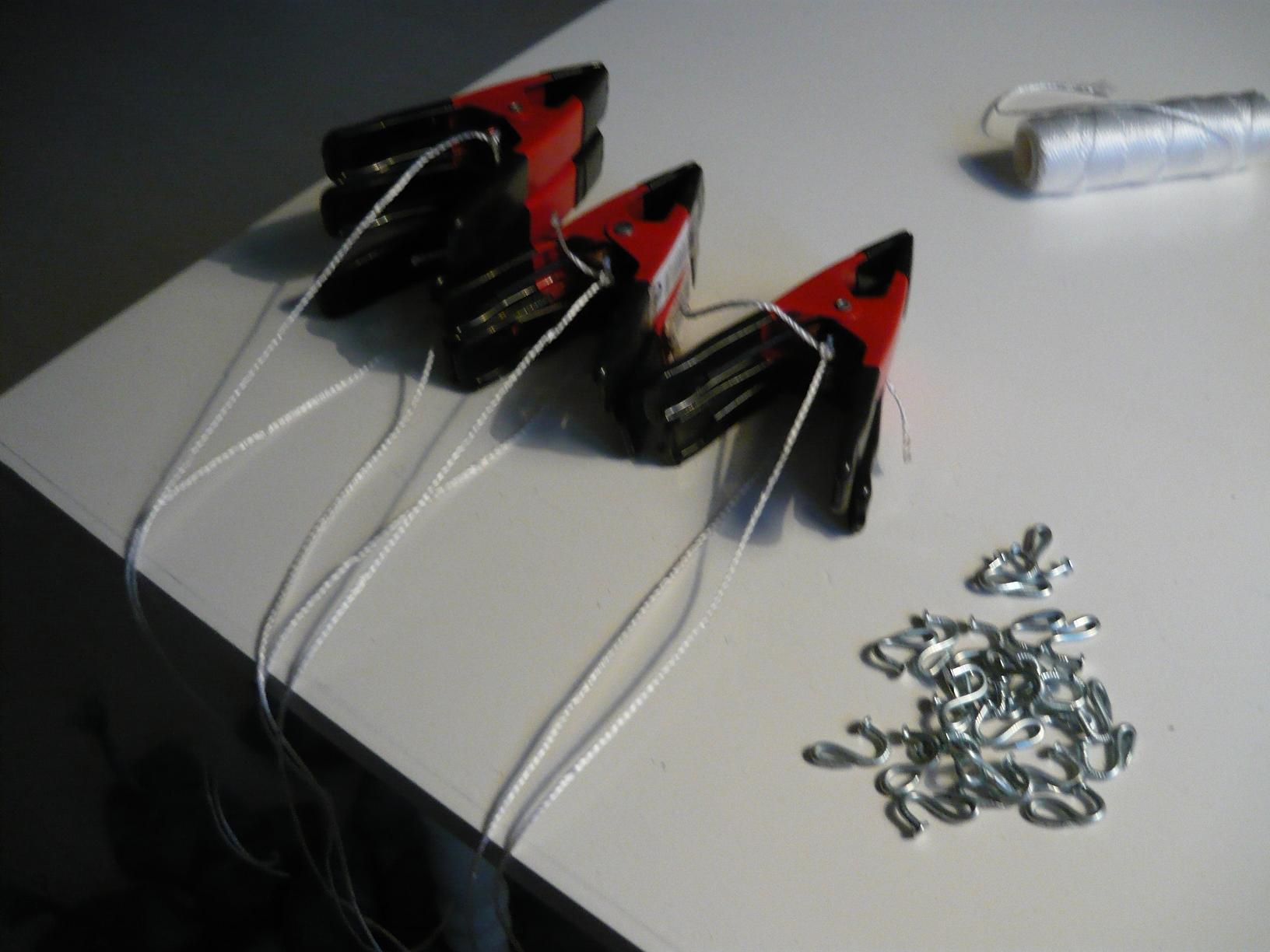

9# attach wire to clamp and to S hoook
10# end result bag on clamp with wire and S hook ready to use.

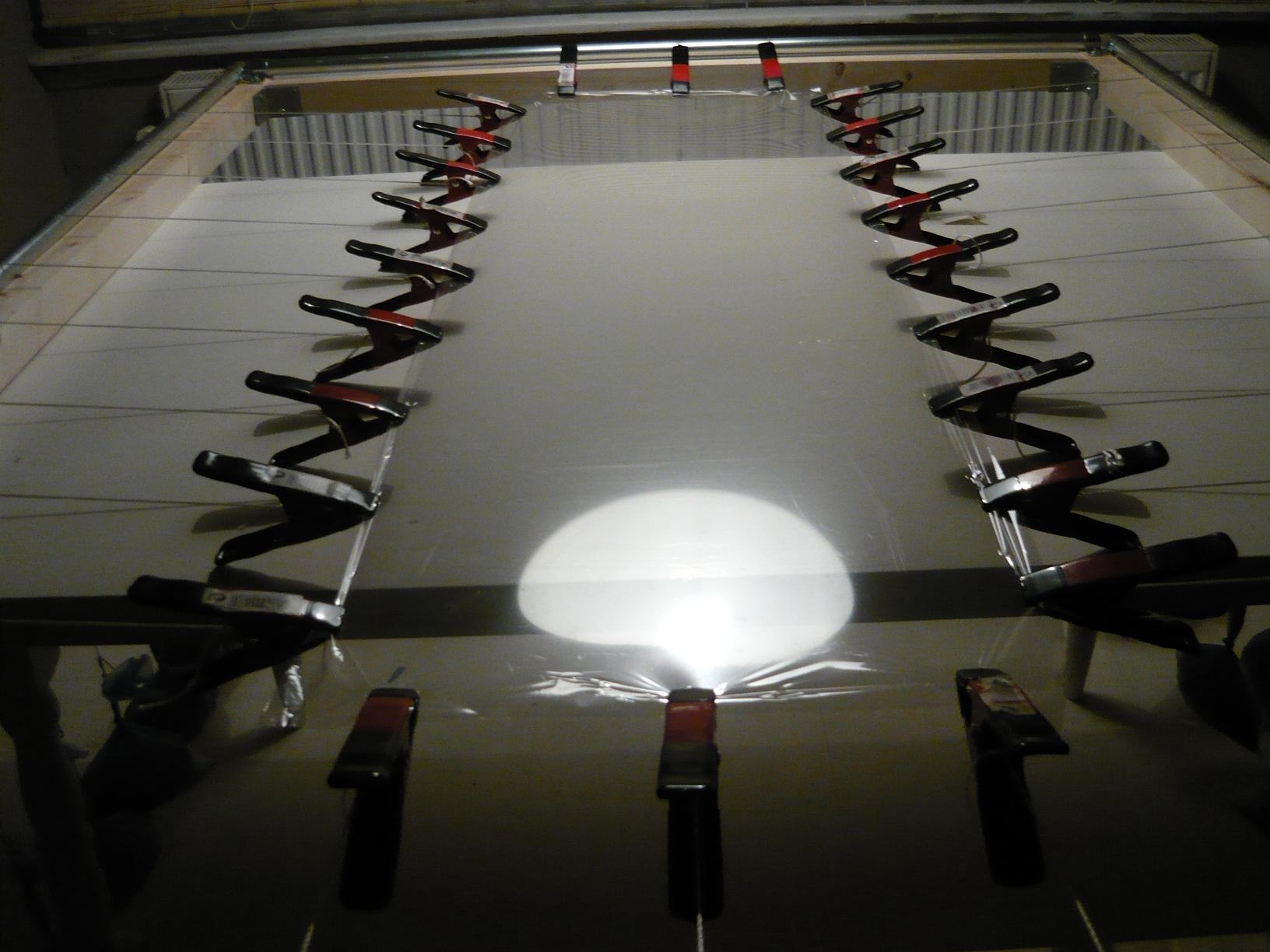

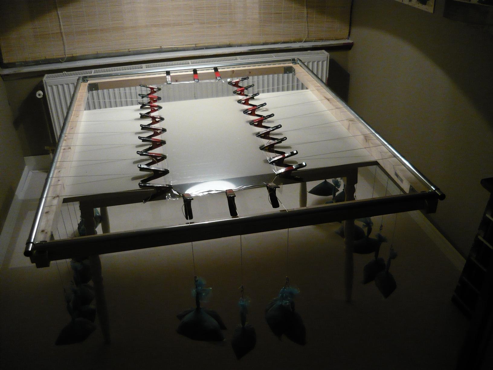

ok then i made a frame of wood and attached these metal pipes to let the rope slide better, the cheapest way i ciould think of and still expensive in my opinion. made a huge frame so i could make huge panels or make 2 at one time. (need more clamps for that but ok)
did not made pictures forgot all about it just wanted to test it reeaaaaally badly

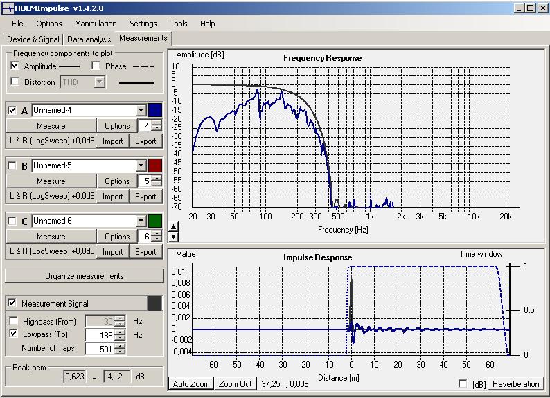

then thing in action :) just a test with last mylar i had around, could not keeping myself from tacking it on the stator to just see what the res freq whas so last picture is measurement.
i need to increase weight for thissize of foil to increase the res to 38, how much will be trail and error. for now i looks like its 28 hz, when turned on it sucks to stator as expected with this low res. althoug it does come off and stays of for pretty long.
still got some clamps over so will add 1 on the short side and 2 on the big side

Nice stretcher. Does the string slide easily on the metal pipes? I've seen others use ball bearings to reduce the friction but that would obviously increase both the cost and complexity. If you decide it would be helpful to reduce the friction but you want to keep the cost down, perhaps you could put small (1 or 2 cm long?) pieces of pvc or other rigid plastic tubing over the metal pipe and then run the string over the plastic tubing. I haven't tested this idea, by the way, so it might turn out not to be that useful. I would be interested, though, to hear whether you find the friction to be an issue.
