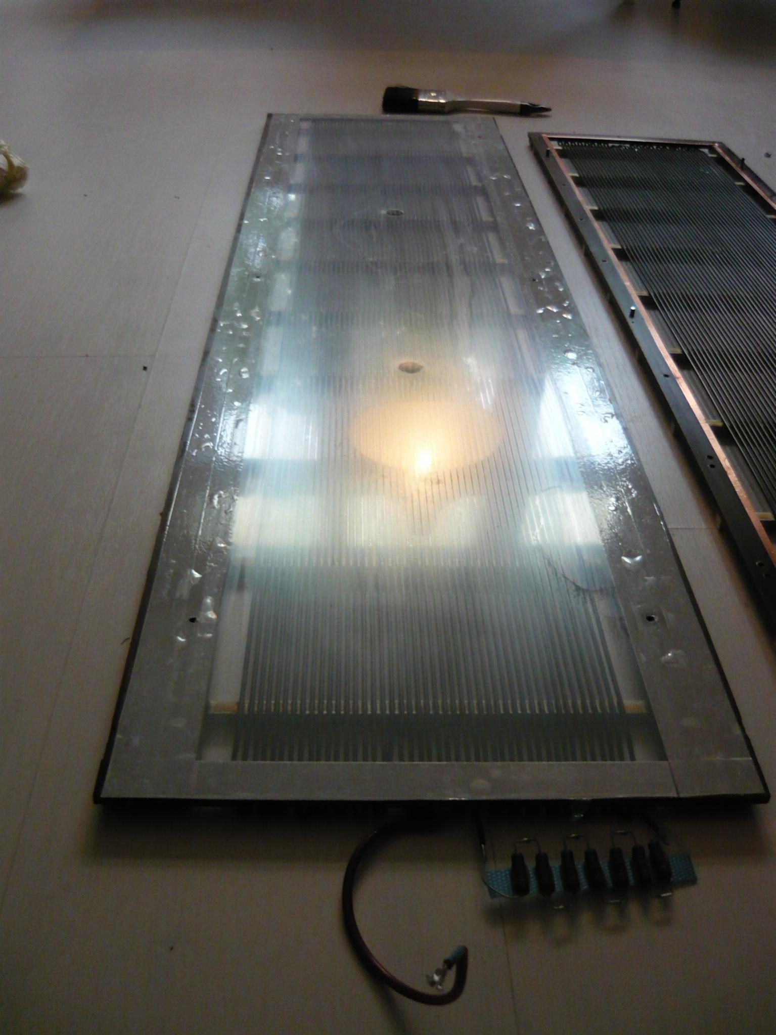

ok rebuilding this set for almost a year now and ive really had it.
problem is efficiency drops after turning on, first 1 minute or something great efficiency then drops and have to increase amplifer until i drive them in saturation. wich sounds like distortion.
ok tried diferent coatings..
- PVA glue, worked sometimes depends on the day strange thing is on rainy days my efficiency dropped extreme. normal listening level saturation. total crap.
- Licron crystal diluted Measured above 3 Gigaohm. worked not that wel and is not crystal clear but ok. increases a version wich had resistance in the Megaohms like 20. also same result startup sounds promissing then after 1 -10 minutes efficciency dropped with 6db or something.
- Antistatic spray 100 , called a guy who repaired these units he used antistatic 100, nice clear coating hope it will stick. he had it used for a year now with no losses or stats coming back so should be safe (for at least a year) ncie coat measured around 500Meg to 1,5 GigaOhm with the batery trick. so prommissing. to bad drops also after 5 minutes.
i looked at the trannies, measured primaries and secundairs from the 2 step up trafos and the autotrafo (mirror drive). all ok. also by passed the resistors of the HV suplly at the end, and the one on the split between the tranies. no diference so they are oke.
also measures all the diodes one way the blovk other way the let current pass, so they are ok as well i think. also drove the esls without the electronics infront of the trannies mirror drive and the adjusters for high and low. same result low efficiency,so no faults there. only thin i did not check are capacitators. but can they be responsible ? on both stats ? and also sometimes they do play like they should (like with the glue) but next day they suck again.

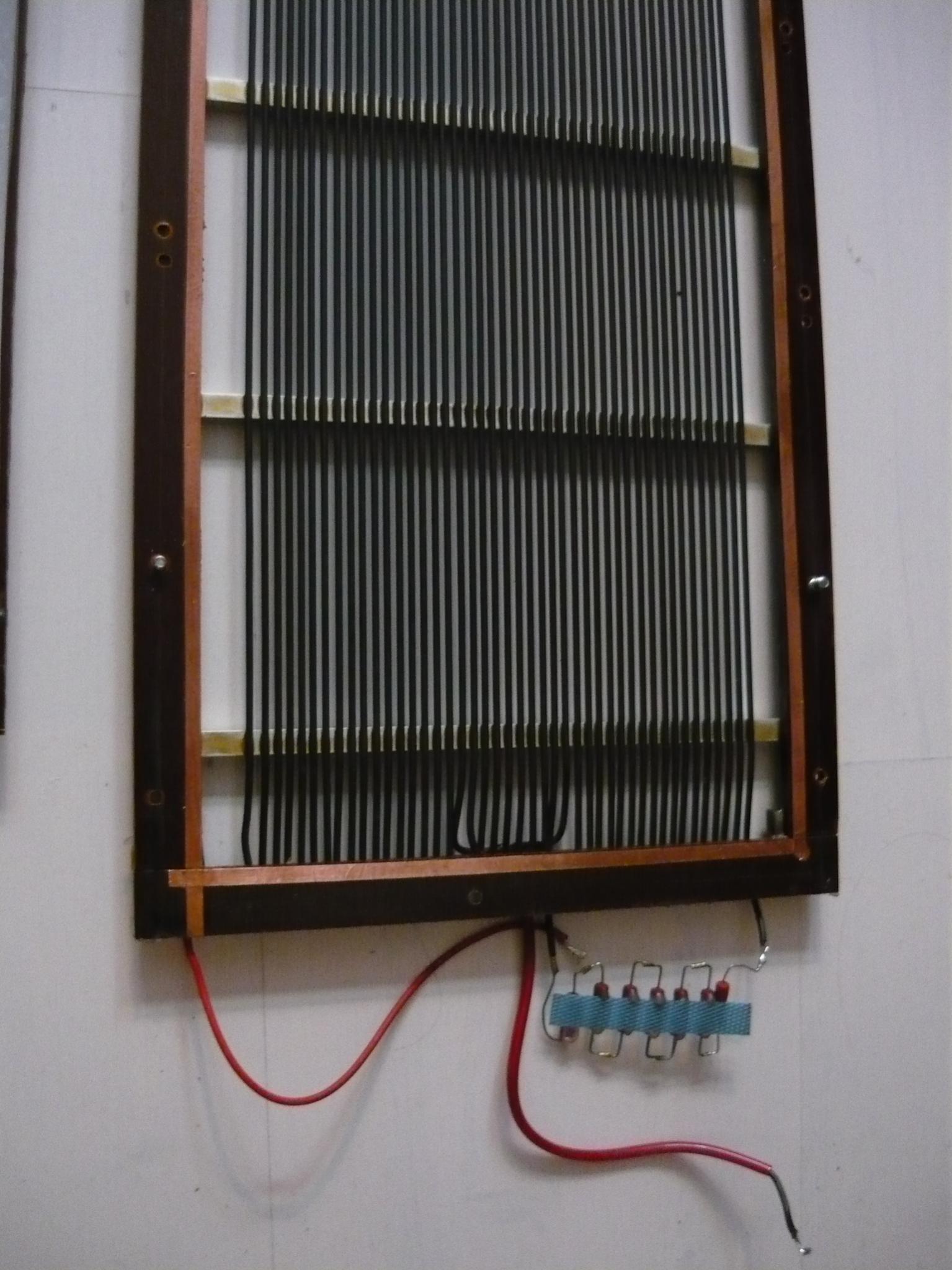

Ok for the HV i got a ring of copper all around the stator. further i got the stators bolted together with metal bolts and nuts.
THe menbrane is not stuck to the stator, because of the silicone dots. cleaned the inside of the stator with the hv strip with alcohol.
i got a blinker between the HV strip and the HV suplly it blinks 2 times a second pretty constand rate.

You say the diaphragm is not stuck to the stators but from the symptoms it looks like it is. Can you visually confirm that it is not stuck? 100% sure?

its really not stucked 🙂, the kit shrinks a little when it dries that why it lookes like a hole and the coating here whas the licron coating hell to bring it on without those stripes, just plain ugly. the one with antistatic looks much better. my blinker capacitor is 47nF. i coated till the charge ring. taped the rest when coating whas apllied. im still wondering how grease and smoke may influance the pertinax frame in terms of conductivity. tried measureing the frame with the 9 volt block trick and measured around 30Giga Ohm, now i know this is not really a precise measurement and we know that the pertinax does conduct a little when the weather is right (humidity high) im washing the stators right now under the shower, no soap used because it conducts as well and that would screw everything up. just plain hot water. and a brush. keep you guys informed.
well i got a new blink video of the washed stators(also aplied coating again because it washed away resistance)
the washed stators have a les rapid blinking as seen in the video, i counted them and aprox
3.5 blinks pers second for the non washed
and 1.3 per second for the washed stators.
http://j.peelen.myahk.nl/blink2.MOV
but time will tell because it always goes wrong after some time. the washed one is playiing louder MUCH louder then the one that is not washed and pluged in since i started the thread. so if the washed one still wins with a huge diferents tomorow. im gone wash the rest 🙂
by the way anybdy has an idea of some kind of stuff i can use to clean theme better then only water ? something that does not leave residue

Lots of distilled water for a final rinse would be my best guess.. Any possibility you can dehumidify the space the speakers are installed in?
If there are a lot of airborne contaminants in your environment perhaps covering them when not in use with large plastic bags might help?

sounds to me like you have a leakage path... I am worried about the metal screws... what happens when you touch them? Get a shock? check 'em with a VTVM , one side to ground...
I would invest in a HV probe, for your VTVM (safer than a DVM, cause it won't blow up if something does go wrong) or DVM given that you have beat urself up for a year trying this... that way you can check the HV... VTVMs are almost free on ebay these days...

I agree with bear that the metal screws look like a leak path. I would cover the area around the holes just to make sure that the coating isn't too close to them.

sounds very much like excessive leakage. As Wachara wrote one blink every 30secs or less is a good value (20Meg resistor, 47nF-100nF Cap and 94Volt ignition voltage of the lamp). A blink each second or even faster is definitely a sign for a lot of leakage.
If You build the thingie with bare hands a unvisible sweaty fingerprint can spoil all effort.
I wouldn´t use metal bolts for fixing. If any bolts are needed try nylon bolts.
One shouldn´t regard the diaphragm as an true insulator. It´s just the same as a coating, just with a higher resistance/longer time-constant.
If there were a material with similar mechanical properties and the right surface resistance values one needn´t any coating at all.
I found that cutting the diaphragm right along the rim of the stators often results in leakage paths. When the diaphragm was cut on the surface of the spacers, a few mm to the ´inside´ leakage typically appeared more seldom.

Thx calvin. i tried it without the bolts just by pressing, no diferents in blinking time so the bolts should be safe (also did not coat around the bolts) further more i did make some progress.
i washed my panels now with amonia diluted with water and a broom. well gues what the bucket about 5 liters whas almost brown when completed only one stator. after that i used the shower to get rid of the amonia dirty water. then dried everything.
also thought if this dirst is causing leakage on the panel it sure as hell will cause some problems on the PCB where the cascade is and the connections to he tranfsoferms. sou i cleaned them with some alcohol, phoo loads of dirty crap came off. and for the first time i power them up , right away perfect balance, so both sound the same as in volume.
can play really loud to, there remains only one problem! with bass at high volume i still have the membraan flaping to stator sometimes.
this could either be i drive them to loud. its also the point where the tranfromers almost hit saturation in the high tones so this could be just the max. or i need more dots of silicone wich can screw up my Fs. already asked many people about how many dots there shou;d be, but it looks everybody has diferent values. as i remember my speaker had 2 dots at 4th bar from up and 4th from down. can someone tell me if this is correct? MJ has every bar a dot, but uses 3 micro foil so maybe thats the diference.

yeah and this is what whas the problem the whole year around. took me total of i think near 100 hours of frustration. to find out 🙂 me next project will be less work 🙂

I would try placing dots per ES100 at every brace. It will not raise the resonant frequency very much but will greatly improve the slap problem.
hmmm maybe ill try it then. hope its the last thing i do 🙂 ever to this set 🙂 or end up replacing membrane again hehe
dont have major leakage and efficiency problems anymore so thats a PLus!
